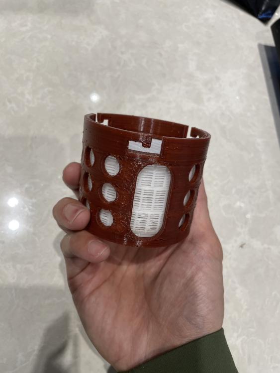

More progress on some custom 3D printed baskets. These are half baskets and the dividers can be customized however I'd like. Seems like the 3D printer is more than capable of making a nice mesh. These baskets are for medium-large size parts so the side hole sizes don't matter that much.
That printer mesh on your new basket does look great! I'd like to see how you modeled & sliced that. Great job.

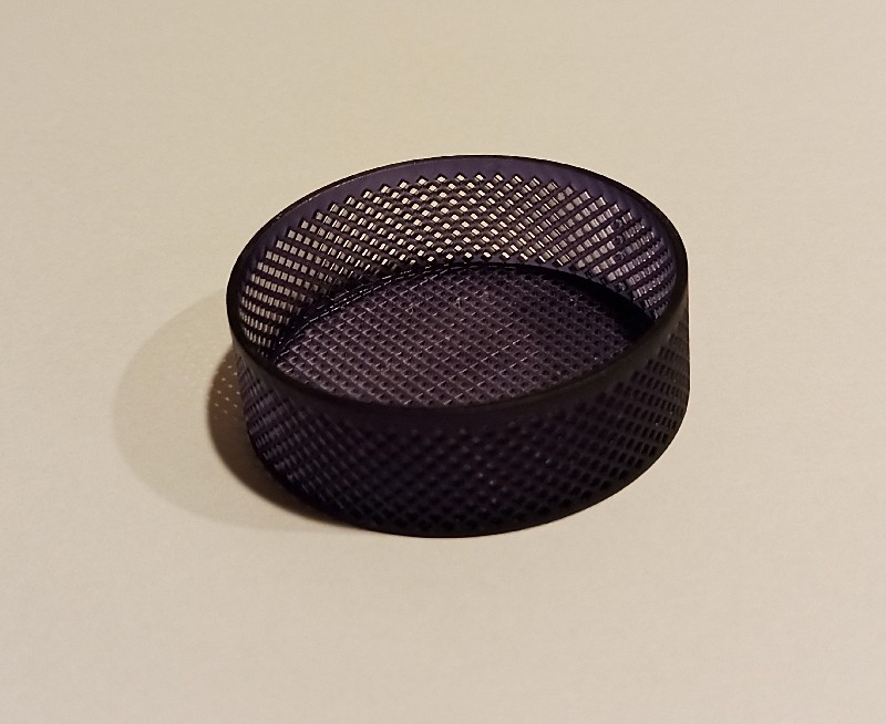

I need to try some resin in some cleaning fluids and see how it stands up to it. If that would work, some fine mesh baskets & stuff might be possible.

I might have figured it out??... (how to slice for a mesh thing)
Height range modifier (make a low layer with different parameters), rectilinear infill, 0 top and bottom solid layers, play with infill percentage for mesh size.
Is that about right?

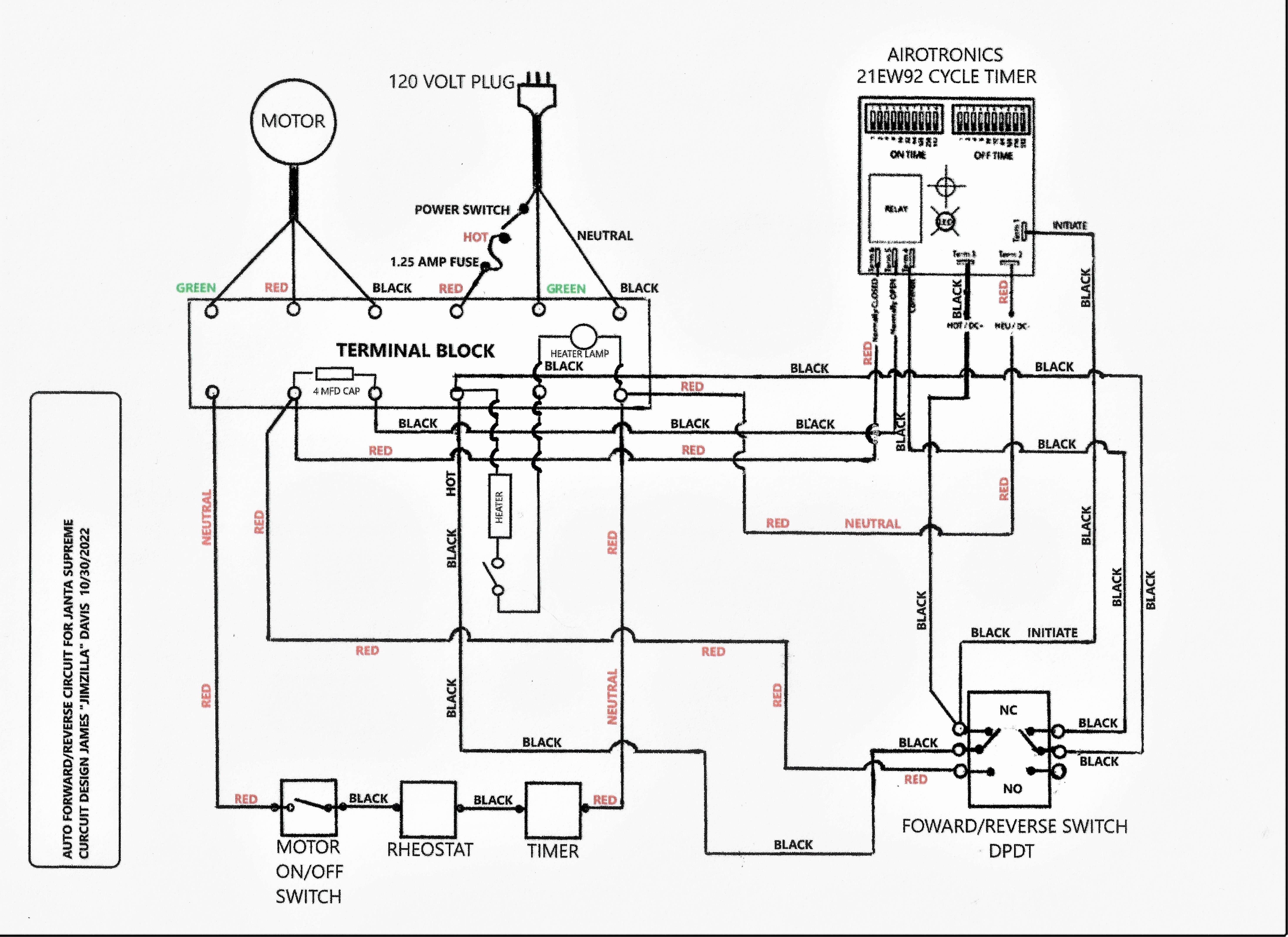

Very cool for a new design cleaning machine. I could not imagine trying to retrofit all that into the Janta.
I had loads of fun retrofitting in the cycle timer circuit, there isn't a lot of extra room anywhere.
Yeah, pretty clever what you did there. I don't know exactly what you did, but I could hear a clicking (relay?) which certainly gives it a kind of Rube Goldberg character to it that you get to experience every time you use it. That's cool. Importantly, it appears to work very well and I am impressed.
The bulky part of what I did was the motor and power supply. I don't know what power/motor the Janta uses, but since the working machine has existing power & motor, if you could just insert a little micro and H-bridge driver board it could probably fit. But your solution is great too and doesn't require any programming and all that. Possibly more long-term reliable as well.

Yes this is exactly what I did.
So far from the chemical compatibility charts I've been looking at it seems like ABS, HIPS, or Nylon will hold up good enough to the common cleaning agents in most solutions. But there are always so many solutions everyone has to test against their own products.

Got my small parts baskets in today. So now I have all the crappy mesh baskets replaced. If anyone wants these designs let me know.
Just tested this in boiling water and it survived fine. You wash these off in IPA so it will take that at least. I'll test in some more chemicals in the next coming days.
This was just a generic test of a mesh basket in a resin printer, i.e. it's not made to fit anything or even function in a cleaner or anything. Just testing so far. If I find out something works, I could draw up some baskets if I had the needed dimensions to fit the Janta/Pearl machine if anybody wants some.

Yes, the fine mesh baskets are nice for holding smaller parts and screws. Although the 3D printed mesh can get tight enough for it, it is very nice to be able to just remove a basket full of parts and dump them into a tray slot. Your resin baskets look really good.
Some more testing and progress. I've typically aligned the top of the basket with the top of the heating chamber and ran it for about 5 minutes or less. Never had any issues running the ABS plastic that way. I tried pushing it deep into the heating chamber. This time it melted pretty good. I took some more measurements, and it looks like it can get to 100C in there.
So conclusions:
1) If using ABS don't put it deep into the chamber. It's plenty warm enough to evaporate any IPA even if it's not all the way in.
2) Ideal is to print with even higher temp materials. That's what the photo is. The black basket on the right is printed from Nylon w/carbon fiber. Should be able to withstand 160c. Also made the basket a bit shorter since I'm using 1/2 baskets now.

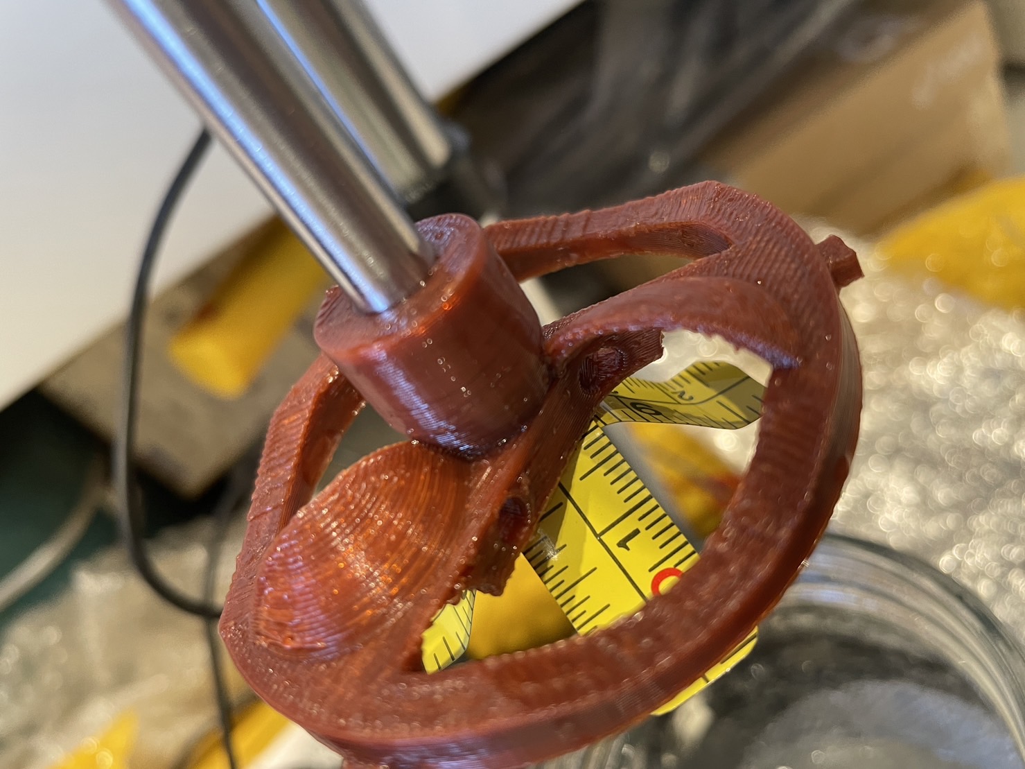

Hi @muddttI really love how creative you are for the basket, I am about to print the whole thing to adopt to my homemade watch cleaning machine, so far it has wobble issue.
I wonder what's the difference between your old basket(holes) and new one (vertical square)?
Could you please kindly share the inner basket please?
https://www.printables.com/model/301422-rotor-for-pearl-watch-cleaning-machine
https://www.printables.com/model/301419-pearl-supreme-watch-cleaning-basket/files
All the files should be in those 2 links. The basket with the Tear drop holes is the same height as the original one that came with the machine. The one with the rectangles is a tiny bit shorter because I used half baskets so I didn't need the full height.

thank you so much for sharing! Just printed the rotor 🙂 will test it on my machine these days, will update here.
@jimzzillaI really appreciate your sharing on the wiring diagram 🙂, the  21E92 Cycle Timer is not avaliable in my country so I managed to find a alternative module that also featured with cycle timer, will share mine once I set it all up.

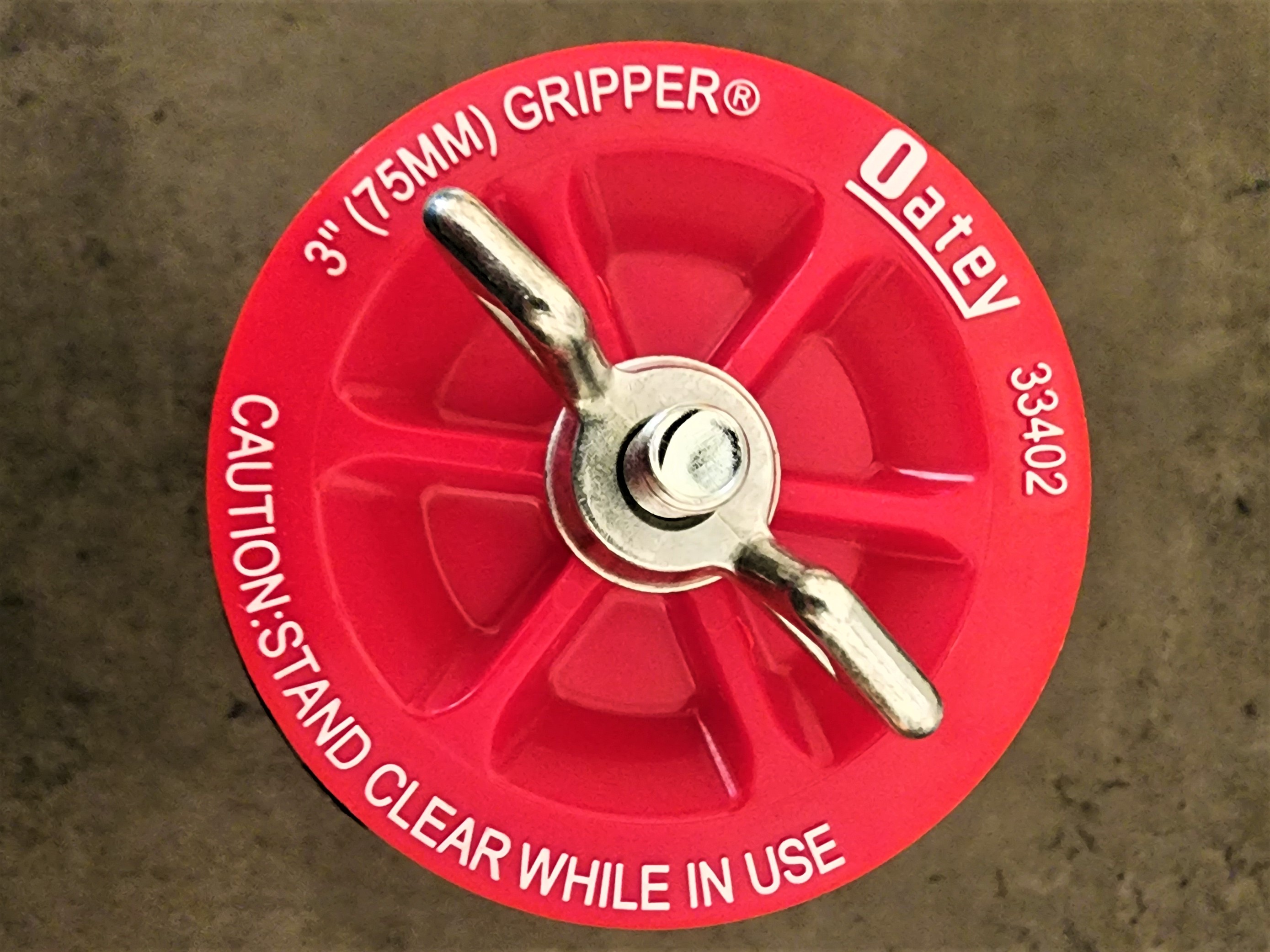

By the way, I am curious why your jar lip looks like that? did you make some modification as well? 😛
Those cycle timers are available in the same configuration by many different manufactures. They are fairly common for use in machine automation and prototyping.
To your second question, are you talking about the plumbers test cap for 3" Pipe? the Janta jar lids do not seal completely,      the gaskets are horrible so to prevent evaporation and odors I fitted a plumbers test cap to seal the jars and not use the Janta lids. Just insert the test cap and tighten the wing nut until sealed.  Price is about $8.00 US  for 1 test cap.

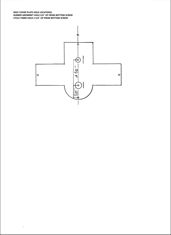

Here are a couple more pic's to maybe help.
The first one is a factory detail of the cycle timer
and the second one is a template to mount the timer on to the back of the Janta.
The 5/8" hole at the bottom is where the wires get fed through
make sure to add a grommet.
