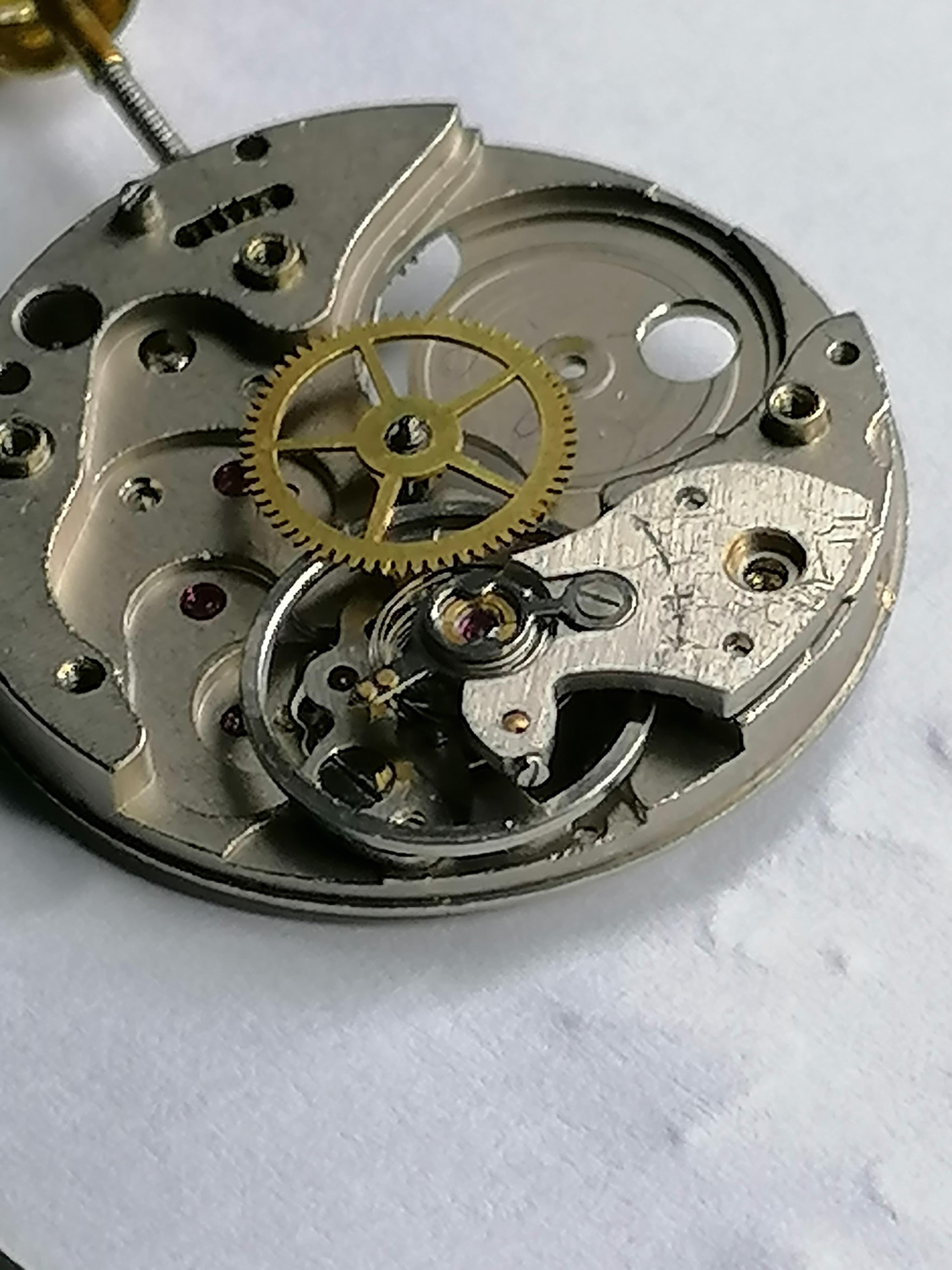

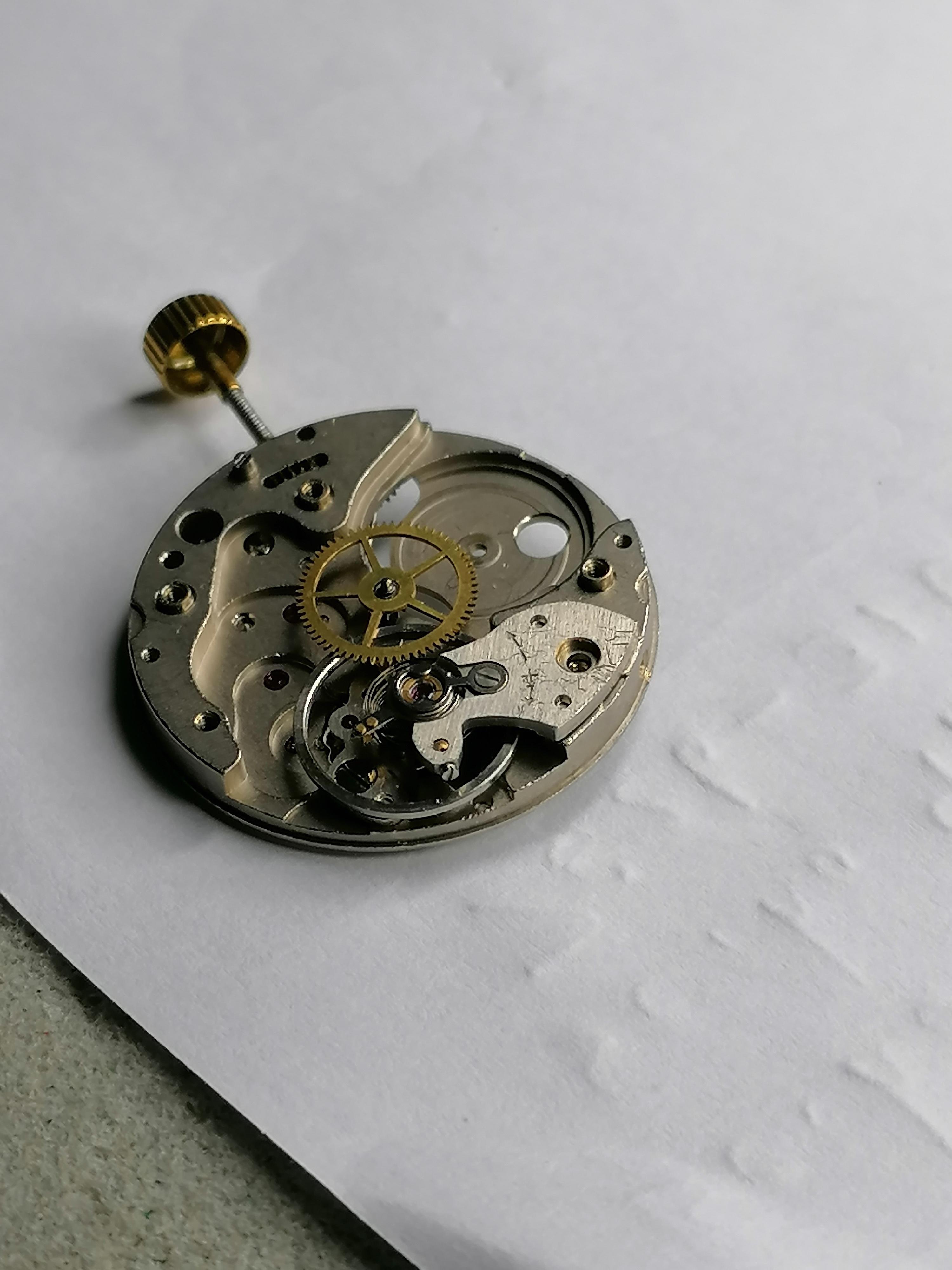

Hi bernie,
ORIS generally signs on the barrel bridge. Bentima, Novoris and Vertus , shared some parts and movements with ORIS, your watch can be any of brands mentioned.
Bridge layout might help as well.

will have a rummage. thanks Nucejoe.
    • Yep…This makes perfect sense. With that large a gap in the serial numbers, they were almost certainly machined on different equipment, hence one should have no expectation of any cross-batch compatibility. I’ll revert to the original bridge. Regarding bending the bridge @nevenbekriev, I’ll give it a try, but I may have to buy some better calipers. My Vernier calipers are only accurate to 0.1mm. Not very accurate.
    • Yes, what I wanted to say is that the cock is part of the main plate, manufactured together with it and not meant to be interchangeable. Even if the other cock gets in place, it is not sure that the balance then will stay upright. You should use the original cock when it exists and is not destroyed. The adjustment needed by bending it is not irreversible. It is minimal deforming that is needed. No tools are needed. I have pointed to all needed references here for the balance staff endshake checking and correctness confirmation. The only tool needed for the correction is You thumb. The cock must be fixed on the main plate, no need of special plate with holes and so on. If You will feel more confident, then measure with Vernier caliper the height of the top of the cock where the stones are against the main plate bottom when the shim is fitted and try to reach the same height when bending the cock (with no balance in place!!!) Caliper with screw for fixing is perfect.
