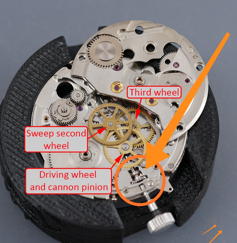

Due to a split second of distraction, have lost a cannon pinion and a couple of screws in the midst of dismantling the watch. I would like to purchase the donor parts and put it back together. It appears to be a standard chronograph, and I would appreciate it if someone can tell me where I can buy a replacement and how to determine the size of the cannon pinion. I am a newbie in this field. 🙂
(I think this is the name of the donor part or is it perhaps the winding pinion? Anyhow, is simply recovering one piece to complete it again)

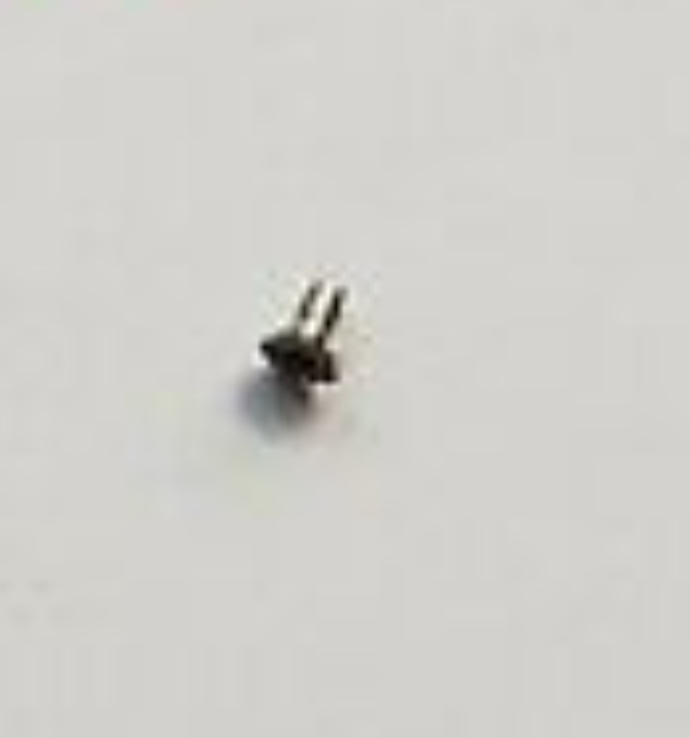

This is the piece I recall losing, now the question is if it is indeed the cannon pinion (as it is usually joined by a wheel) or the winding pinion. Quite confused to be honest, didn't get a chance to see where it was positioned as it sprang out in a split second and disappeared.

That is a cheap Chinese movement, parts are not available. They are a poor choice for beginners because of poor quality (with few exceptions) they break easily and cannot be repaired. See however if you can identify the complete mov.t on Cousins UK or AliExpress.

I am beginning to think that perhaps I described the wrong component (as they both do look somewhat similar), it's possible that it is the one marked below. A winding pinion maybe? Does it come in an universal size at all? Just asking in case.
That has been answered above already:
No parts (except maybe the stem)  for Chinese watches are available or "universal".

Can you please tell me if this component is named as a winding pinion? Just for knowledge purposes.

Jmd,
Just to add, this looks identical to the one I am dealing with which supports on what you said about the make.
