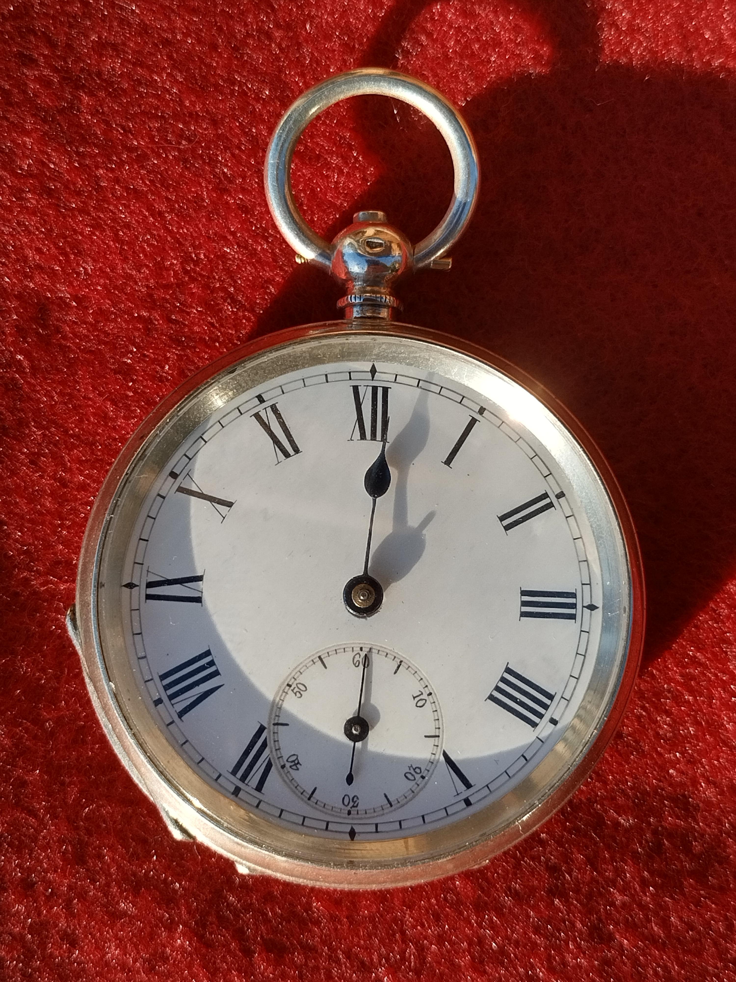

Update:
The watch is put together however the performance is just acceptable not satisfactory, almost the same when the balance pivots were not polished and the jewels were not replaced and it is because the upper balance pivot has too much side shake. I would need to replace the tampon but I don't have one, cannot make one (watchmakers lathe en route but no knowledge with the lathe) and I don't know how to replace one yet. So mainspring replaced, new crystal glued in, lower cap jewel and balance jewel replaced, one jewel for third wheel replaced all cleaned and lubricated. The watch starts and does not stop. I don't have a minute hand and I cannot seem to find one for it. I tried to buy random pocket watch minute hands on eBay, but all of them were a bad fit and all of them were too big, now I have probably hundreds of them and none of them good, I could not even put a shorter or differently shaped one for temporarily. I need a 0.55mm diam 18mm long one. Additionally I managed to snap off the case screw head, so now I have an extra job to sort it out if I can. The maltese regulator cross was also missing when I took the watch apart:
