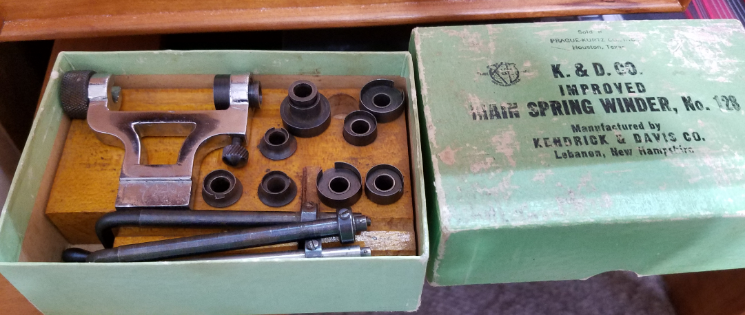

Here is the winder I used for this exercise.  My other winders were too small.  Always wondered why Dad had so many winders...now I know.  Had never used this one before today.

preferred way of inserting any of the T end mainsprings is to wind it into the winder. but leave a little bit out then you insert the winder with the little bit stuck out into the barrel rotate until the T part is over whatever it goes into. Then push it in and hold it in there with the end of the biggest screwdriver you have or the backside of the tweezers you have to hold it in place. Then you can push the spring out if you don't hold it in place it will almost always jump out and no you can't manually rotated and get it to magically go in place.
What John describes is textbook and proper. What happens with smaller calibers is proportionally you can't leave enough outside the winder to do it without distorting stuff.
On that size barrel I try to get the spring in so the T is a bit behind the slot, from the viewpoint of outside end of spring. Then, holding the barrel firmly to a bench block with a leather faced stick (leather buff, but a clean one), you can pull the end of the spring along with brass tweezers until the T drops in. Going the other way doesn't work,  you have to "pull it around ", not push back.

Yup this is almost exactly what I did.  I did not try to hold the T in place.  Just aligned it and then pushed the mainspring in.  Like I said...I think I got lucky.  Next time, I will add the screwdriver element into the solution.
