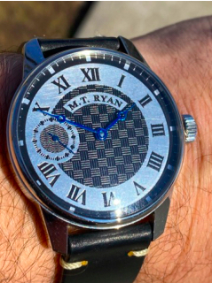

hi, thank you for letting me join this forum.  I have made some attempts at making watch dials and thought I would share.  I see many techniques in other sections of the forums, but I can't post there yet due to being new.
Mike
Hi, I uploaded a bunch of my "attempts" over the past few months.  Some worked, some are ready for the trash!
I have tried a lot of things, but what is working best so far is to:
  • Use waterslide decals to laser print the design and adhere to a pre-cut dial or even just a piece of sheet metal.  I am finding that brass and aluminum shined up really well are working best
  • I invert the design (black becomes white and vice-versa) and adhere to metal.  Then I use salt-water electro-etching to mark the design into the metal.  This can leave either a "raised" or "cut" affect on the metal.
  • If I want to try and have the markers/number have a very small amount of height, (like 0.2mm at best) so they stand-out, then I print the markers/numbers/second track in black and the white space is etched away.  I do the opposite if I want the numbers/markers to be etched into the dial.
  • Then I print another water slide decal, the inverse of the 1st one, and use that to fill-in what was etched away.
  • I use 2-4 layers of water slide decals and might even etch in stages to create "layers" in the dial as best I can...
  • Sometimes I etch, then white spray enamel and then put a darker decal on top, so the markers underneath the decal are white.  That's what I did for the black dial/white numbers in the pilot style watches below.
Like I said, some end up in the trash and a just a small few look OK.
