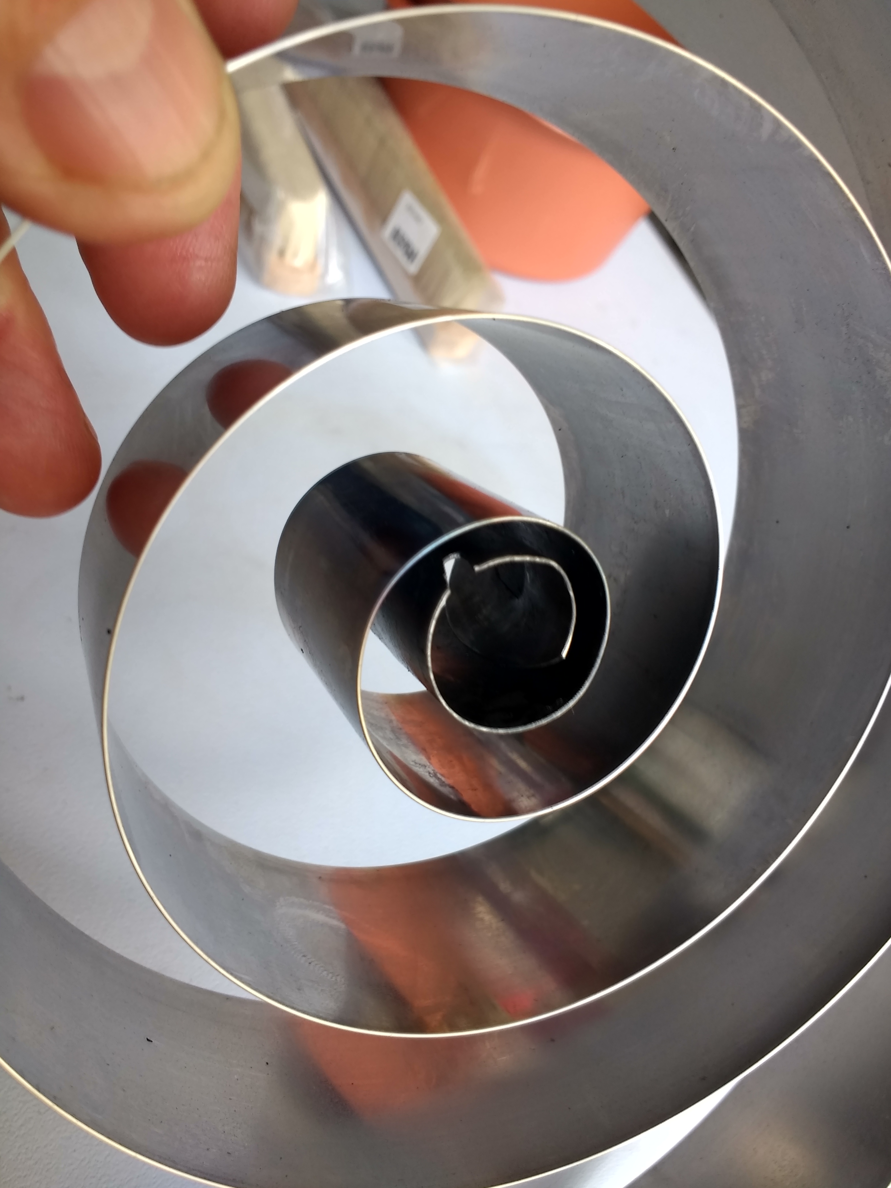

Well my new mainspring arrived today my question is can i put it halfway in the barrel take the wire off thats retaining it push it all the way in and then oil it or will it have to be completely unwound then cleaned and oiled
You will have to use your mainspring winder. If you try and do it your way the chances are it might not hook on. Just wipe it with a cloth first.
Well finally got time to work on my Tameside clock decided to put the new mainspring back in the barrel with Ollie Baker Winder, and i was having a problem getting it in the barrel with the retainer i used to take it out it was to big so ended up putting the next size down but that was to small i then had the problem with getting the arbor to catch so i thought what a good idea if i got smooth nose pliers to hook it on ?and i ended up snapping a bit of spring off?take it easy with me just wondering if it could be salvage or is it another new mainspring at £42 a go.What do they say about you learn from your mistakes.

Hi forgot to ask what can i do if the sleeves i have are to big or to small when i am trying to put the spring back into the barrel can you buy different sizes i have 9 that came with the winder but i don't seem to have the right one even though the sleeve i used i managed to take it out, so i am going to have the same problem getting it in the barrel. Will i have to take it to a clock repairer?
You may need to make another sleeve, see if you can get lucky and find some brass or steel tube that is the correct size to make another sleeve.

If only i could no room in my house and only have a small garden,so it's hoping i can get the right size or it will be off to the clock man or women repairer, just re-read your reply and i think i know what you mean i will have a look around and see if can find some steel thanks Tmuir
