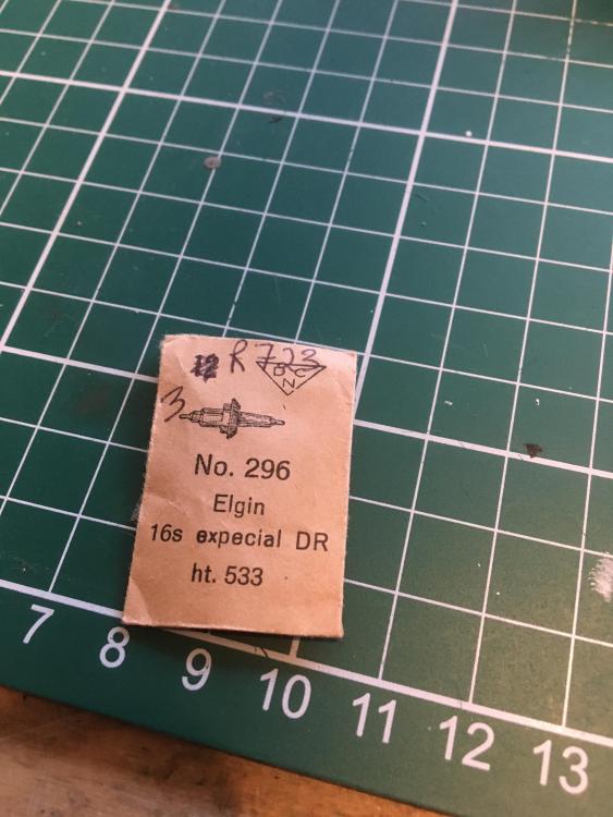

I found this in my stash is it what you need. I have checked the height and it is indeed 5.33
Hello clockboy  I as of now have not removed the balance for measurement as I am in the process of finishing another job. When I do the measurements I shall be in tough regarding the staff,  thank you for you time. will let you know.
Hello clockboy    removed the balance and the roller fell off so another job , after measuring the staff  The 5.33 looks correct the very tip of the staff has gone leaving a small portion still intact, the watch is in a dirty condition  but case wise cosmeticaly good.   PM me regarding the staff  thanks.
