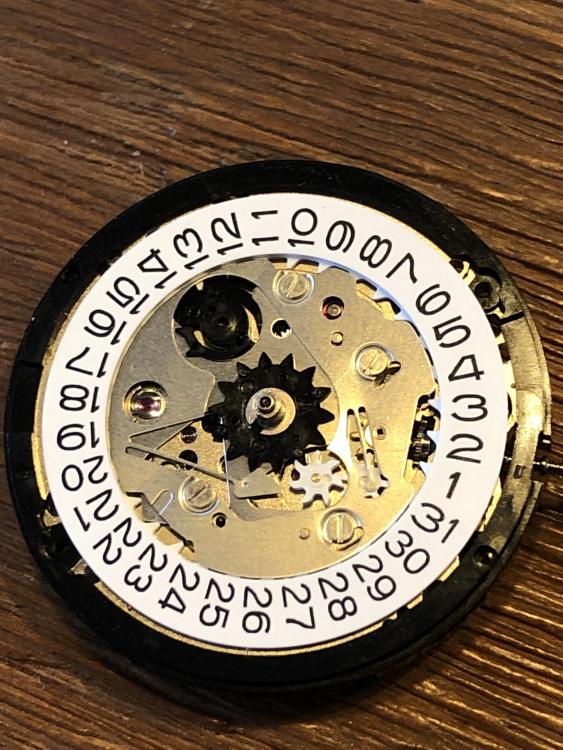

Day date 4R36
The o
7 minutes ago, watchweasol said:
Hi  If you have the caliber and make I will look for the tech sheet, sounds like there is a bind or jam. One wat to determine the problem is to remove the wheels untill it turns then re attach them and when it stops you will have the culprit.       cheers
The post heading suggests that it is a Seiko 4R36 (NH36). I'm wondering if the issue is because the attempted manual day change is too close to the midnight position of the movement? Try winding the movement forward a few (5 or 6) hours then trying the day change again.....

    • Here are the pics of the bridge. Looks correct, but as soon as I screw on the rotor, the watch stops. Video here: https://1drv.ms/v/s!ArG5E62RGctxjokY5ws85BzuJLVakA   Pics. Might have figured it out. I have been working on this watch for a while and since I got it as a non runner in a terrible shape, there was no guarantee that parts were proper. I think the main screw that was used on the rotor was too long, so it was stopping the main train. As soon as I fished out a much shorter and larger headed screw, things were good again. Please celebrate with me.
