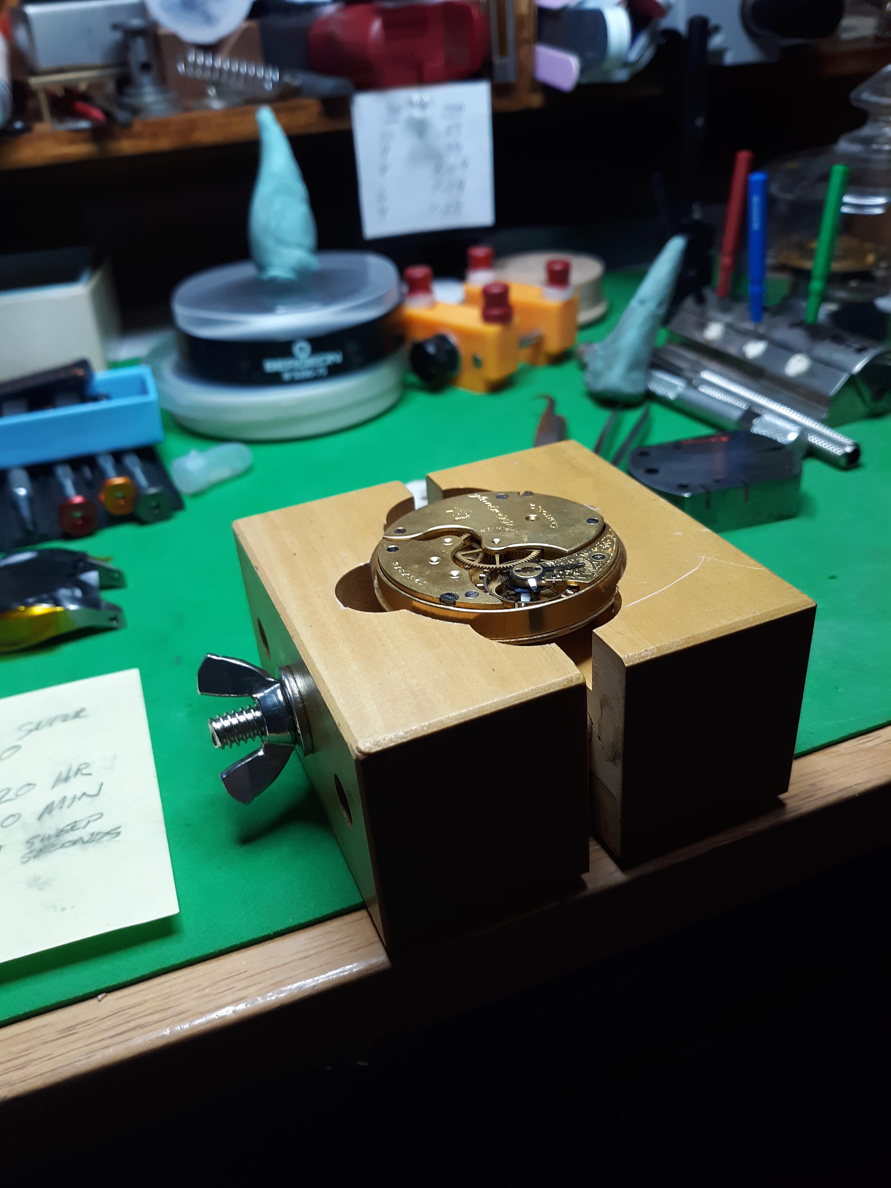

Anyone still use these? I modified mine a bit to hold pocketwatches but it's steady and works great. 5 bucks at Esslinger.

Yup I wondered if you would see this. You had mentioned on one of your vids you thought you might have one amongst your stuff. Its double-sided covering just about every size, ligne etc. I just took it a step further and milled out one side to accommodate PWs. No tipping, no wobble and no slippage or marks/scratches. You can chuck it up in a vise, or hold it by hand. Works great for casebacks and especially PWs. Adds a little flavor to my disaster area of a bench, too.

Ok, just purchased this one....what is the mod I need to do.

I did mine on a Bridgeport mill using 41mm shell mill cutter to your desired depth. I took it down to where a 16S pocketwatch sits dial up with the dial just above the block surface. You can use any diameter you want. If you don't have access to a mill or a shell cutter you can use a hole saw. Make sure you have the jaws open about a 1/4" or so, so the pocket won't be too big. If you use a hole saw make sure you have the block tight in a vise and you're steady and straight with the drill motor. It would be even better if you have a drill press.

So I can use my drill press to modify the cutouts?
Use a forestner bit in the drill press for clean sharp corners and clean flat bottom.
(also fun for drilling holes at angles) we used them for jack holes in the edge of bodies.

Do you hold the block of wood and move it carefully with your hands. I do want to keep my guitar fingers.

sure can. just remember, don't make the cutouts too big in diameter-otherwise when you go to close it, the pocket will be too big. that's why I left a gap in the block, and cut one side, then the other. to help with that, I traced the 16S diameter with a pencil on top of the block when I had it closed tight. some of the wood left I just tapped on with a small chisel and popped them out.

As Tudor said, use a clamp, or a vise, or clamp some sort of stop or rest, to wedge the block up against to prevent spinning.. Otherwise you run the risk of having the block catch a burr and spinning it out of control and probably taking a picking finger or two with it. Use caution. I learned that the hard way.
