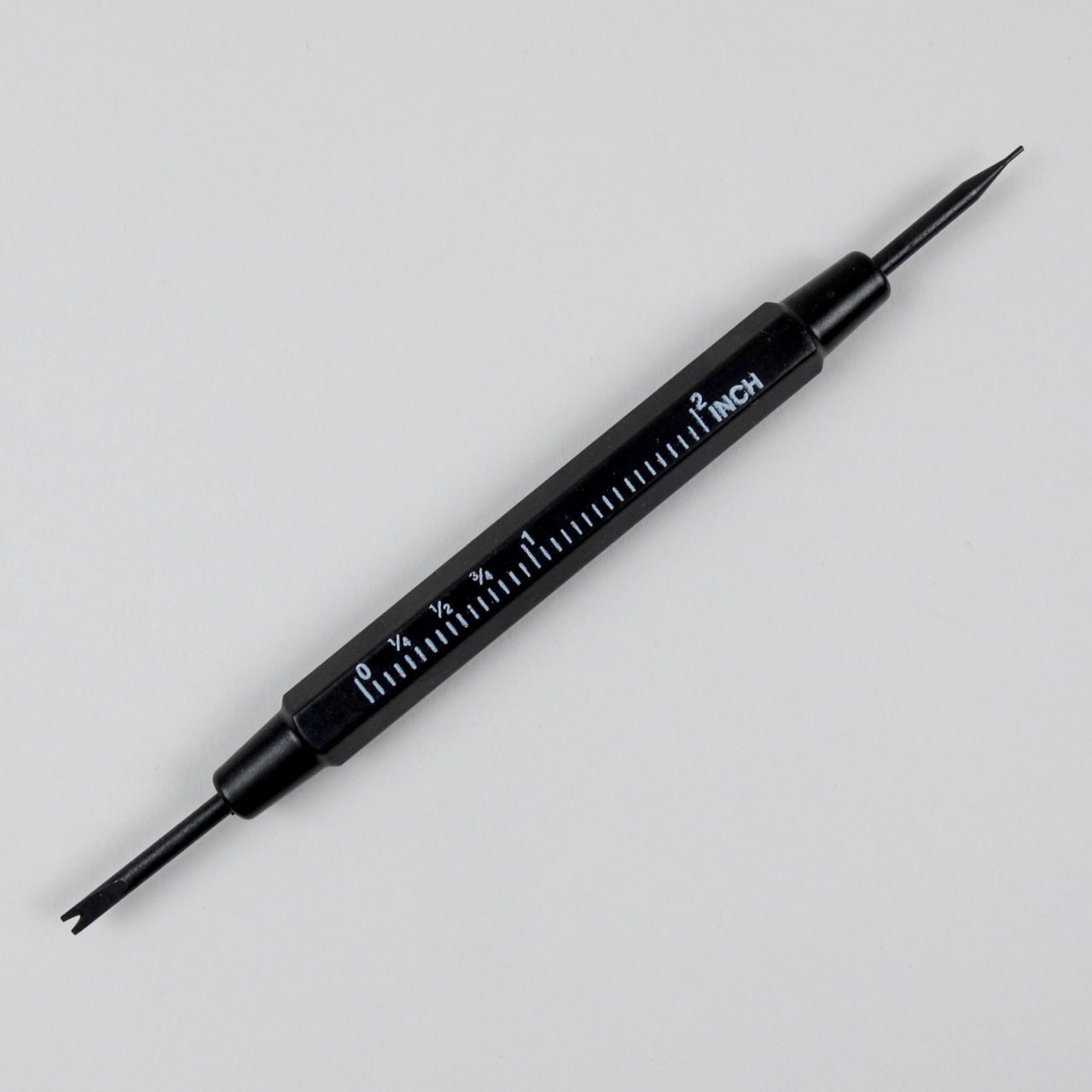

Whats the best way of getting the lugs and strap on to a watch before i end up with another trip to the hospital to get a piece removed from my eye.
cheers
gary
Hi Gary the tool Old Hippy posted is the usual tool, I have used the bench knife and screw drivers as well  If in danger wear protective gggles/glasses. There is a Bergeon tool like a pair of dividers with special end s for the job not a cheap option.  cousins have them in stock  the verbeon one is cheaper than I thought.
I would really like to think you are joking here? If not your definitely not doing something right.
Maybe a modification to a Idea that others have used for smaller parts? I often see the recommendation of using a clear bag on this group to keep things from flying away. Perhaps a larger bag will slow down flying projectiles from sending you to the hospital.
