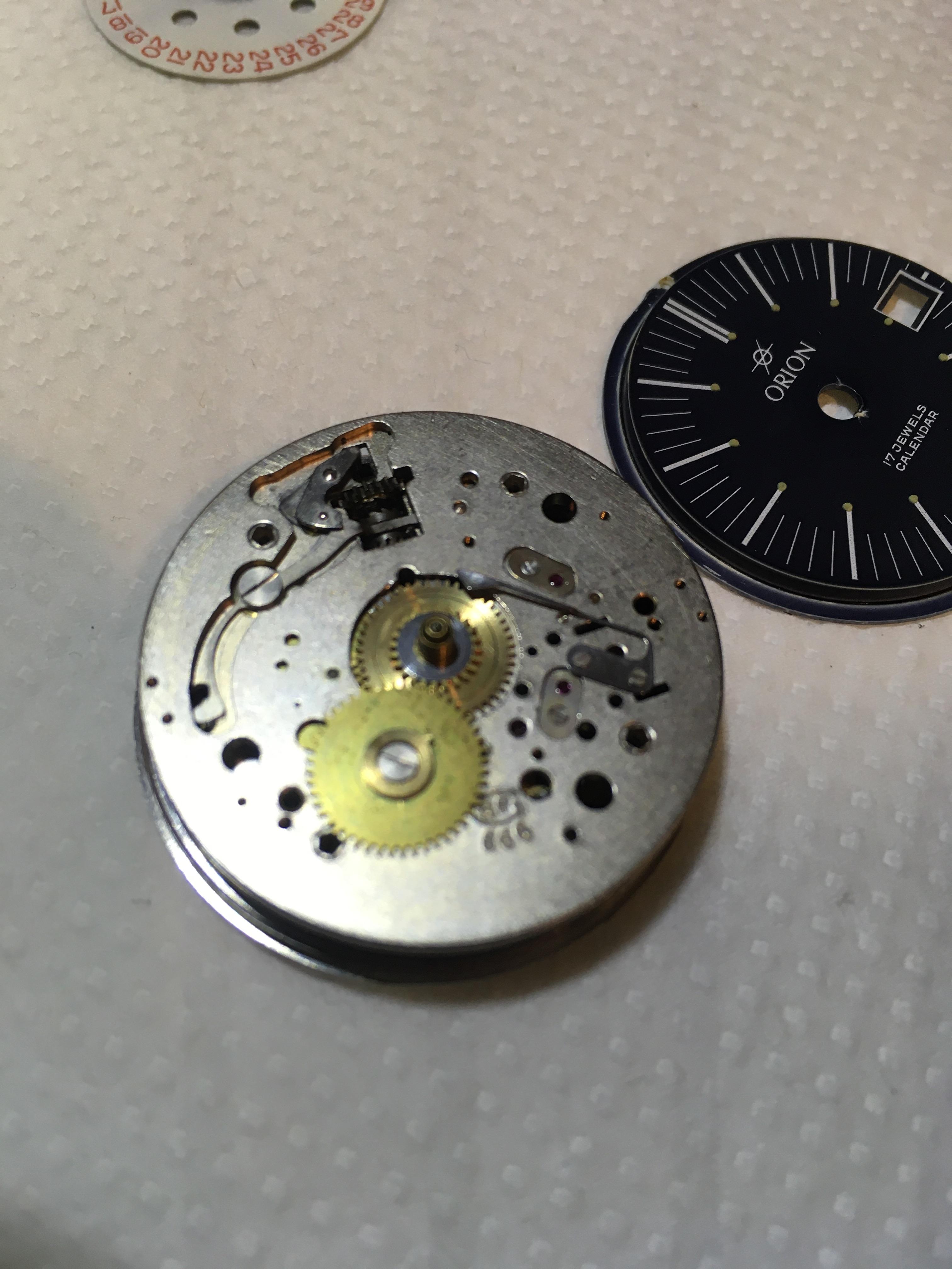

This watch was my Dads, he died whe I was 7 and this is pretty much the only thing I have of his but it’s not in great shape.  I’m pretty sure the movement is not financially viable. Although I’ve fixed the keyless works, it’s pretty worn and I think I the balance spring is goosed. I don’t imagine it’s a cheap job to have done professionally.
Anyway, I’d like to replace the movement and would like to know where to start.
the current one is a Basis 17 Jewel movement which I guess aren’t available?
 The dial is held to the movement by two screws on the front face (see pics) at just past the 12 and 6 o’clock positions. Is this an unusual way of securing the dial?
I’d love to re-use the case, hands and dial so it at least still looks like my late Fathers watch (no jokes about time keeping please!! Lol).
Can anyone offer me any advice as to how I identify a suitable movement?

That is a BFG866  - not too difficult to find, and I may even have a donor in my stash. I'd need to check.
http://www.ranfft.de/cgi-bin/bidfun-db.cgi?10&ranfft&&2uswk&Baumgartner_866
https://17jewels.info/movements/b/baumgartner/baumgartner-866/
Your version is the 17 Jewel Calendar version, but I think most parts are interchangeable between the different versions.
Cousins have some parts.
https://www.cousinsuk.com/category/filter/bfg-movement-parts
Cousins also have the service manual which will detail the differences between the different versions.
https://www.cousinsuk.com/PDF/categories/2529_BFG 866,866.31.7.pdf

Wind it up.soak it in naphtha. Let it dry and lightly  oil it. However dont soak the date wheel. Naphtha  and paint don't  get along well

Naptha will dissolve the old tired and tarry oils, and free up all of the gummed up parts.
Naptha == Lighter fluid. Unleaded petrol also works. Obviously these products are highly flammable, and probably not very good for your lungs or skin, so work in a well ventilated area, avoid smoking or juggling with fire, and wear gloves.
Lightly oil means VERY lightly oil.A tiny amount. Just enough to lubricate those tiny pinions and no more. Any excess has a nasty habit of migrating to places it shouldn't like the dial, the crystal, or worst of all, the hairspring.
At all costs, avoid getting any oil on the hairspring.
If you do accidentally manage to oil the hairspring, then all is not lost, we can advise how to recover from this issue, but avoid it if you can. Hairsprings are very delicate (obviously) and oil will cause the coils to stick together, either stopping the watch, or worse still, causing the hairspring to deform.
If you don't have a watch oiler, use a pin.
Flatten about 1/4mm of the point with a pair of pliers or mole grips to give you a tiny spade like end.
Watch oil can be picked up online, but is relatively expensive. Watch oilers can also be picked up online, and are relatively cheap.
DO NOT USE WD40. It is not a lubricant. It is a moisture repellent, originally designed to deal with the frozen condensation that forms on  the surface of rocket propellent tanks on the Atlas missile. It has many uses, but oiling the mechanism of watches and clocks is NOT one of them.  https://en.wikipedia.org/wiki/WD-40
If you have nothing suitable, and can't justify the high price of watch oil, then at a pinch, you will get away with sewing machine oil, or supermarket own brand scent free baby oil. This is not a recommendation, just an observation. Proper watch oil is recommended.
