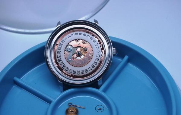

I  bought an old Benrus ref. 1345 from the bay, item arrived today. It has a solid case back that denotes also for the opening of the watch through the crystal. As you can see from the posted photo, I have already removed the acrylic crystal and the outer ring with the minute indices. But now, how do I proceed to remove the movement? Is there a specific way to remove the stem from the dial side?

It will more than likely be a two piece stem. You will have to grip the crown tightly and pull it out of the watch. Below is an example of a split stem.

Thank you guys all for the information! I have not removed the crown-stem yet, but I have found out that the dial was loose inside!
Do you see the little screw that I have put in a circle? This one popped out after removing the glass!! Yes it is the screw for the dial foot on the bottom of it.
Fortunately the dial feet were ok, and I discovered that the second screw for the upper foot of the dial is inside (loose though), I have circled it at the second photo:
On this second photo I have set the stem to the hands position, and I can see that the stem is as you have already mentioned a split type. When I push the crown fully in, I can barely see the end of the male portion of it. I am afraid to pull  strong enough, I tried several times with my fingers but no results. I tried to ease the stem, by dropping inside some  isopropanol in order to unclog the old oils-dirt but no luck at all!!!

Thanks anyway,  I have managed with a pair of pliers to remove it! At last!
