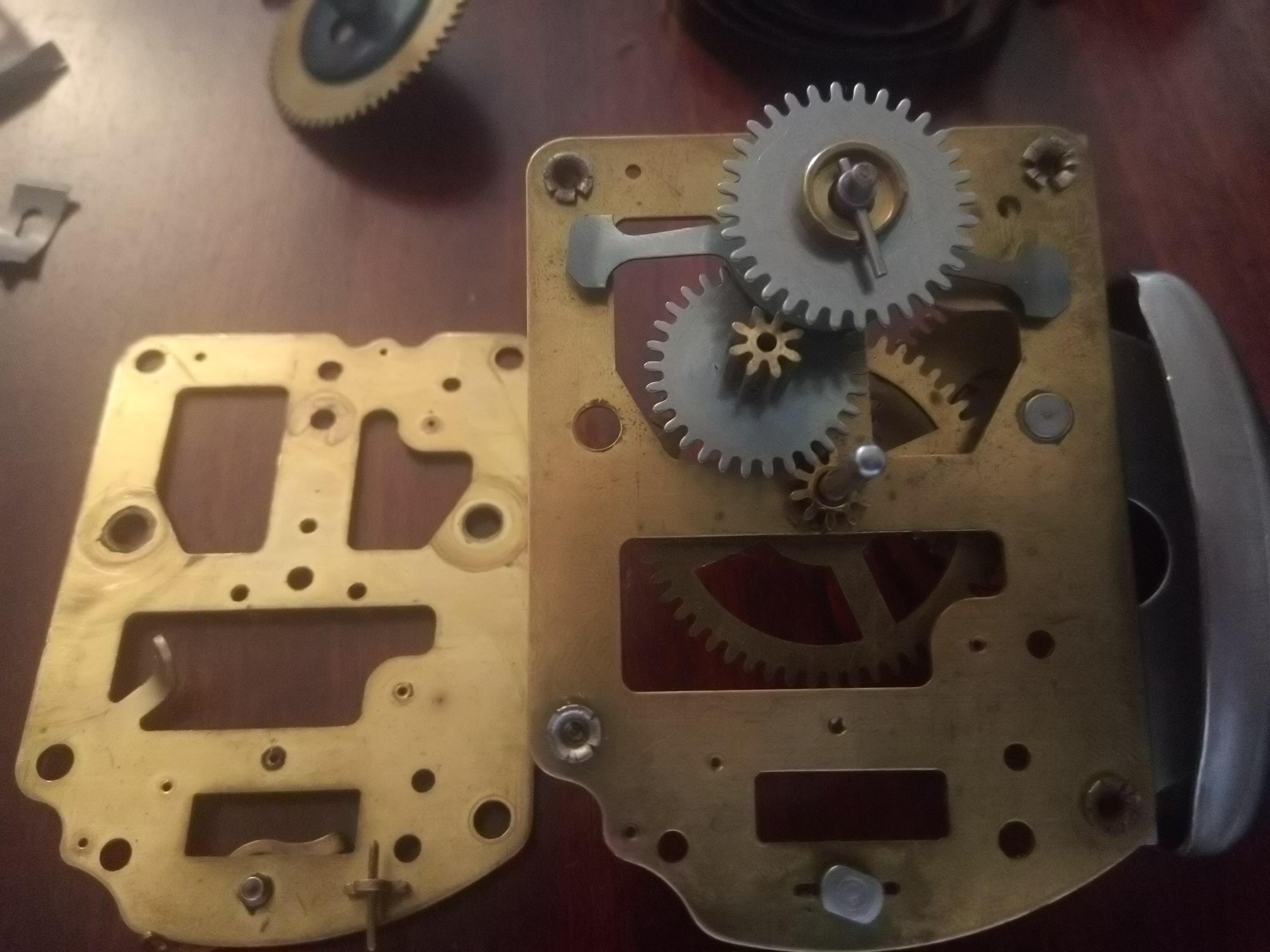

So in order to get the mainspring off, I'm trying to remove this wheel (see tiny Swiss knife in photo for reference) but is this correct? Other than trying to remove the pillar pins, I can't see where/what else I need to get off.
That pin is for the alarm. If you are going to take the movement apart you need to let the alarm down, make sure all the power is off before you take the movement to pieces. If you put a screwdriver under the loop of the spring that is around the pillar here (see red arrow) and pull the spring right out. You don't need to take the movement apart in order to replace a new spring.
That's fine have you made sure there is nothing of the mainspring left around the arbor. As this is your first time working on this type of movement, are you going to take it apart to clean it? If so take photos of it so you will be able to see how the parts fit. As most of the (train) that is what we call the wheels are out if I was you just wash it out in petrol using a stiff brush and dry it using a hair dryer. Don't forget you will need to obtain the parts.

Is there a method for removing 1/2 (see attached)
The pillar pins (2) look tricky to remove.
Does the old "dunk it in petrol" method apply for cleaning?
Providing no power is on just remove the plate from the nut side. Don't take apart anything that wont just lift out, You can clean the center wheel attached to the plate. Its a bugger to get free from the plate and a bugger to put back. No need to create unnecessary work.

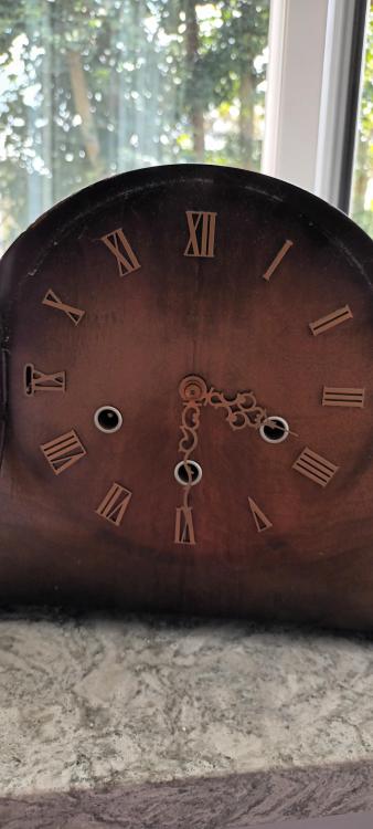

Can anyone please help me fix my great grandfathers clock for my mum 😞
No idea where to start!
It says K6A 544 Smiths English Clock

Smiths Westminster chime if you are after someone to service & repair it for you then google The British watch & clockmakers guild they have listings  for clockmakers in all areas.
