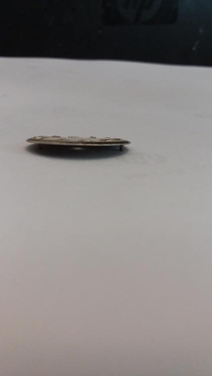

It looks like your movement  is an HB 115. I have one in a Landau watch with 17 jewels.it runs nicely.  When I get a chance,probably this weekend  I will pop it out of the case  and see what it fits. Is that  dial flat ?  Or dished?Can you show  me a picture of it in profile?
Thank you for the offers, Spectre6000 and Yankeedog. I will be posting better pics of the dial (it does happen to be slightly dished upward - the edges curve down - it had a high dome crystal) and more complete measurements and dimensions,...and this old-school analog human-being will figure out how to PM someone in this forum.  Can't be too hard.
I took a couple pictures to show the slight upward dish on the dial.
