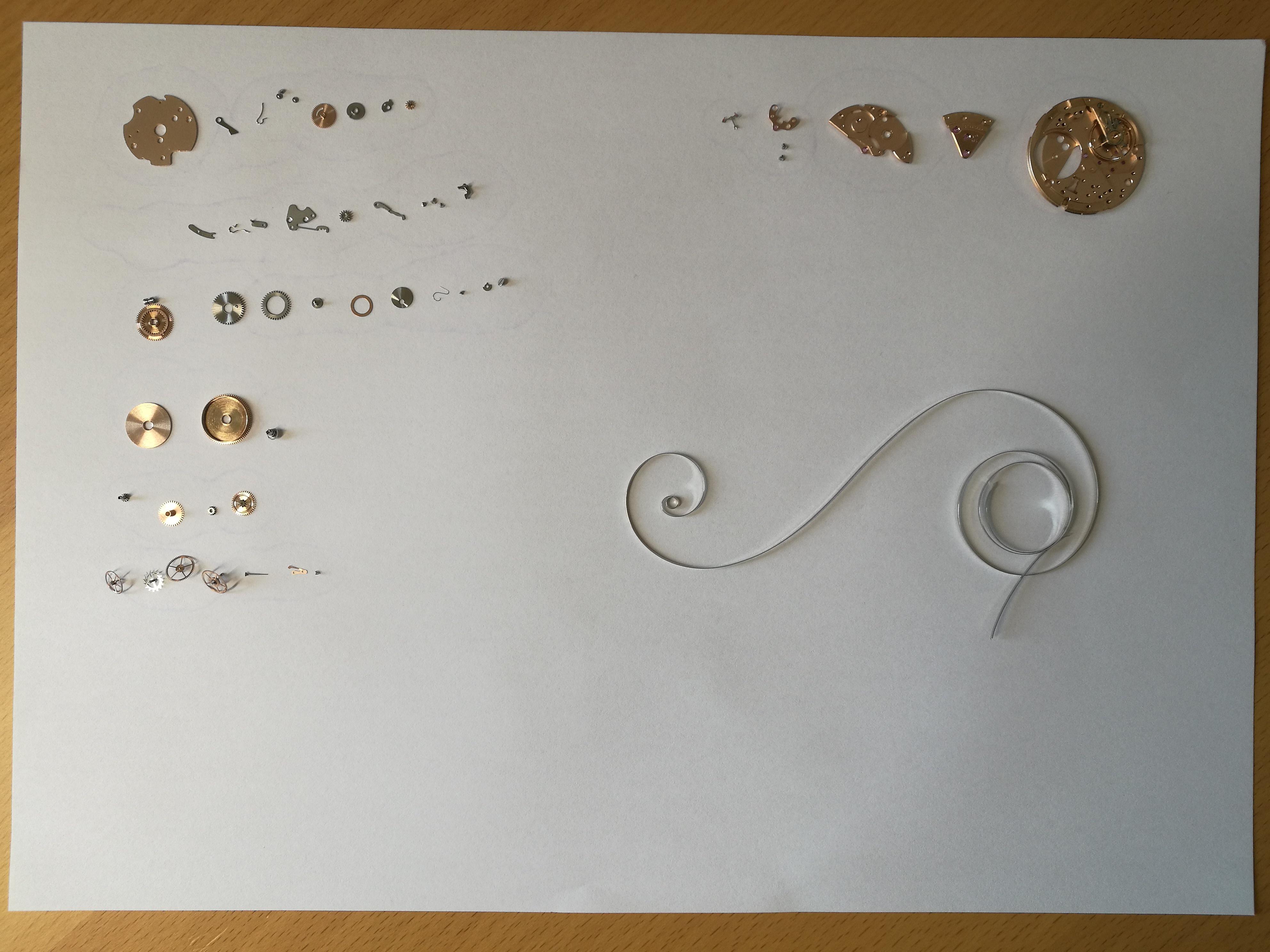

The movement was quite nasty, everything covered in small pieces of dirt and old oil. Stripping the movement down went quite smooth and I took photos of some parts to remember their location. I cleaned it in an ultrasonic cleaner with Elma Red and then rinsed it in distilled water and isopropanol. After all parts were dried I started to inspect them and I thought that they would all be fine, but that assumption turned out to be wrong later.
All parts cleaned and dried (with expeption of the automatic assambly)
When the movement was assambled again I was really happy to see it ticking again, but the joy only lasted for a short time, because it stopped after about a minute. I first inspected the balance again but it was moving freely so I assumed that the problem would be in the train of wheels, because the watch was running nice at first. When I checked the third wheel I noticed a small black dot between to teeth, barely visible even under magnification. I cleaned this spot and also all other wheels again and pegged out the pivot holes. After reassembly it was now running nicely.

Well done. That was a nice catch. During reassembly after first clean and lube, did you give the train of wheels a spin before adding the pallets?
Couldn't you find a new mainspring for this, as 240 amplitude is very low to be happy with?
I wanted to keep costs as low as possible, but I want to replace it in the next time :) maybe it will boost up the amplitude a bit
I find these movements can be a bit fussy and sometimes will "pick up" after running in a little.
