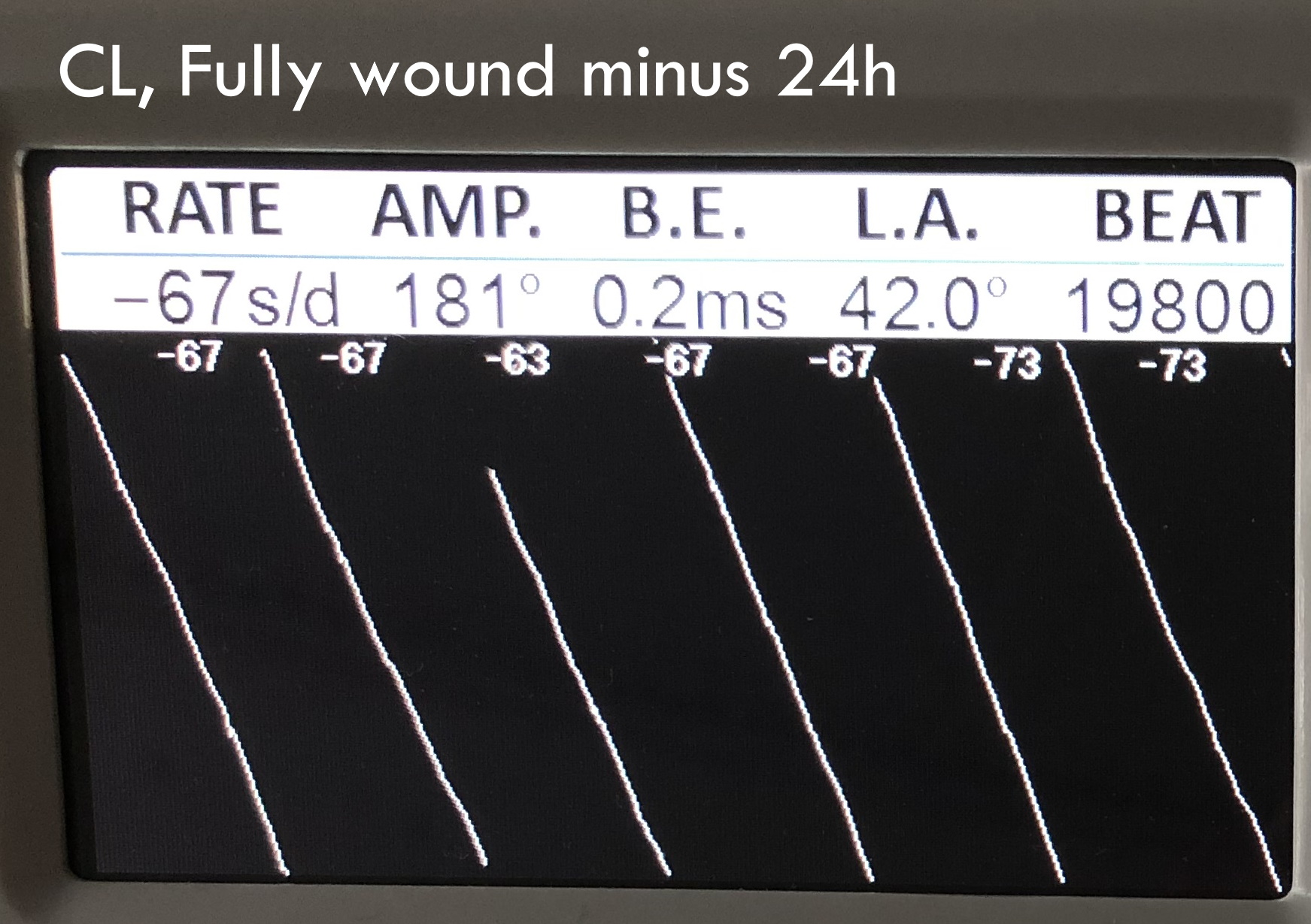

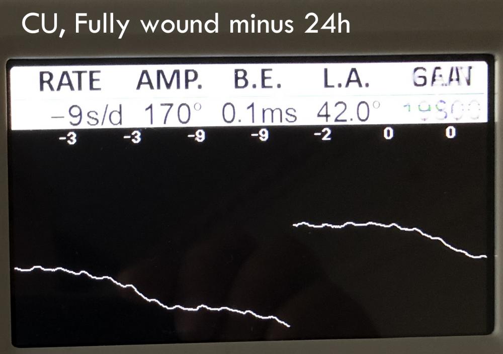

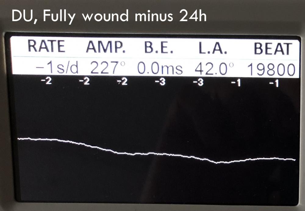

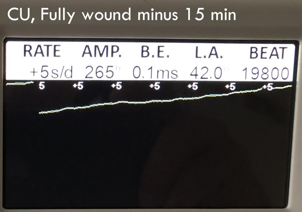

John, here are the graphical displays of those numbers I published yesterday:
The Weishi 1900 has two graphical display modes, A and B. For the "Fully wound minus 15 min" pictures I used mode A, and for the "Fully wound minus 24h" pictures I used mode B (longer period). Also, I haven't reduced the resolution of these pictures in case you want to get up close.
Perhaps I should mention that the power reserve for the Vostok 2415/16/31 is specified as "no less than 31 hours". Usually, I get out about 37 hours.

Also a question,   I don't see the advantage of extrapolatiing the rushed rate to 24 hrs. though I  guess because daily rate is a bench mark.
Well, simply to more easily expose how extreme it is. A 30-second gain may not sound much, but 1500 s/d really shows what's going on.

I need to analyze all the images but in the meantime if you're up to it another experiment? I don't suppose you have another running watch? Go for a walk take another watch see what happens. even another watch the same type would be arresting or you take several watches at the same time as long as you get them in the same place more or less.

I don't know if you noticed it or what impact it could have, but the Vostok 24xx calibres have a specified power reserve that is unusually low, just 31 hours. That means that after 24 hours almost 80 per cent of the power reserve has been depleted. Compare with, for example, a Unitas 6497/98 which has a 50-hour power reserve, so less than half the power reserve is depleted after 24 hours. Or compare it with the classic ETA 2824-2 which has a 40-hour power reserve, so only 60 per cent depleted after 24 hours. My guess is that this will have a significant impact on the timekeeping after 24 hours, no?
