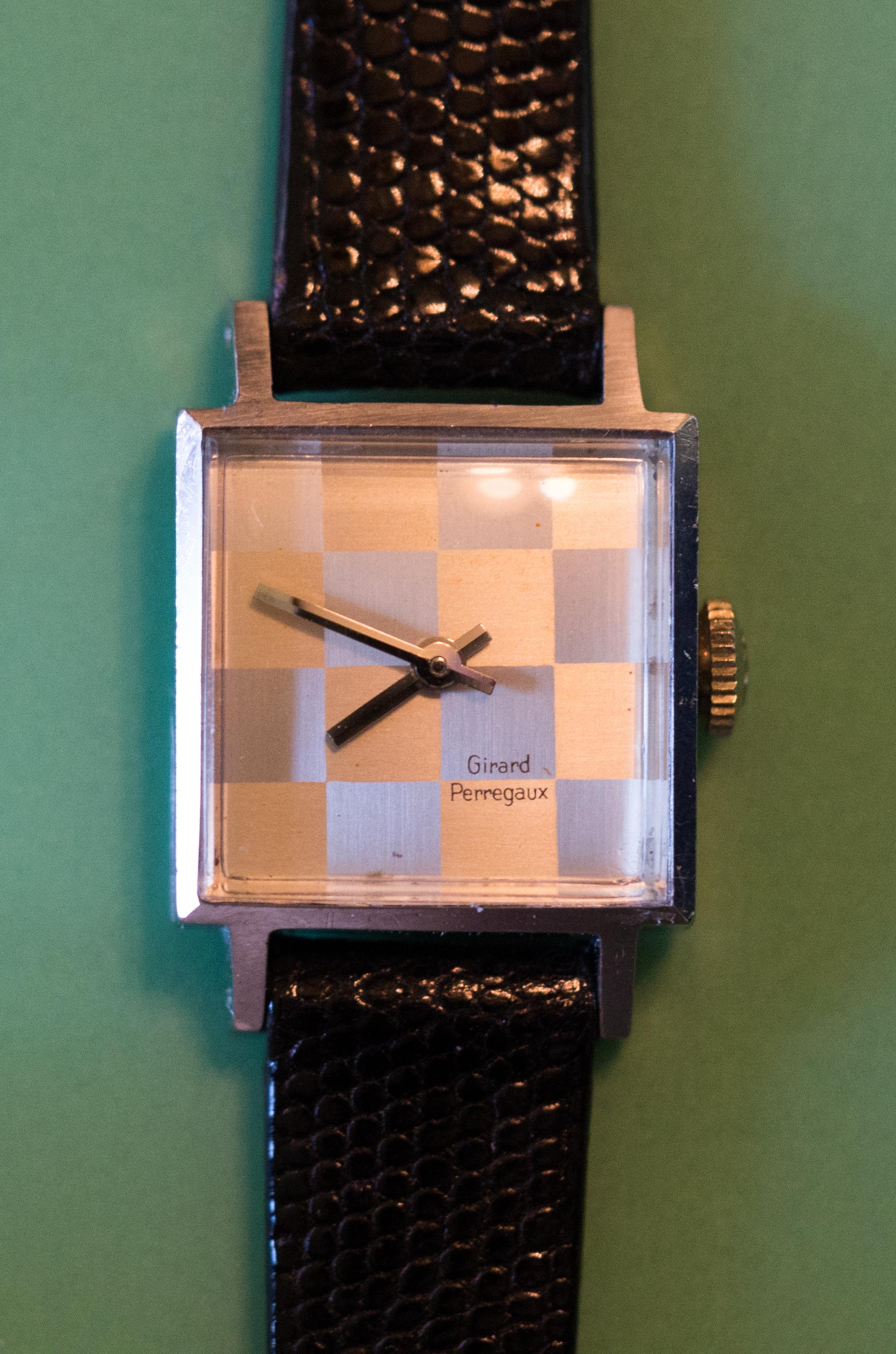

I have ordered some GS Hypo that I plan to use on the ladies Girard-Perregaux. Not sure if that crystal is original, but it's nice and will be great once it's re-glued.
Here's a pic of that one...
I think this is a great piece. It even came on a brand new unworn Girard-Perregaux lizard strap. It could use a service and a little adjusting - but running pretty well as-is.

Here is the Ladies GP "checkerboard" after re-cementing the crystal.
Also did a little clean up on the dial - cleaned the hands - polished the face of the crystal.
