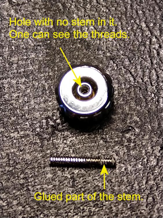

The next step will be to take a shot of the stem on the crown or if you could see inside of it, when the stems snapps there sometimes will be a short bit of the threads inside of it. If there still is a bit you could try to gently to remove it, otherwise you need to buy a new crown too.
Your in luck, now it is time to grabb the pliers. Turn the crown gently back and forth to see if it gets loose, if not the stem is glued and you need to apply some heat onto the stem stump, I usually use a welding gun but i asume you dont have any so if you just quickly warm the stem with a lighter it may do the trick. Never try to force it too much.
Since you got the stem out already I guess you figured that part by youself.
One can be sure there is no bit left in the mevement since the stem is a "snubbnose"..
So the risky part here is to get the stump out from the crown, otherwise you already done the hard part.. getting the stem out..

Unfortunately I think you managed to break it a bit more, one have to be very carefull, there still is a bit left to grab on.
The end result should look little like this..
