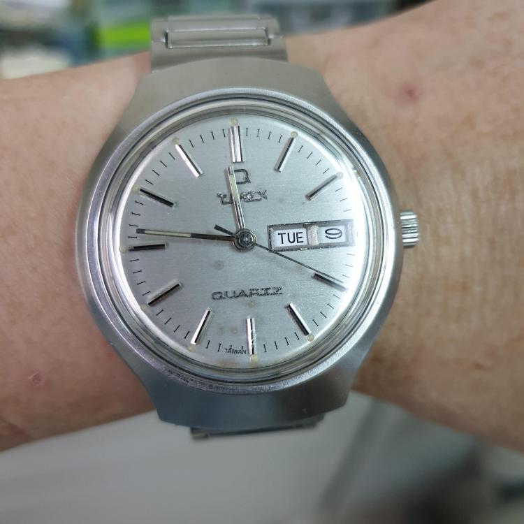

Just received my original 1978 Timex Falcon Eye. This blue dial is hypnotic. The battery had indeed leaked, but the corrosion was confined to the battery itself. I carefully removed the battery and cleaned the muck left behind. I carefully brushed out the rest of the crumbs and the dial with a clean dry paint brush. Absolutely nothing was corroded other than the battery itself. I popped a fresh battery in, gave it a wiggle and the balance took off running. It's been running since and keeping great time. The movement, I believe,  is a M63 quartz regulated electro-mechanical model. I'll polish the crystal next week and clean up the rest. Considering how pricey the vintage models are going for, I did pretty food on this one, less than $30.
Miraculously, the band fits PERFECTLY!:thumbsu:
I guess now that I own one, Timex says it can help me to carve stone horses, SWEET! Just what I always wanted!:D
I received this same watch in a lot I secured off eBay. Cleaned up really well and the new battery installation was smooth. I had to shake the watch a bit to get it up and running and manually move the mechanism inside (Still new to the hobby. Don’t know the actual part name).  This watch has been keeping great time for three days. Original bracelet was included as well. Thinking this watch will move up in my list of favorites.

The balance! And yes that's normal with these I think. The movement is not self starting if a good battery isn't installed because the balance needs to be swung to one side or the other in order for the electromagnet to be repelled back. The center is a neutral position and it may not kick up when the battery goes in until it gets a little flick of the wrist.
Thank you. Working on another Vintage Quartz. The balance (thank you!) starts and stops especially when the case back in put back on. Gotta figure this one out. Lovely watch overall. I see a nice clean up. Think battery alignment may be an issue with this one. Gonna take my time.
