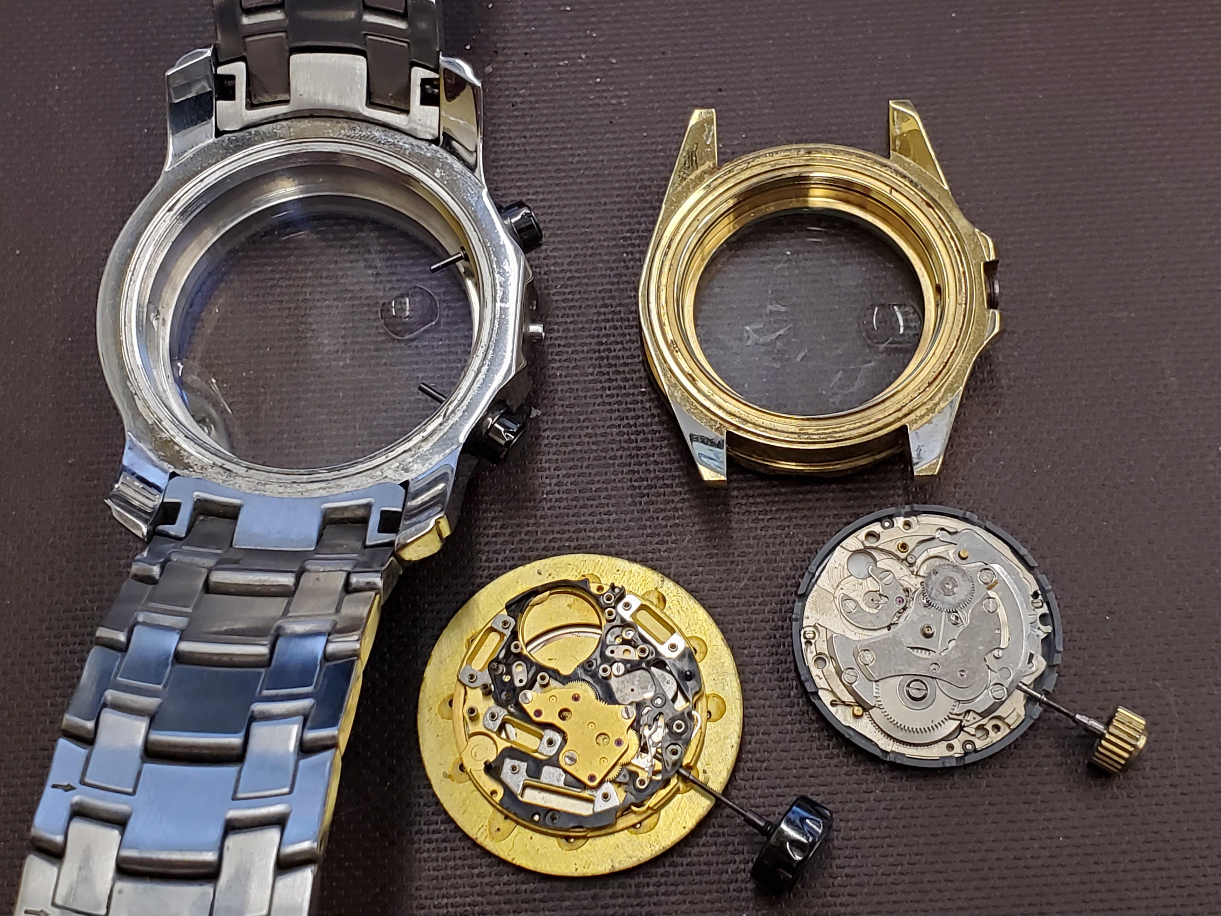

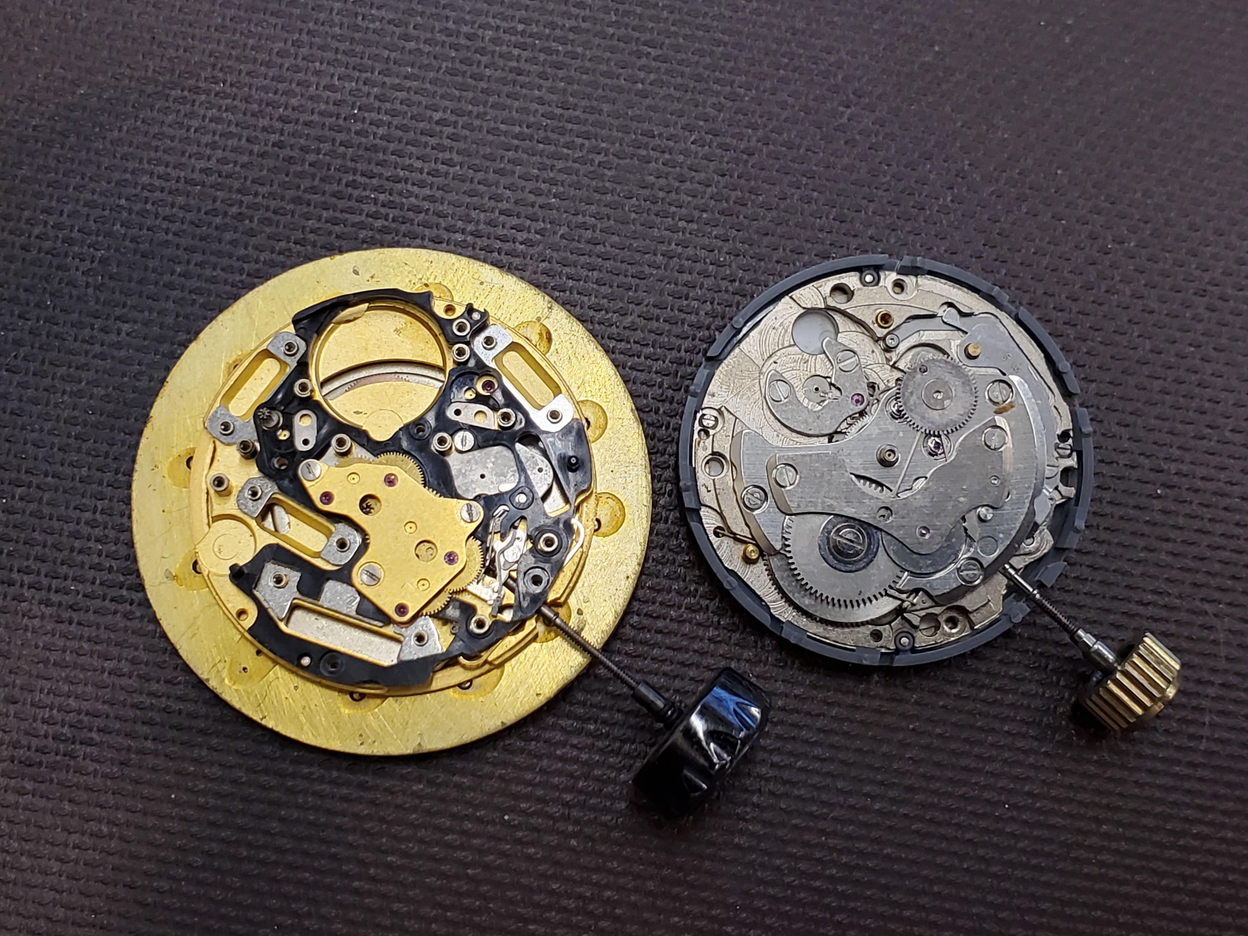

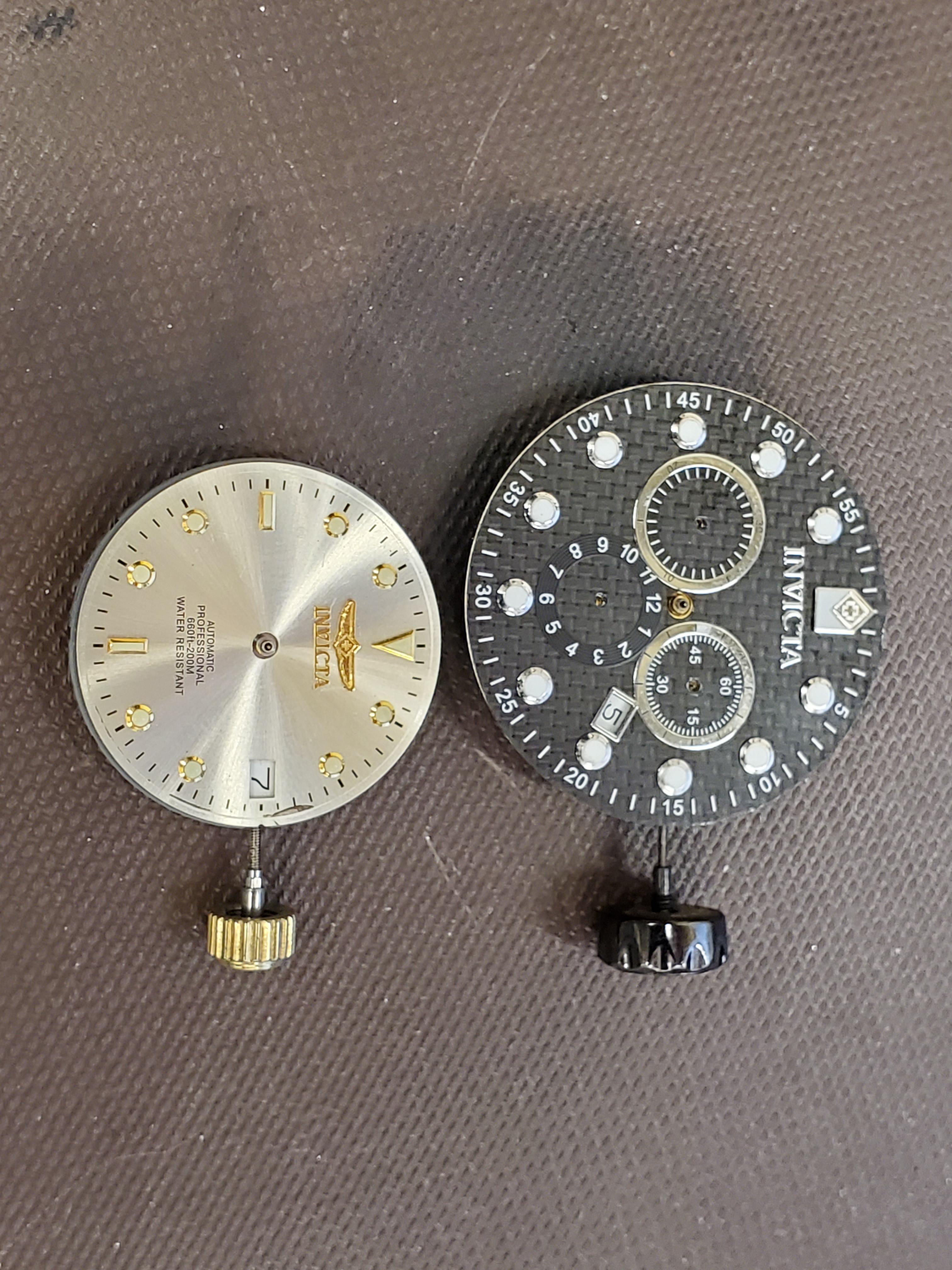

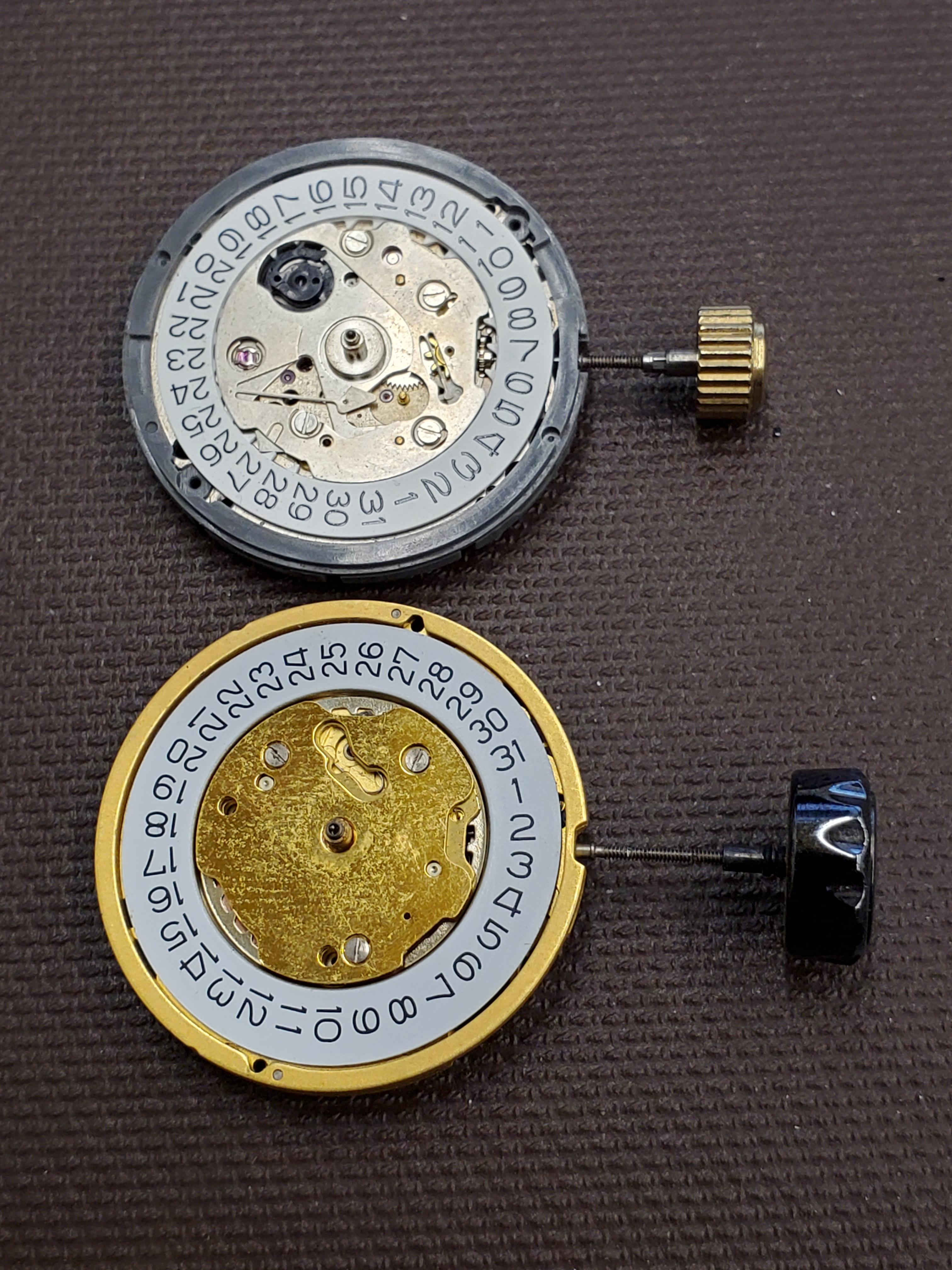

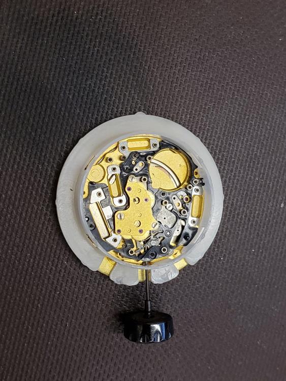

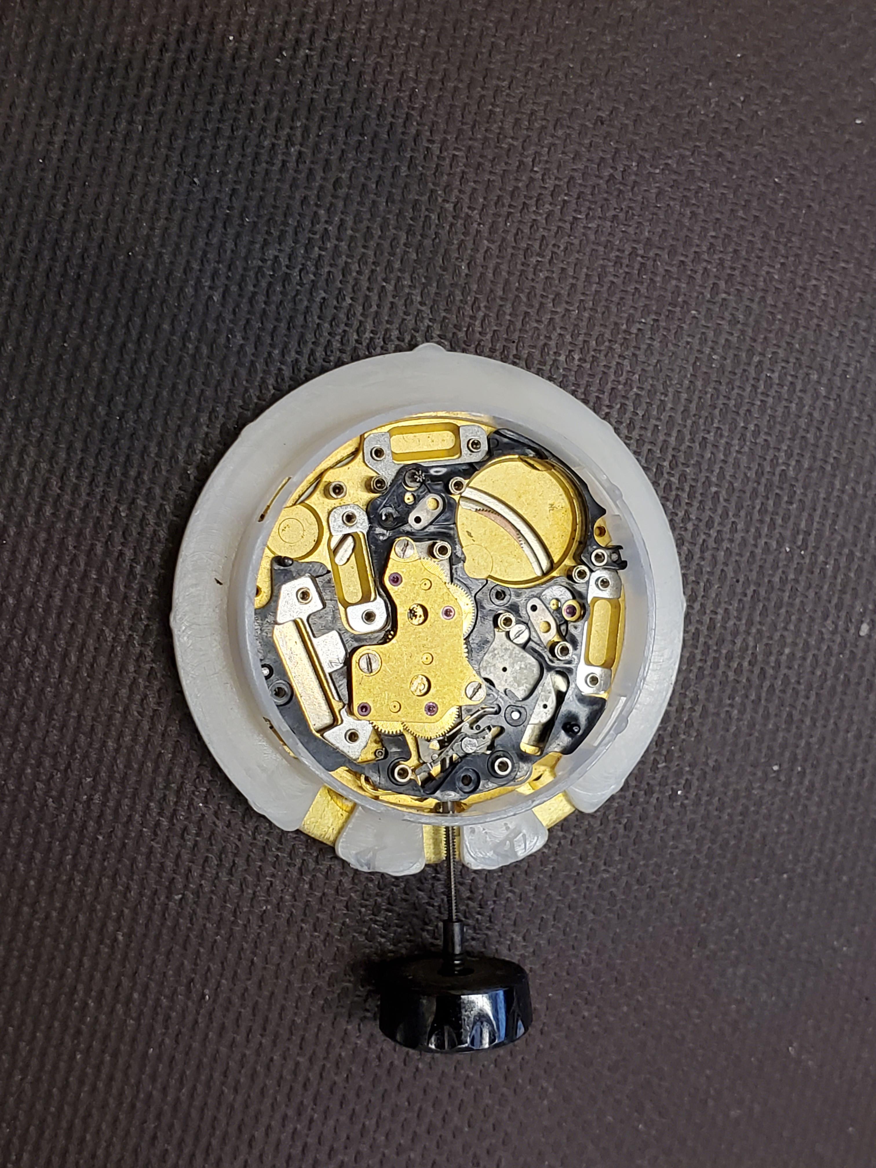

In-line with @jdm's statement, This has been the very thing that has been the business model of Invicta. They place average sized yet reliable movements in enormous cases with dials that fit and look proper from the front until you see them from behind. What you see below are two Invicta watch cases and movements. The lager is a very large chronograph with a Swiss Ronda quartz movement. The smaller is an Invicta diver with a NH35A movement with Seiko heritage. The actual movements are barely a millimeter in size difference. In the final picture below, you can see the large plastic spacer ring Invicta employs to keep the movement in place and stable.  So, the ultimate answer for the OP is yes, you can make anything fit in a large enough case, including a massively over-sized one with enough engineering.
