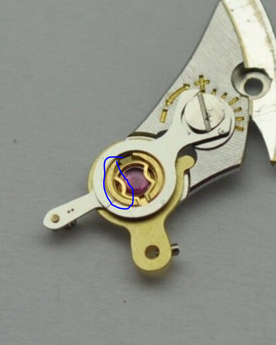

Don't have a video, but if you look at the pic it's a matter of the design of the bloc. The spring has to come in from the back, the outside. Some blocs have more of a chamfer at the perimeter, and where they are seated may have a decent chamfer, and some of the smaller springs have a smaller "T" end, and can be coaxed into place one "T" tip at a time without disturbing anything. But often the bloc needs to be pushed out a bit to allow access to the slot for the T.
And,  on some calibers the slot for the T is too accessible and the spring wants to fall out when open. On Incabloc the concept is it remains captive, but on some smaller calibers (like 5x7 ladies movements) particularly on the dial side the bloc sits proud of the mainplate surface and the spring just falls out when open.

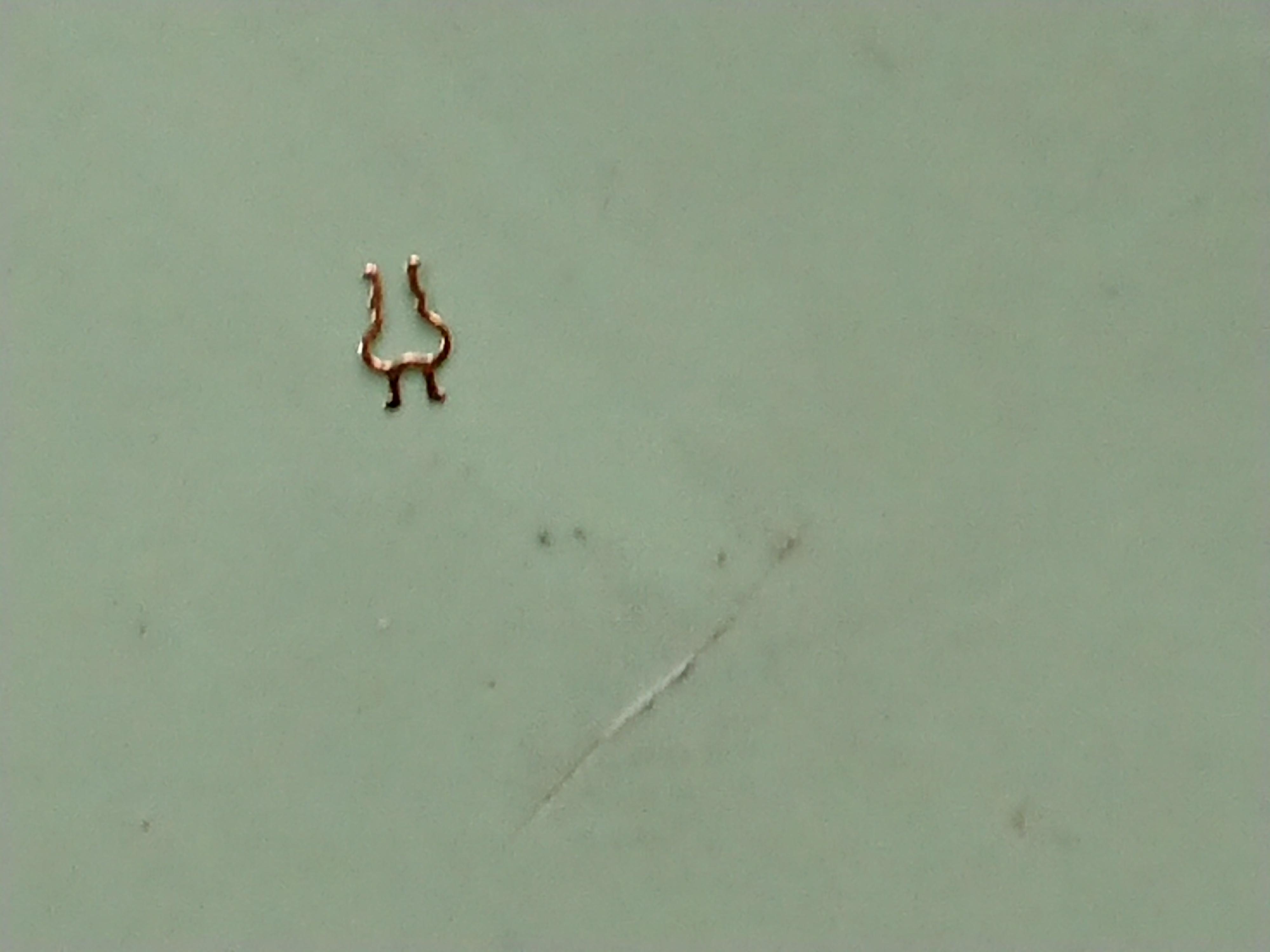

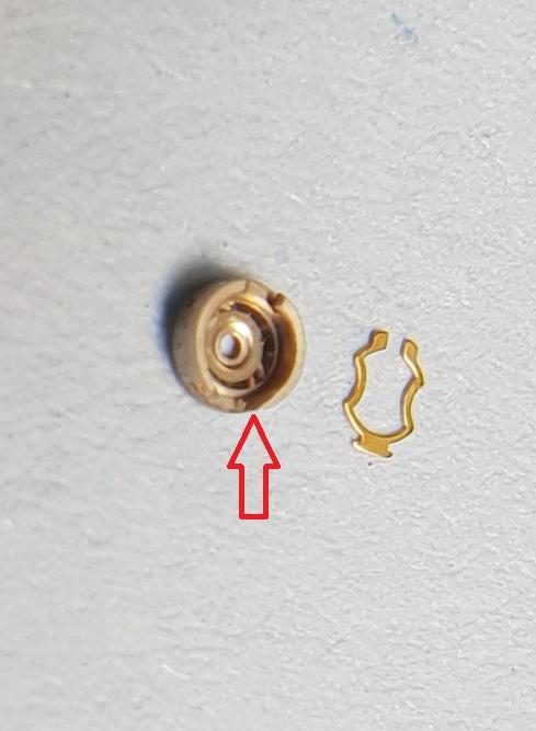

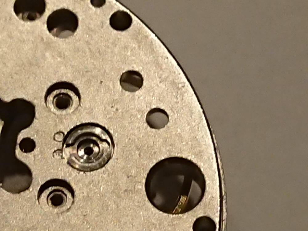

Thank you. I'm used to Seiko that apparently doesn't even have a separated block. Here the spring I broke and the block of a Chinese mov't, please excuse the poor pictures. Supposedly the hinges goes into the rounded slot?

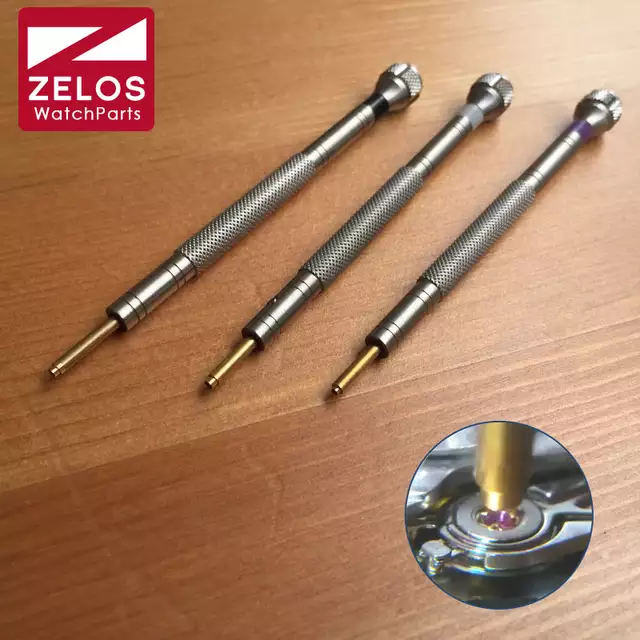

Finally, how these tools would fit the equation?
copper-Special-watch-tools-for-remove-rubies-disassembled-incabloc-Etashoc-fit-ETA2824-2834-2836-2671-2688.jpg_640x640q70.jpg_.png
Yes that Seiko spring is similar to many of the Kif models, and I think should indeed fit into the rounded slot.
The lower tools are for shock springs that are sort of a "bayonet" mount, where there are usually 3 openings in the bloc and corresponding protrusions on the spring. They are easy to damage when inserting, thus the tools; but a piece of pegwood that has had its end made concave with a round burr works very well too.
