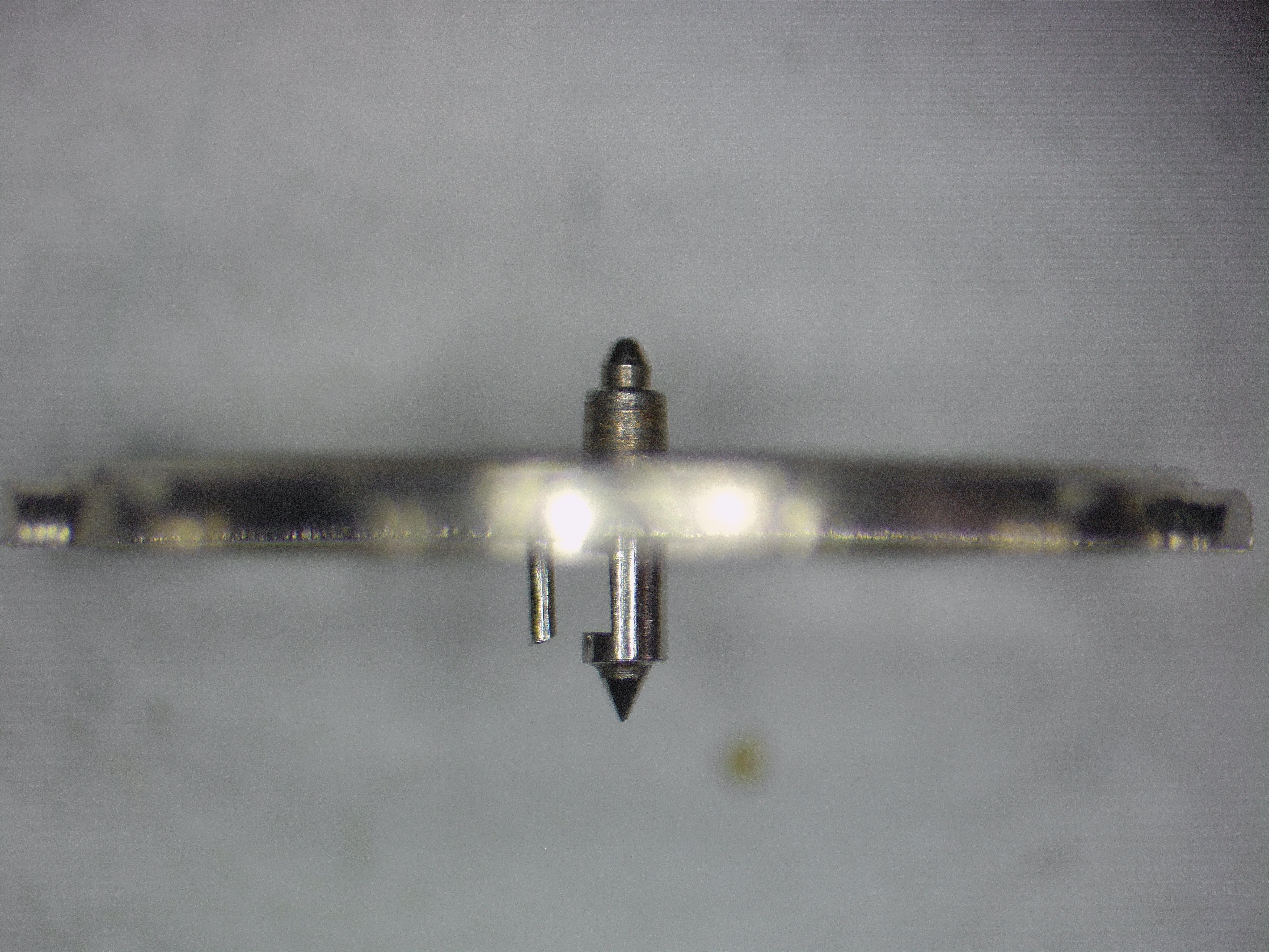

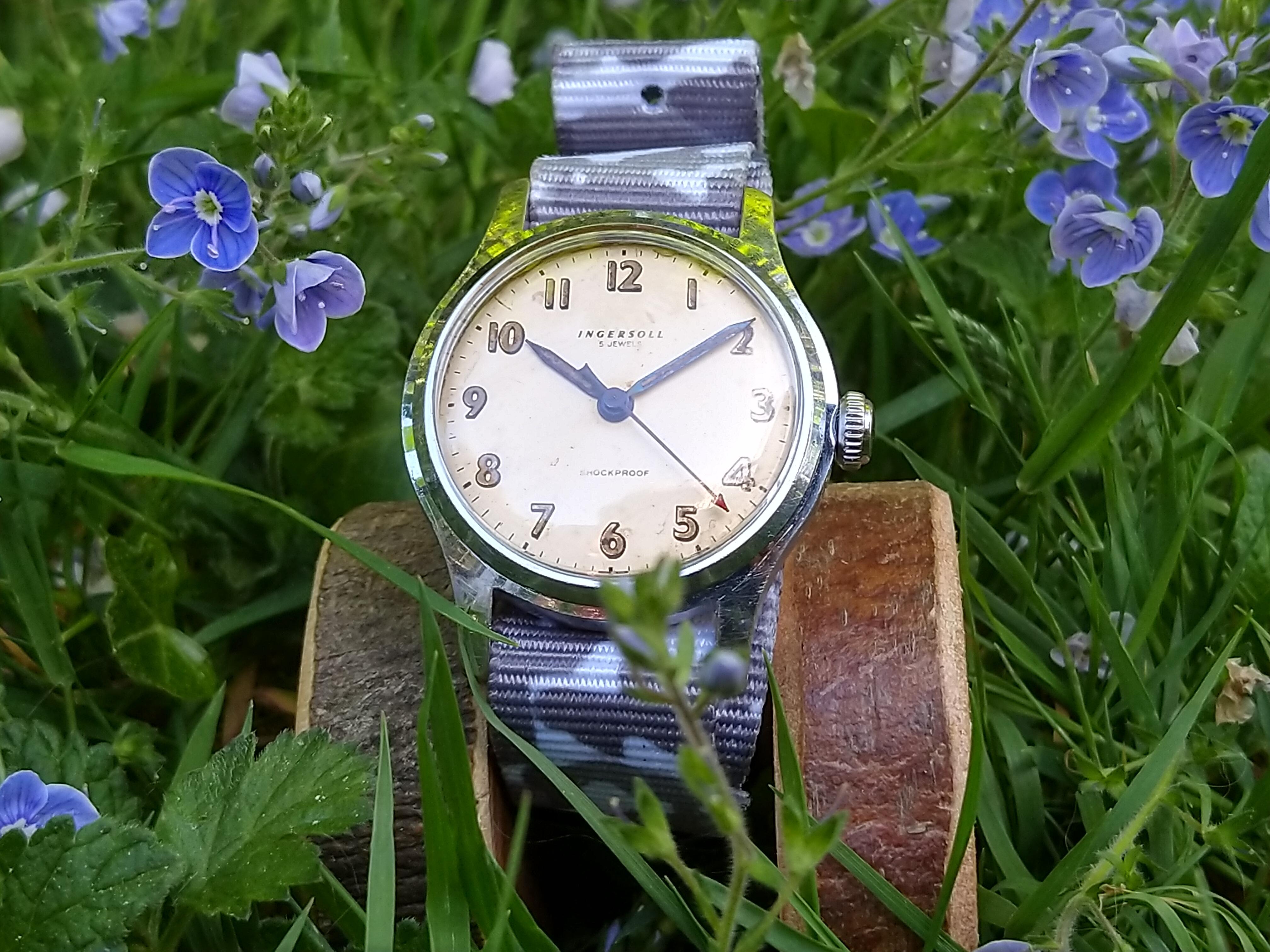

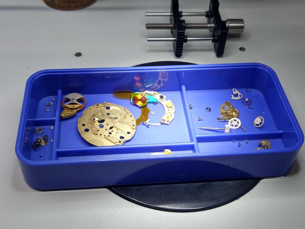

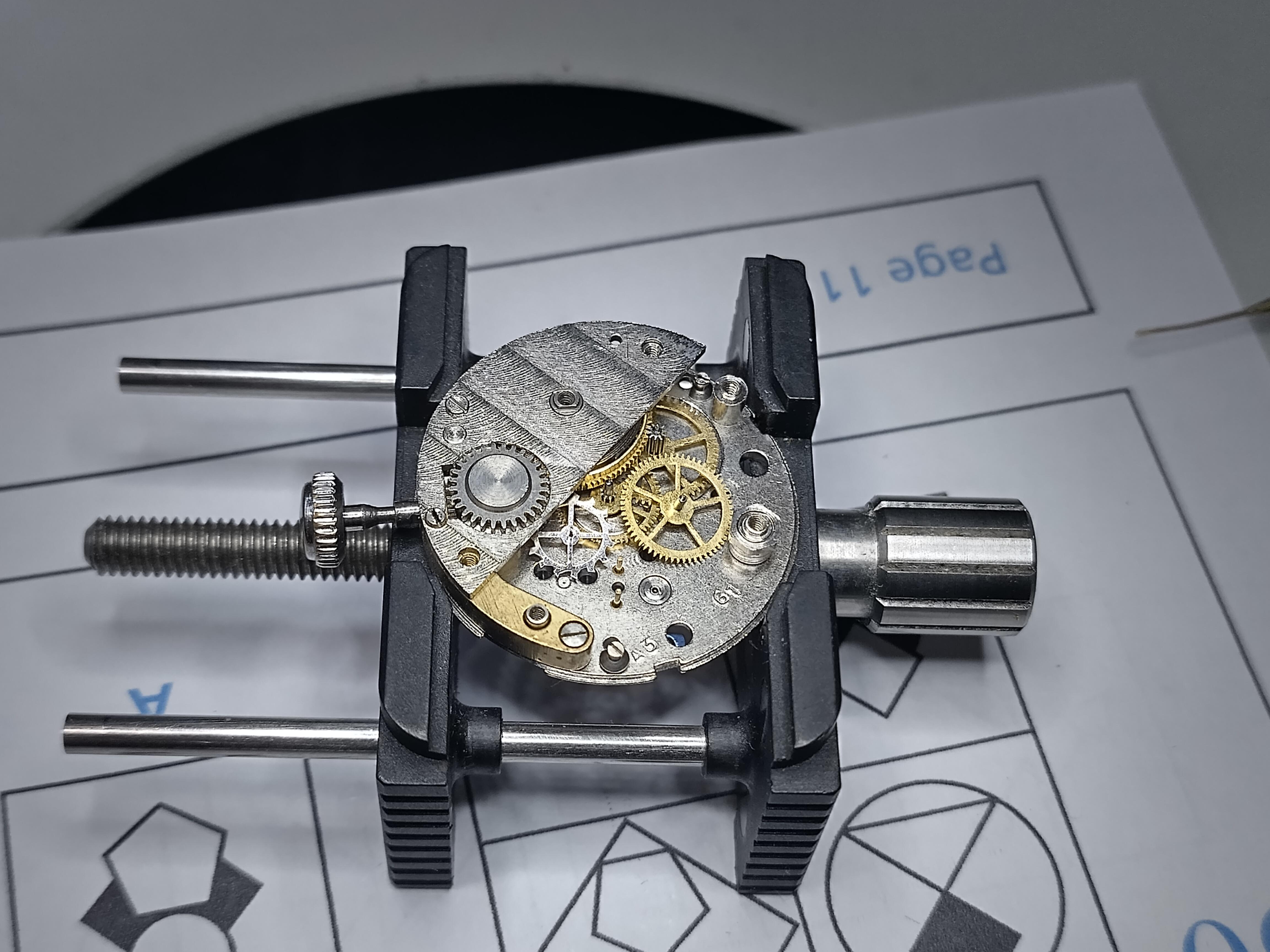

HWGIKE#53 Newmark 10.5 ligne 5 jewel pin pallet movement
My only one customer Stephen sent me 5 watches, three mechanicals and two children coming from a marriage of a mechanical and an electrical watch. I started with 3 of the mechanicals and managed to quickly ruin 2 of them. This one is one of those, I managed to brake off the curb pin which is really a wire hook replacing the curb pin and the boot effectively. I luckily found a replacement in one of my drawer, my alternative was to machine another pin on the lathe and rivet it back to its place but there was no need for it. The donor movement also provided a "new" set of hands which I re-lumed. The boss of the original minute hand was damaged anyway. Had to replace the mainspring as it was set. Polished the non original crystal which actually looks funky. (not entirely sure about the meaning of funky but it seemed to be appropriate.) Also had to work on the HS which I have surprisingly not ruined as I went slow and methodologically inside out one step at the time. Still need to regulate it started with more than 10 mins a day slowness, might need to shorten the HS and re-regulate it set the beat error again. I first could not identify the movement but this helped:
https://17jewels.info/movements/n/newmark/newmark-10-1-2/
This is also interesting:
https://www.watchuseek.com/threads/newmark-watch-co-info-please.612406/

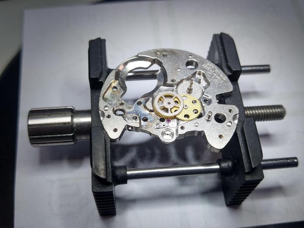

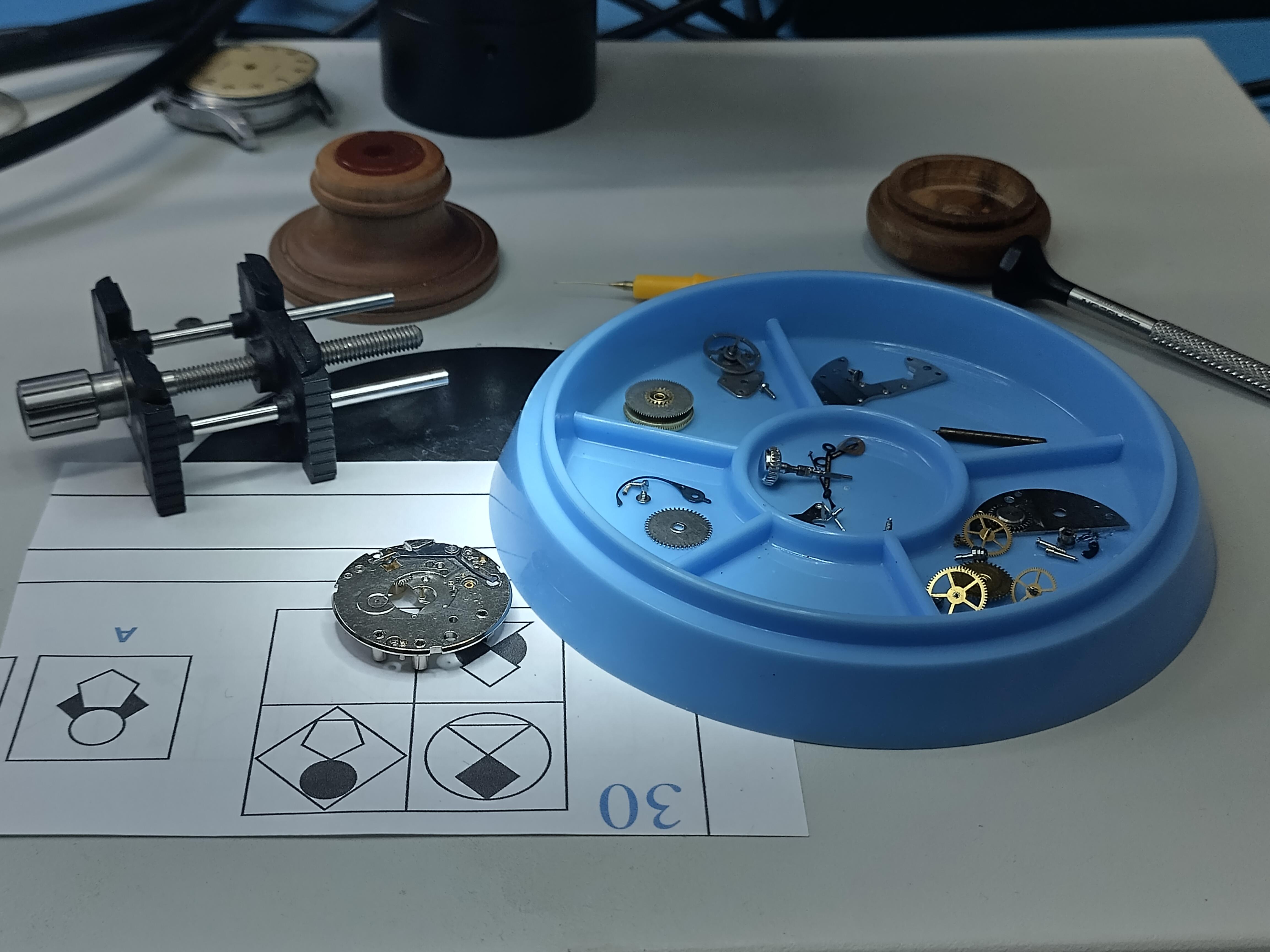

I usually dont do before and after pics but now I put two of them about the main plate to see whats the difference before and after cleaning and removing some surface rust.

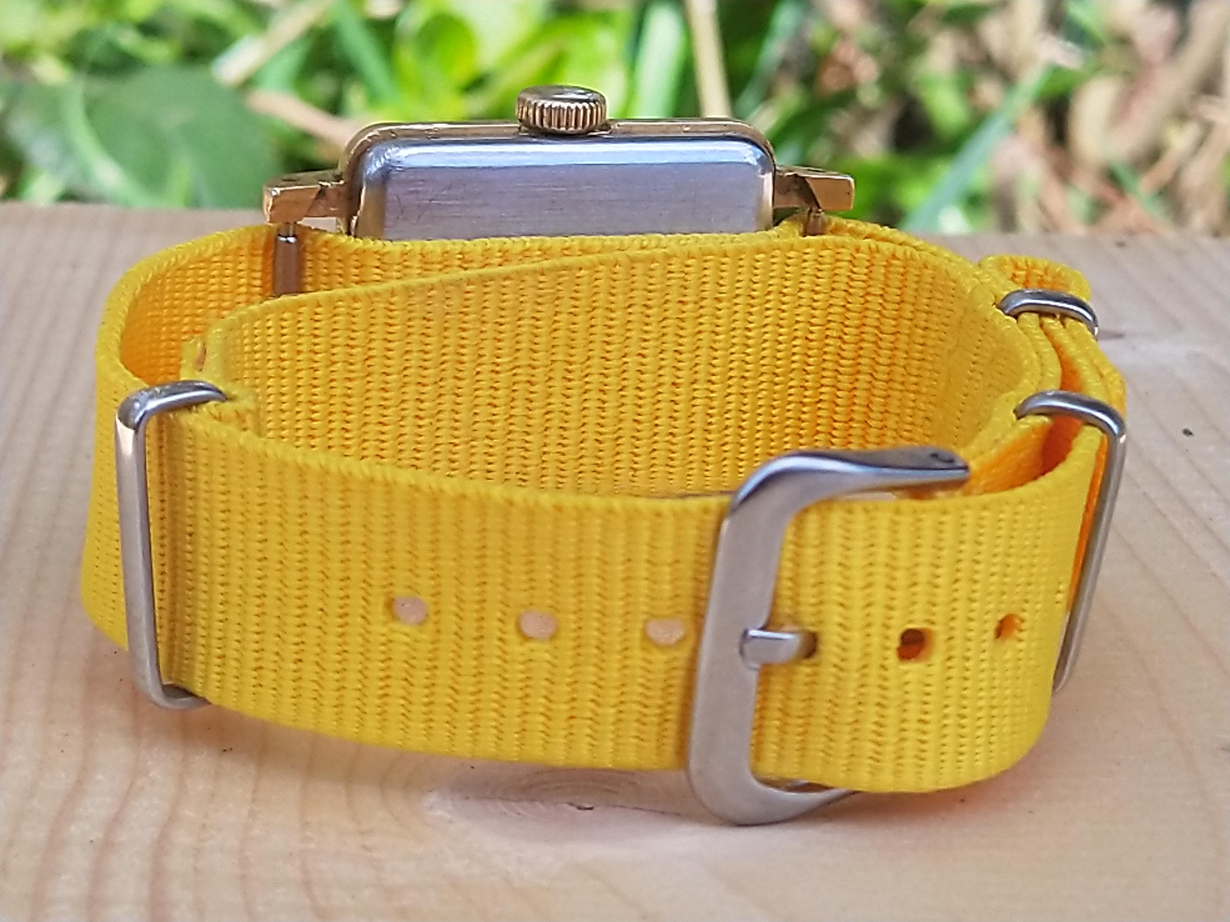

Stephen, I am going to send the original strap back to you just in case you dont like the yellow. 😄
Edited by luiazazrambo

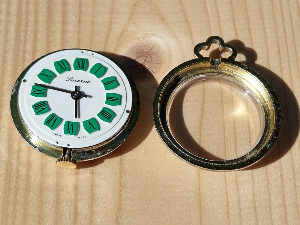

HWGIKE#54 Desa 320 Pin pallet
While I was waiting for parts I thought I would do another pendant watch this time for my Mother in law. When I opened it up I had a BFG866 feeling but it said D 320 so it counts! 🙂 No mistakes or anything to mention.

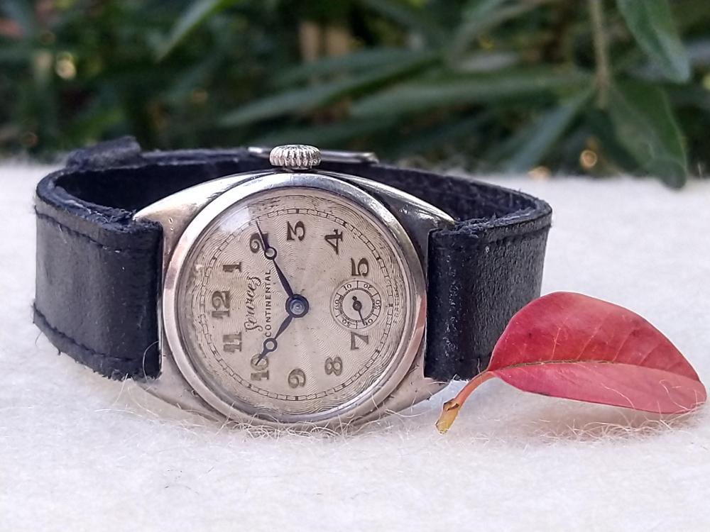

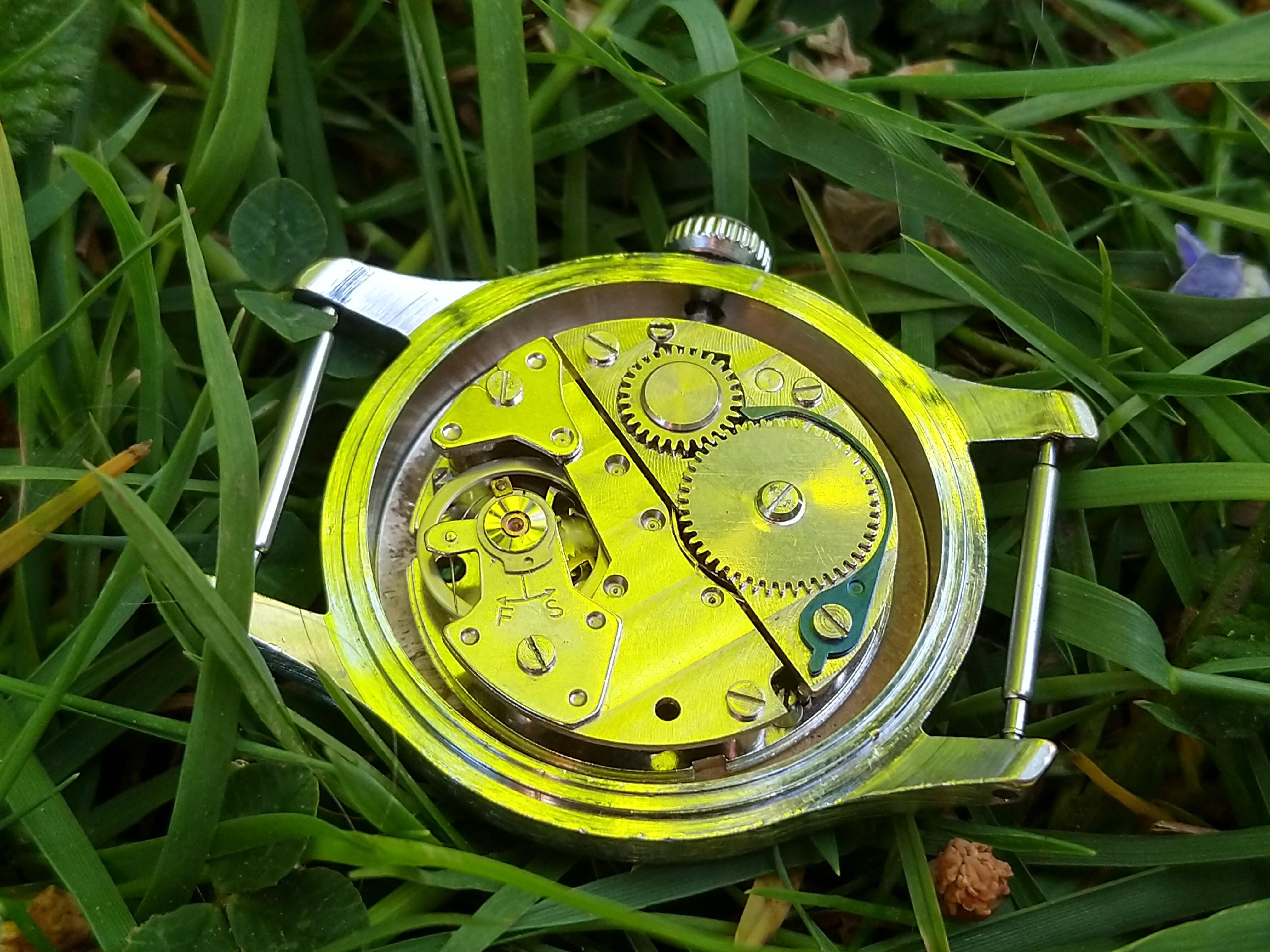

HWGIKE#55 Services Continental Bifora 102 Swiss lever

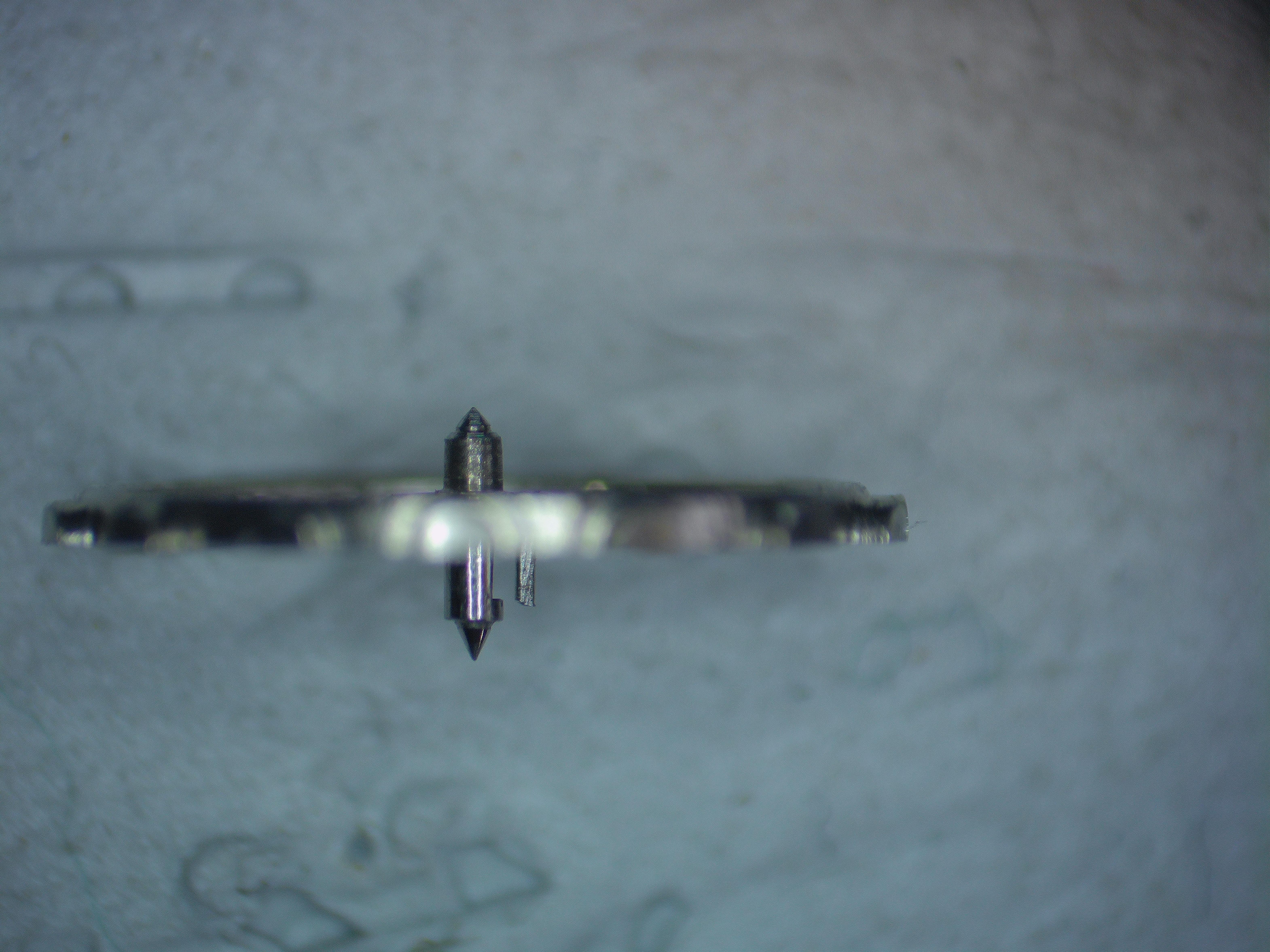

This is one of the Stephen's mechanical watch out of 3 i did not ruin. Service went well but when I put it on the time machine the graph was nonsense. Realized that the balance was wobbly as one of the pivot was worn and bent. Luckily eBay had a complete balance in mint condition for £12.90. When it arrived I installed it but the graph was still nonsense, I had three double parallel lines... I saw that the upper pivot was jumping in its jewel hole... realized that the jewel was replaced, hole diameter twice the size compared to the pivot diameter.. not just that but it was not secured either and was moving in its seat. Selected one from my stock, balance jewel not plate with correct outside diameter correct hole and rubbed it in securely. Also had to replace its mainspring... old one was very weak and set. Selected one from my stock but it was too strong, balance went over 360 so I had to order the proper one from cousinsuk. Even this weaker spring is very powerful now as the watch clean and lubricated half wound and amplitude is around 320-330. Beat error is around 1.1ms not sure why.. managed to change it from 0.6 to 1.1 after setting the impulse jewel exactly in the middle of the banking pins. Very strange. Regulated and keeps time. Case is made by Mr Aaron Lufkin Dennison and made out of silver.

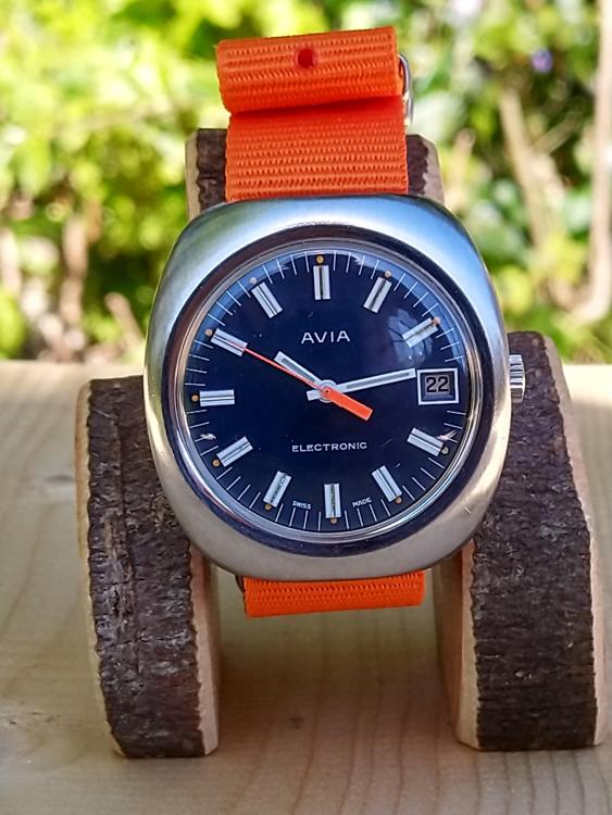

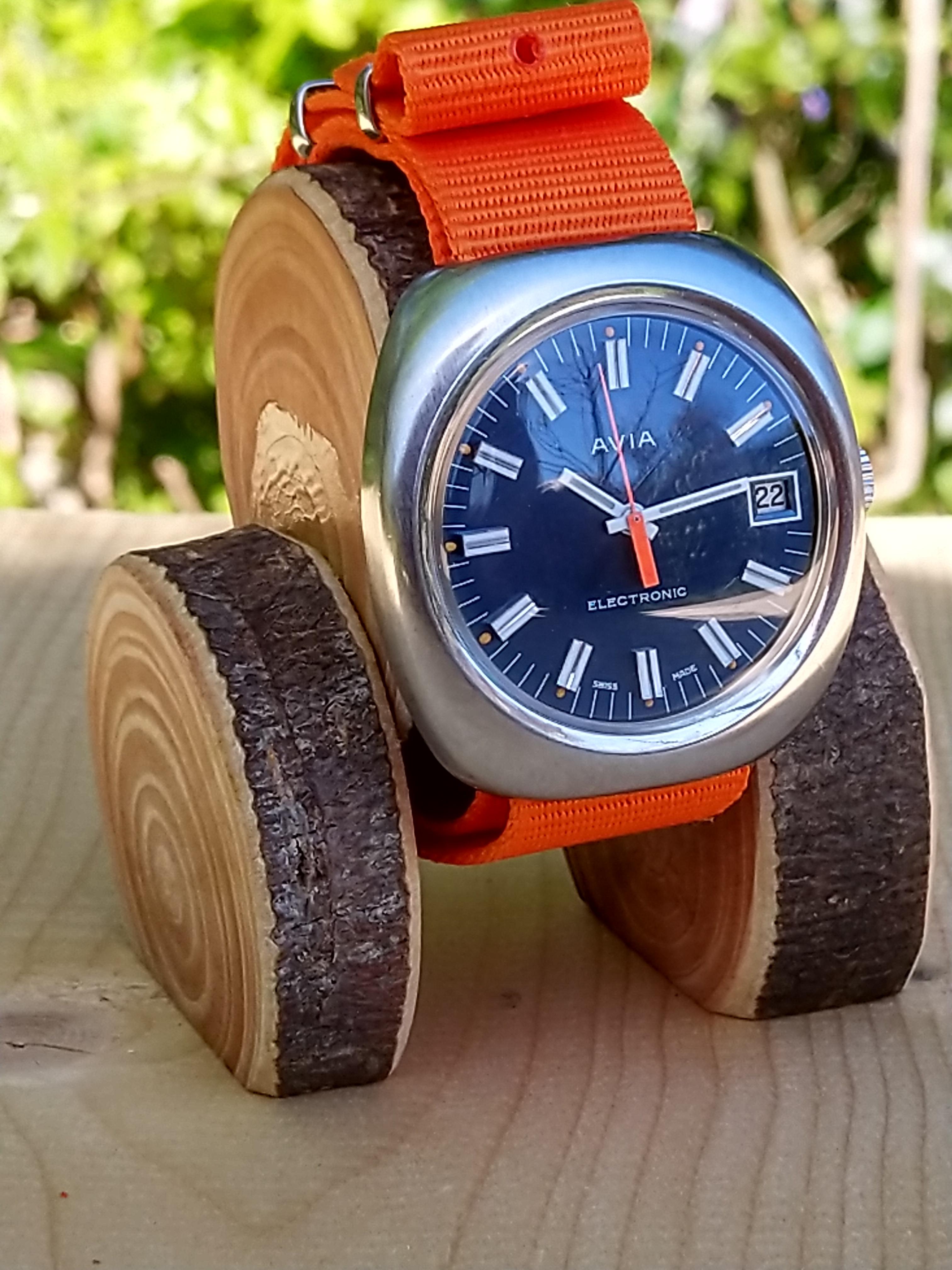

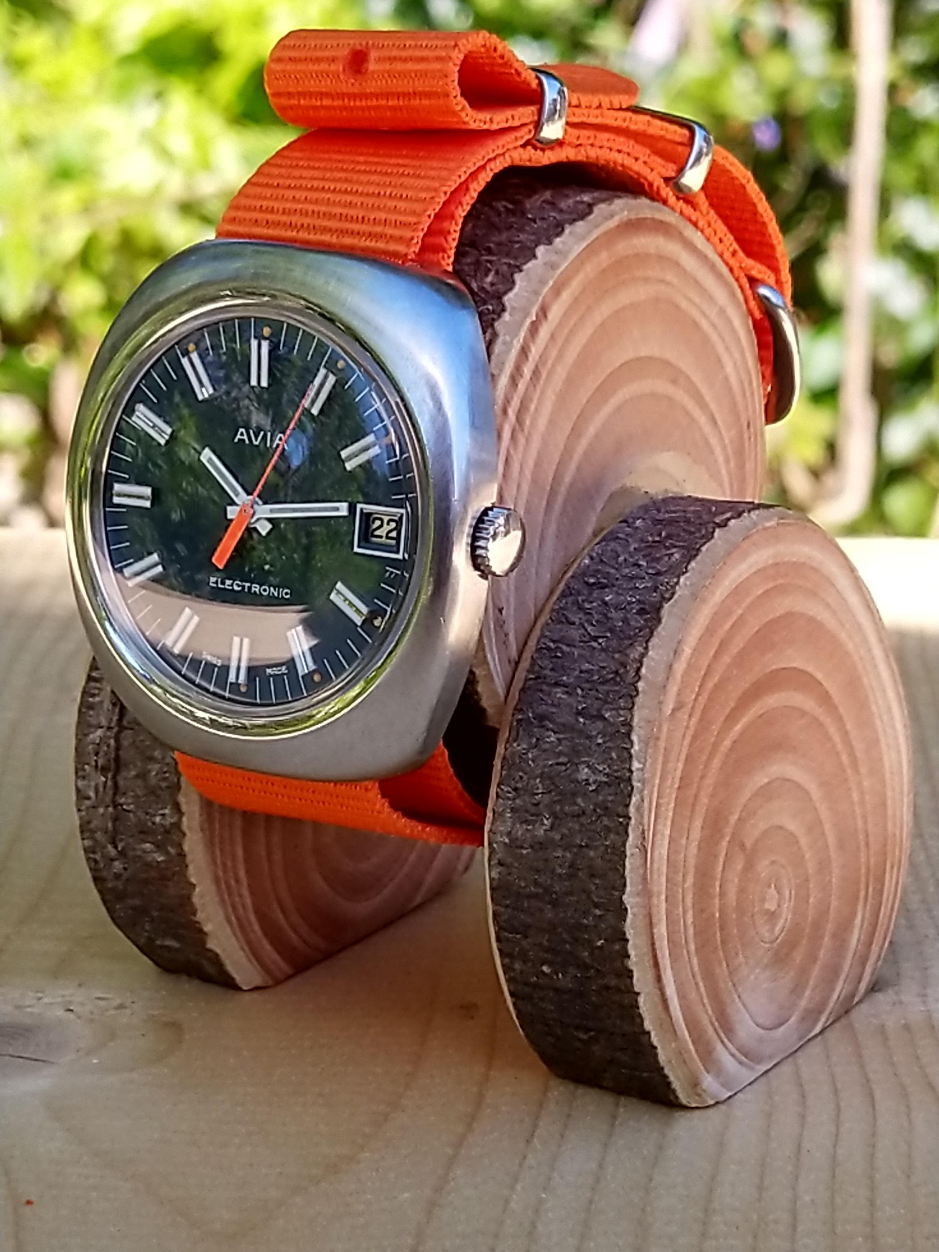

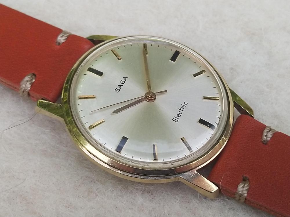

HWGIKE#56 AVIA ESA 9154 love child of an electric and a mechanical
Could not resist... I still had 2 nights and a couple of hours today to service this one before travelling. I have 9158s but this one is a 9154, pallet fork has a built in magnet. This is a real miracle, a bit tricky to get out from the case, but didn't take long to figure it out. Was very very fast after the service, didnt check it before though. Had no choice but to re-lume the hands.

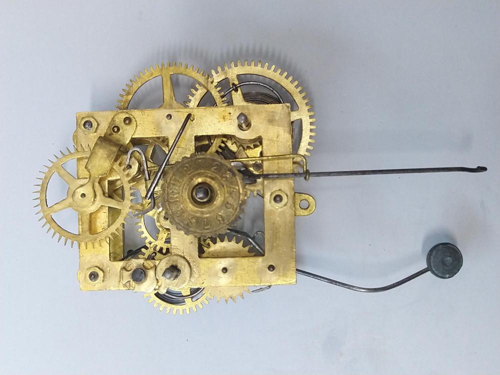

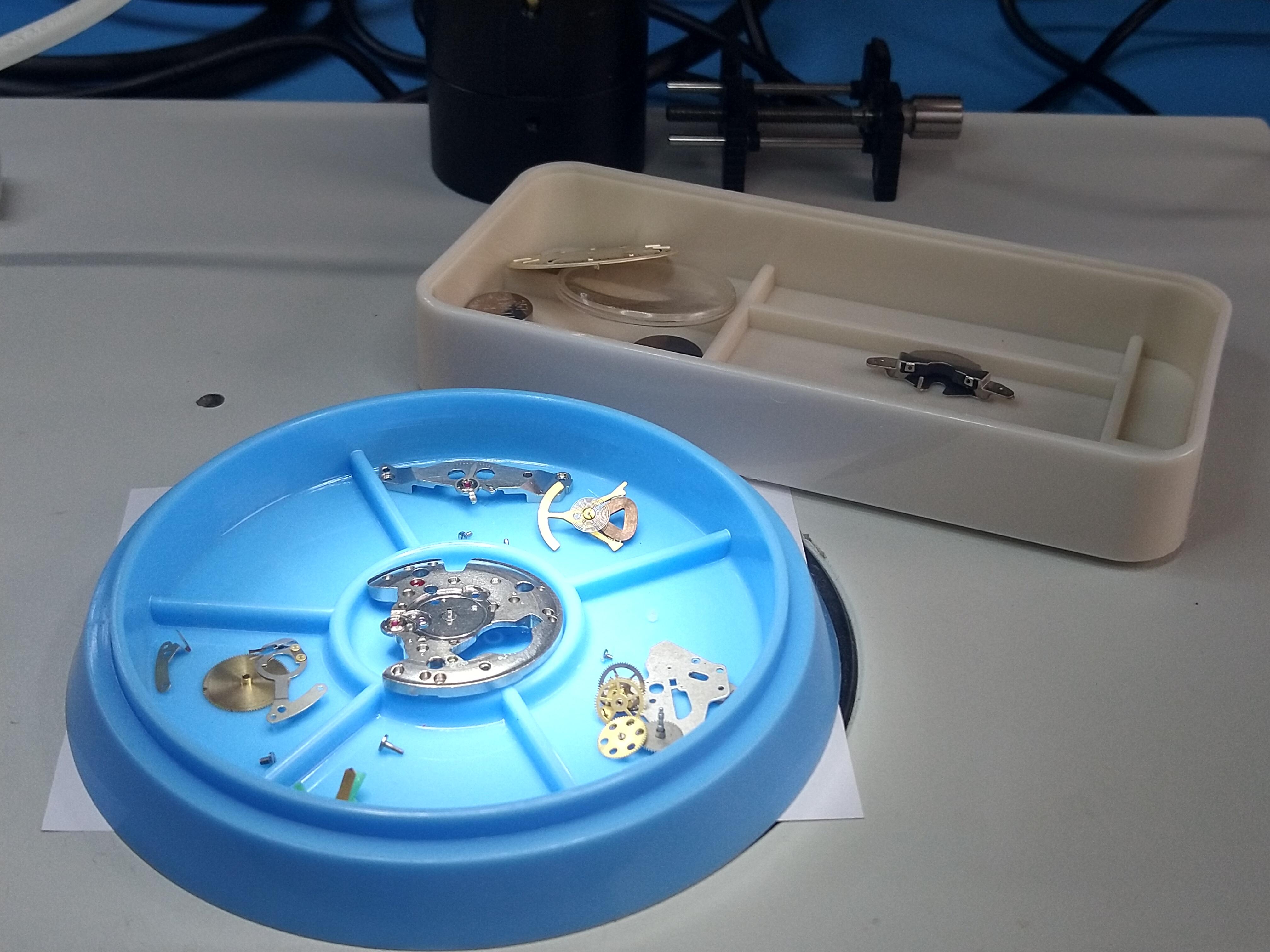

HWGIKE#58 Alarm clock, cooked in hot cleaning fluid and oiled gently.
This is a movement so I count it. 🙂 A while ago it tried to fly away one day, it was on my windows sill, we had strong wind the curtain flew like a flag and doing so encouraged my clock to do the same...  went out and ended up on the roof above the entrance door, its door in pieces but the clock itself suffered no damage otherwise. The original glass was already broken when I received it I still have the bottom part in two pieces. The new "glass" is acrylic. It also had a paper in the back in the case inside but it disintegrated, I still have a little bit of  piece of that too.
