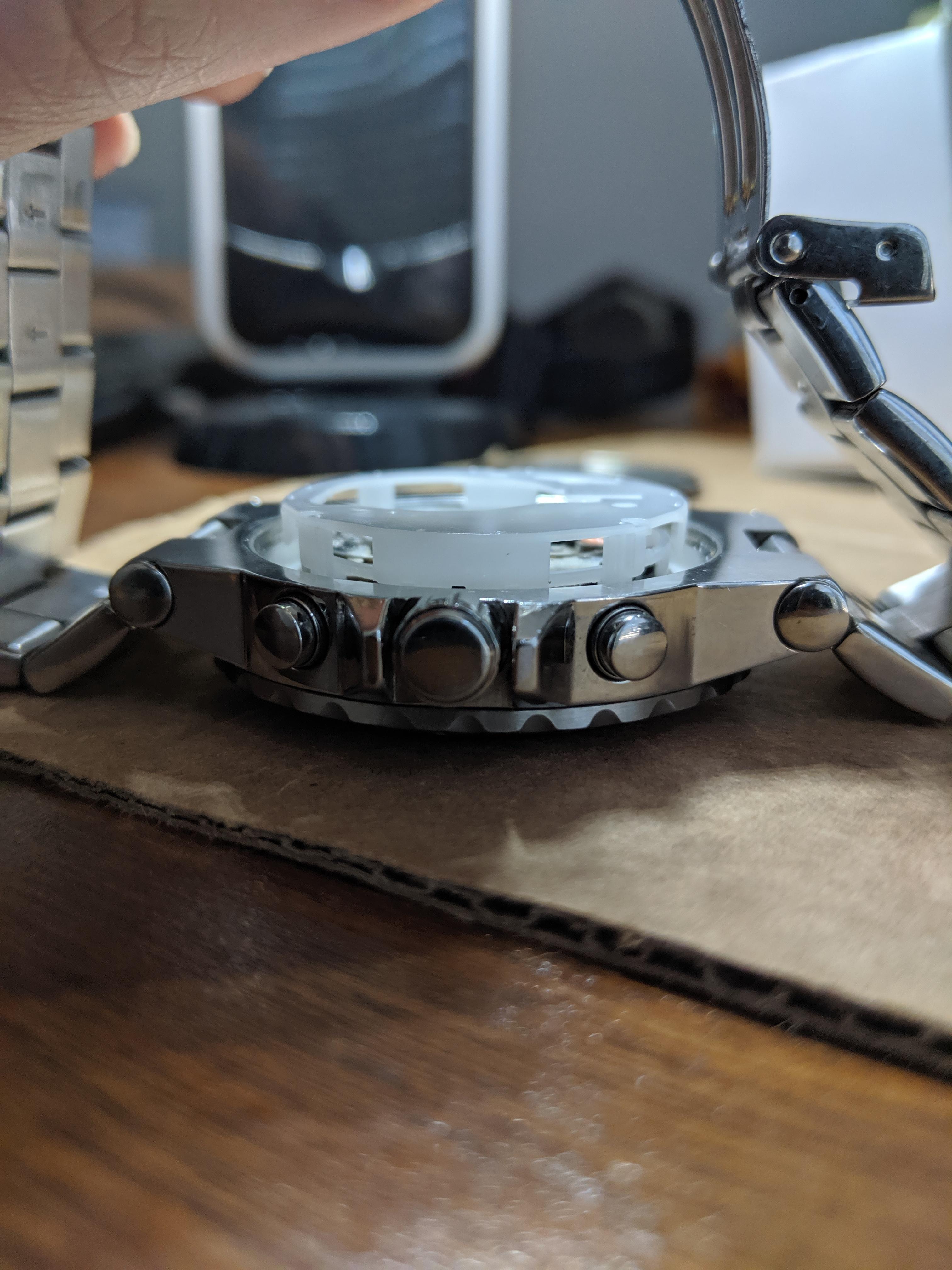

I replaced the battery of an Invicta watch, and I could not remember if the inside had this odd plastic reinforcement or not.  I think it came from the watch, but I can't figure out how to fit it in and close the case.  I've had no success with a general online search, so I'm hoping someone here would have some experience with this.
I could put the back on without the odd piece, but I'm afraid that some damage could occur to the watch without the piece in place.
Thanks in advance!
It appears to fit with the pegs pointing down in to the watch and the longest of the curved tabs in the vicinity of the winding stem.
Proceed with caution, these things break very easily.
Hi Louis  It is the movement protection cover and as Andy explained it will only fit one way, so with gentle pressure try in the various positions but above all be very careful as the do break easilly

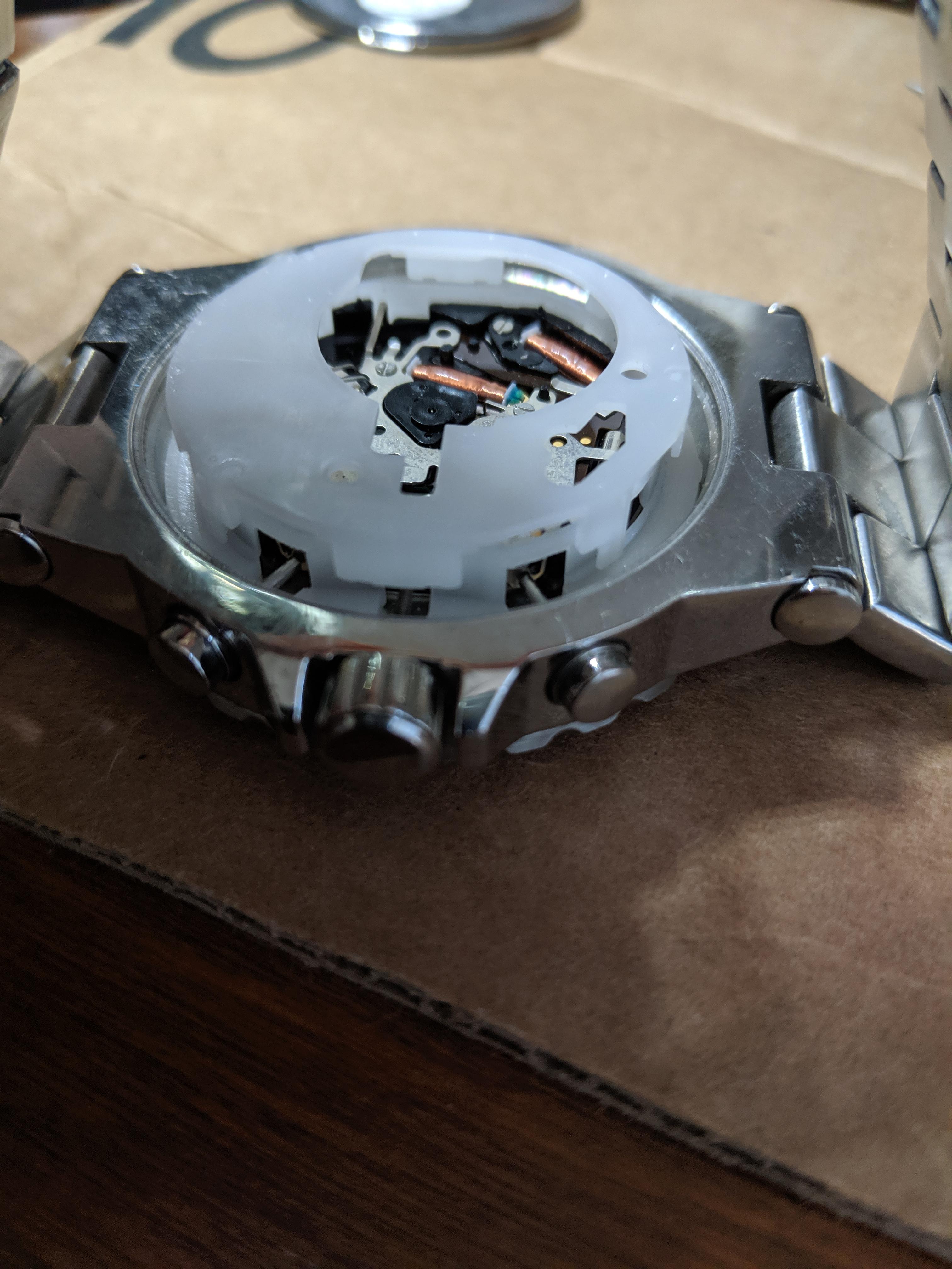

Thanks for the suggestions.  Now that I know that this piece is supposed to go inside, I'm having a hard time finding the correct placement.  It doesn't snap in at any point that I've seen so far.  I've removed both protective pieces and tried to make them come together with no success.  The movement protection cover sits up very high in the watch not allowing closure. I'm still trying.
I've attached a few pics.
I've removed both protective plastic pieces and have not been able to make them fit together.
I may have to go to an Invicta store, but they might not know about this at the store unless a watch maker is there.
3 hours ago, parmenion31 said:
those back case usually need a machine to close properly and sometimes are real pain even for profesionals . its not screw type if i can see clearly ?
You are right about the piece, and that's cool that you recognized it as Casio!  I opened a Casio G-shock watch that I recently changed a battery for, and this mystery piece exactly fit in there.  I just don't remember removing it when I first opened the Casio. :unsure:
The Invicta has a 373 battery.  The case back was a pop off type, and I definitely had a hard time removing and closing it.  I do have a watch case press and was able to close the back after some tinkering and adjusting, but I felt a great relief and euphoria when if finally snapped shut!:woohoo-jumping-smiley-emoticon:
Thank you, Parmenion31, for the tips, and thanks to the others that gave feedback!  I appreciate it very much!  This forum has saved me, and I'm glad I found it! :Bravo:
