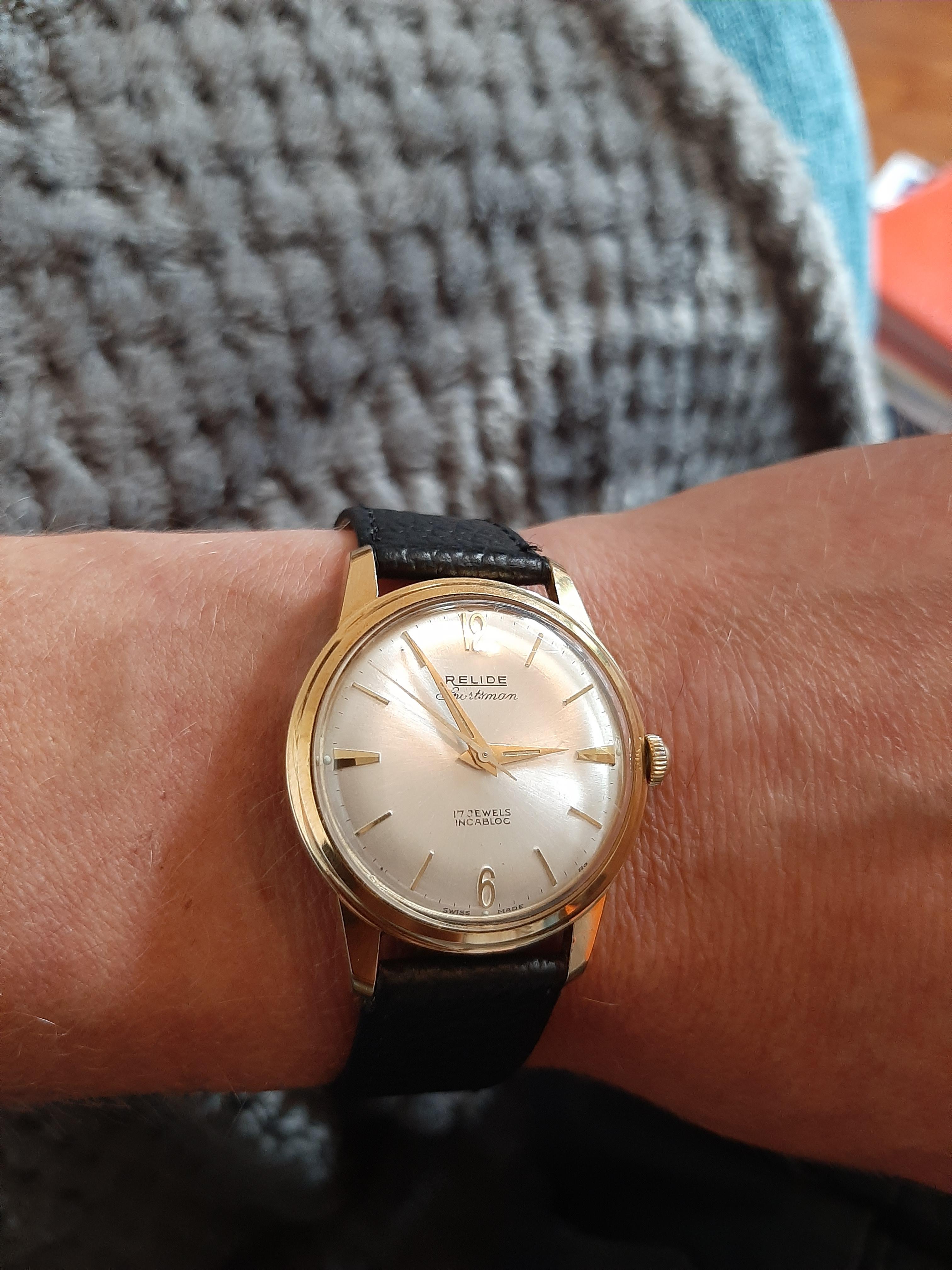

If I can get something else to fit inside I'll just use it myself as I like watches that look like the Relide I'm wearing now in the last pic with its good old AS 1686.
