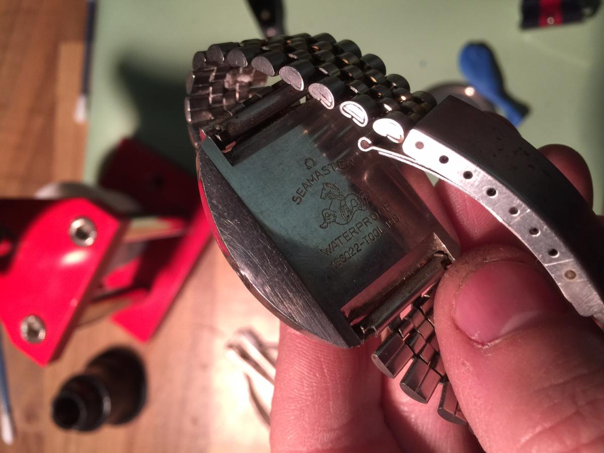

Hi, I've got this omega and on removing the glass to get to the movement it shattered and now the tension ring I believe is still in place with what's left of the glass. Any ideas on how I can remove this?

Hi Bob, the problem is getting the movement out, it's a sealed case, everything comes out from the face side. As per photo, but the glass broke and has left the broken part still in place with the tension ring, I can't seem to get hold of it to remove it.

The glass does look intact (You mentioned it was shattered). The pendant tube is missing.
This may seem like a strange question but do you have an air compressor?
The whole glass didn't shatter, just all around the edges when I used the crystal removal tool, I don't have an air compressor no.
Oooh! That is not good! If my understanding is correct the tension ring is holding a slither of the perspex around the circumference of the case.
If this is correct then you actually run a serious risk of damaging the dial Paul whichever way you look at it.
This is too late but if you don't have an air compressor then the glasses can be popped off with a nice big syringe (through the pendant tube (I have a video on the channel showing how)). You should never use a glass grabber on a tension ring glass - only useful for High Domes really.
But in this case most of the glass is off? If so then you can only very gently try to prise away the tension ring but it is not a job I would savour, I won't lie.
OK I have read your reply again - if there are no holes in the glass you still might be able to pop it off.

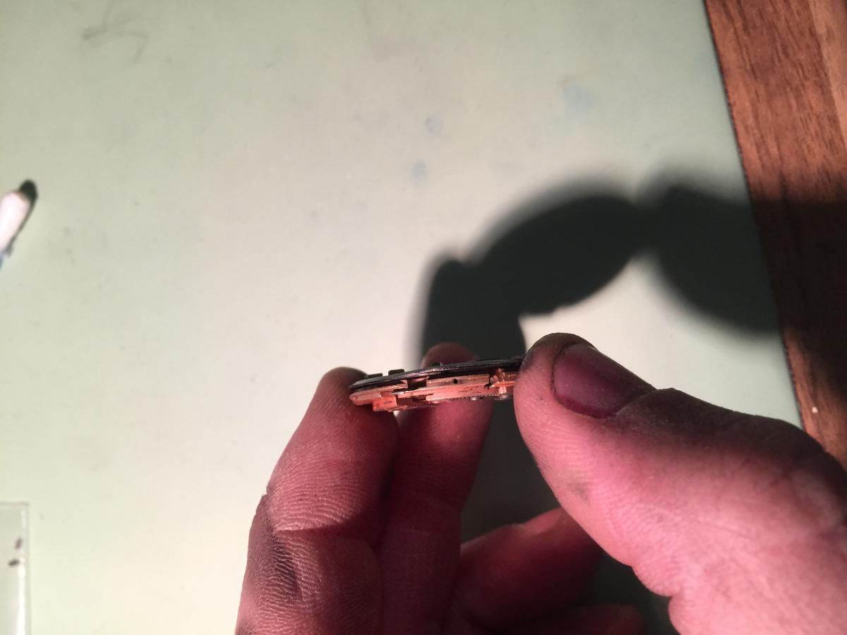

ok, so this Seamaster Cosmic was sorted as it just needed a new glass. I have another exactly he same, i used Marks method of getting the glass off (couldnt find a syringe but managed to get a balloon pump for a quid!) now after inspecting the movement from the back, all seems well apart from some rust here and there, but i cant get the dial off. I think i can see the pins, but no screws or anything, ive tried prising it off with a case back knife but the dial started to bend. Ive attached some pics, the movement is an Omega 565
If the dial is held on the same as the 561 movement, there will be a couple of very small screws going in at a shallow angle with entry at the side edge of the main plate. You will probably require your smallest or second smallest screwdriver to do the job.
Thanks Geo, i can see the holes, but they seem a little far away from where it looks like the dial feet are situated, and theres no sign of screws in them.... but i shall give it a try with the smallest screwdriver in the morning.
I have a Geneve with a 565 in it which i have been working on  screws are at 12h and 4.30 and are set at angle to the feet.
