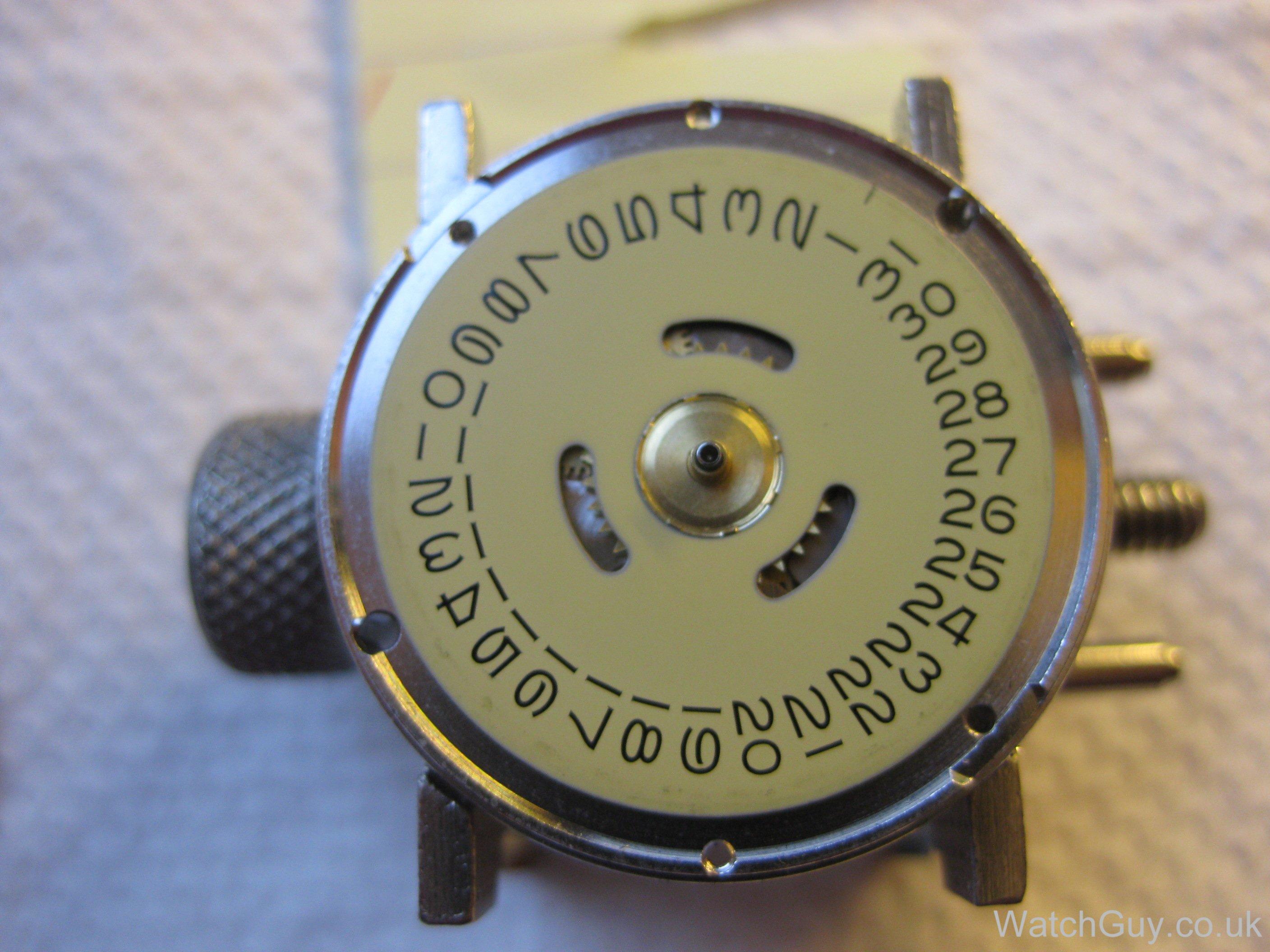

The calender date disc is not moving correctly on a Rolex Oyster Date Precision (datejust ref.6694 cal.1215
The date on the calendar wheel only shows in between dates in the date window, it also seems to be moving only about 3/4 of a turn each 24 hours.
It looks like the notch on the driving wheel isn't correctly contacting the teeth on the datewheel.
How can I get the date to align correctly?, could the driving wheel be worn to much or is there something else that's more likely?.

There aren't very many parts in the 1215.
The date indicator driving wheel is the one responsible to change date with the help of the little pin on it.
On the date indicator you have an date star that will rotate it around.
The date jumper will keep the date indicator in place. In the picture you provided the little arm is bent slightly to high up try to adjust it a bit lower. The little pin on the end of the arm is what keeps the date indicator into place by locking the date star.
If the date star isn´t correctly in place or the date jumper is missaligned then the dateis off like in your picture.

I've bent the date jumper back a bit, have also tried several different amount of bending it without solving the problem.
The only thing that looks like the culprit is the driving wheel. I've also noticed that is has a very slight wobble compared to all the other wheels, is this supposed to be like this?. Just want to be 100% sure what's wrong before I start ordering parts.
When it comes to the date jumper, the teeth on the date star just glides over it, is it supposed to lock the date in any other way then just to keep some light pressure on the disc?.
 It is supposed to be completely flat, no wobble. If it's not flat there is a risk the disk is not just scew but the date ring also is misaligned to the star wheel. The snappy action during date shift will for sure not work in that case.

Have adjusted it like that. Also removed the jumper altogether to see if the disc would move more, but it didn't.
I measured the diameter of the peg on the driving wheel and it's 0.3mm, is this the correct size?, to me the peg looks a little bit smaller then the other once I see pictured here.
The beak looks good in your date jumper but the alignement is crusial.
Unfortunately Rolex has the same view as me on this assembly, since there is so few parts it only says like this in the tech sheet.

I almost forgott, when testing the dial next time make sure you get it correctly in position, when I took a quick look at your initial picture of the problem one can see it is not in place but riding ontop of the date jumper.
The dial has to go all the way down to the wider part of the hour wheel. when it is at place , you can look through the inspection slots in the dial if the jumper is in place otherwise you can gently push it backwards and get it in place.
Thank you ! :), it works. I aligned the jumper, and when I rotated the calender wheel manually it suddenly snapped in.
Now the date has is nice "snap" once it changes the date :).
