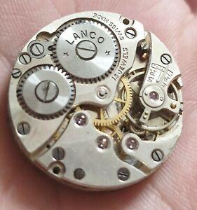

Sorry about asking again, I am trying to either replace or repair this movement. Mainspring slipping or broken, balance bottoming out. It's says Lanco 15 jewels and has a number dial side but apart from the number I can't find any other mark.

1930 ! If I can find its cal I will try and find what's needed, my only other option is to find out the correct movement for the watch and try to find one. The rear has Fero 76c stamped on it, I have looked in case it could be the original movement cal, but found nothing. If anyone knows the correct movement for this watch I would be grateful. I know it isn't a fantastic watch, but I like the way it looks.

Don't think it's the original movement. Says 17 jewels on the dial and 15 on the Lanco movement. I looked at Fero and found this. https://www.etsy.com/nl/listing/268861639/fero-17-jewels-196070s-gents-watch-with?utm_source=Pinterest&utm_medium=PageTools&utm_campaign=Share
Should think it could have had a EB 1197?
Indeed Rogart I agree with you, that is why I am considering finding the original movement type.

Thank you Rogart, just looked at your link, the same watch! You have made up my mind for me, I am going to find an EB1197 movement and replace the Lanco. Many thanks again :biggrin:

The movement appears to be the savonette version of the 11''' Langerdorf/Lanco 1 which probably goes back to the 1920s. As others have stated, it is clearly not original to your watch as Fero used pin-lever movements from Baumgartner, Brac, EB and possibly others.

Many thanks Rogart, as yet I have not taken the movement apart, but what's immediately obvious is the spring balance is bottoming out so cannot swing freely, and if you try to wind it, it slips after a couple of turns. I am dithering between the best course of action as my experience is really limited. Do I replace the movement or repair the old one, my head says replace, my heart says repair.
Got this off eBay last night £5.21 including postage. Hopefully this will do ? Not sure but for £5.21 it was worth the risk. This one doesn't have a sub dial though. Was hoping to use it for parts, ? BUT I expect to be wrong!
