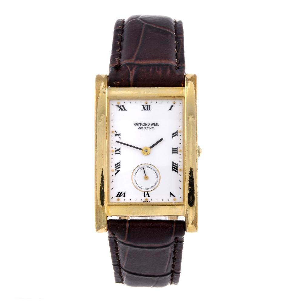

I own a Raymond Weil model 9816 watch bought back in 1992. A jeweller,replacing the battery several years ago, lost one of the original slot headed screws & replaced it with a Philips head type. Over the years,the slot heads have stayed 'good',but the Philps head screws is very worn & the jeweller on my last visit  to have the battery replaced,found it difficult to remove.
   Unfortunately,due to my now having cancer in one lung,i can no longer journey into Manchester to have batteries fitted to my several watches - i'm having to do it myself. I want to replace either the single worn screw & all for of them with new slot heads. Screwed on backs are no problem.
   I contacted the Raymond Weil repair guys & they want £19.99 for a single screw,& a further £12 each for the 3 others. Is there any way of finding out the size of the existing screw ?. I have a micrometer which will give me the overall length,the head diameter & the screw length diameter - but it's the thread type that i'm bothered about. Being a Swiss built watch,it'll obviously be of a metric size.
  Any help would be invaluable - i'm trying to put the watch back ''as it was' originally. Othe than the 'rogue screw' - it's in excellent condition.
