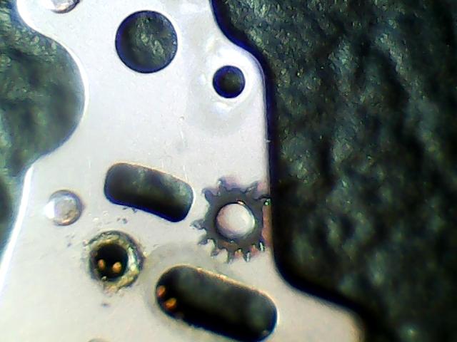

Hello guys..
My Rolex precision oysterdate date won,t change
It stuck on 30 and won,t change even i try to set time to the next day.. and the next..
What happen to this watch?
Thankyou
There’s a significant chance that the wheel that flips the date broke off.

Thats what I’m thinking... the teeth broke off.
Can be many different things including the setting mechanism like the yoke or other elements may have become uncoupled. But the fact that the date doesn’t change either by quickest nor by advancing the time tells me it’s something at the calendar side.

Hi,
My brother had a Rolex Oysterdate movement 3135 that did the same thing.
It would sometimes change, other times it would not.
Mechanism is probably the same.
A gear broke several teeth. See attached pictures.
***16.jpg was a Rodico picking up some of the fractured pieces
Hope this helps.

I think the problem is the date wheel broke off,uncoupled from the lane maybe..
Cause if the gear teeth broke(like your pictures)it can still moves maybe after 2 days or 3 days,sometimes change
But what happen to mine is it won't change at all,even after i tried to move to the next 2 days or 3 days it still stuck in there date 30 and wont change to 31
