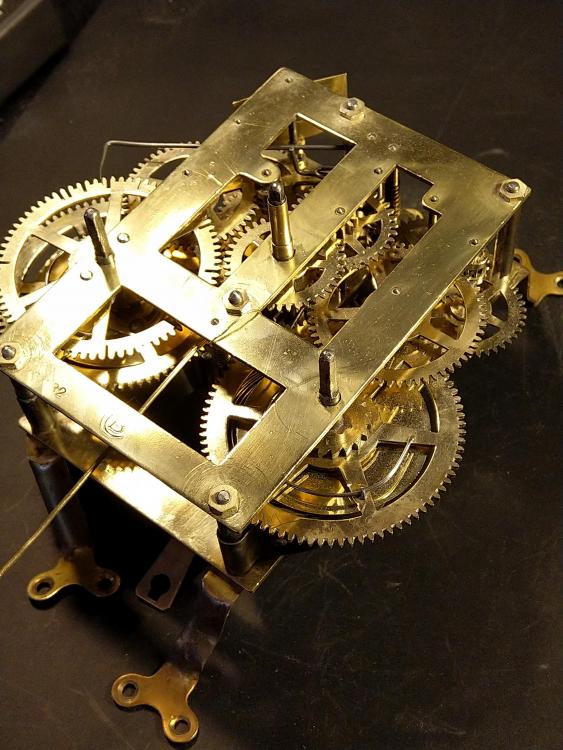

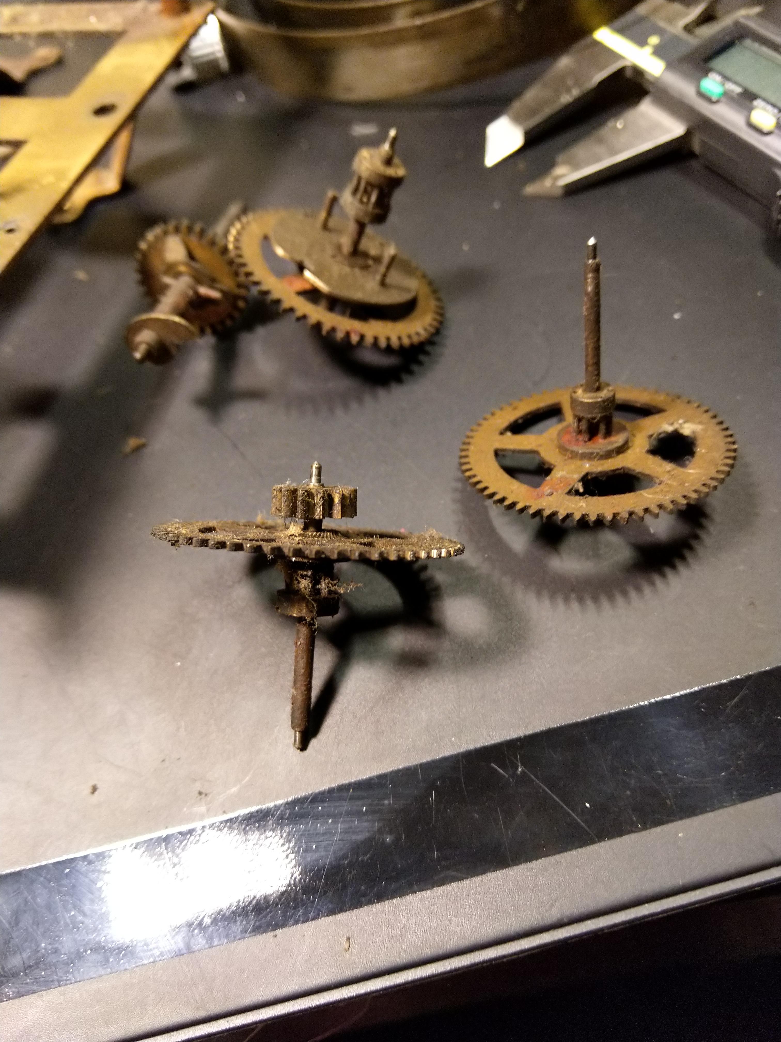

Okay done reading and got a practice movement the other day. It's obviously a German Badishe of some kind but seemed to be easy enough for a start.
Here are some pictures of it but unfortunately I got so excited tinkering with it I forgot to take more pictures.
Hi  Hsl   Clocks are just as much fun as watches and can be as frustrating, You have done a nice job on that one,   Satisfying isnt it bringing one back from the dead. you will be hooked now
