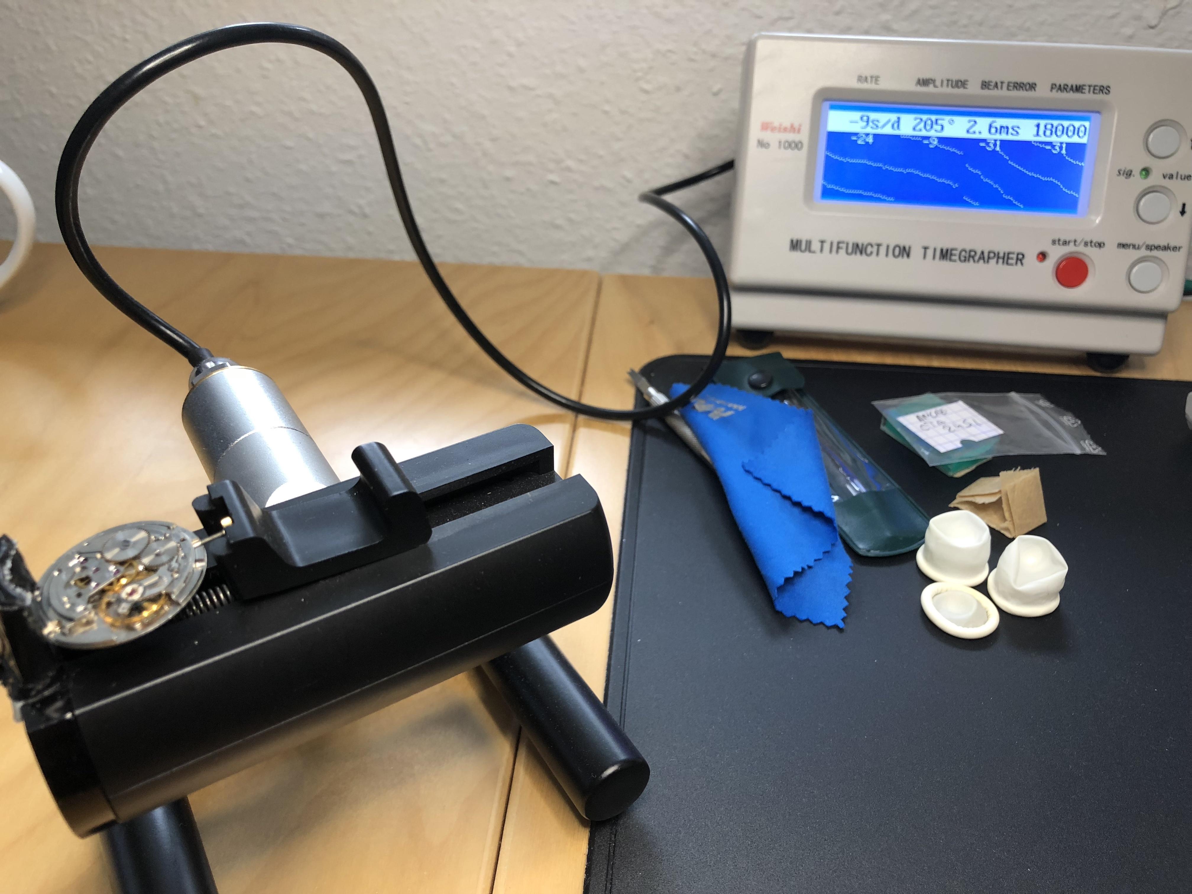

I did a full strip-down of this movement and properly cleaned its parts with lighter fuel. Before the "service" (if you can call my first real service of this movement like that) the amplitude was at 160-170°, which wasn't exactly great and the watch gained around 60-70 seconds a day (according to the time grapher).
I tried to follow all the good advice from the watch repair lessons, wore e.g. finger cuts which was quite difficult in some situations. In general, I'm quite happy with the result. The movement looks clean and everything was smooth (e.g. train of wheels) when I assembled it. However, the result is not yet good on the time grapher.

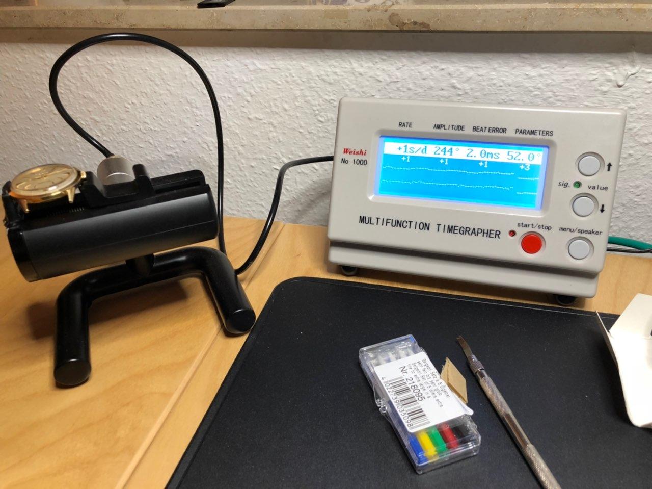

Coming to my issue with this movement, it looks weird on the time grapher where the amplitude travels between 190° and 240° and without touching the watch the watch moves between losing/gaining -35 and +40 seconds/day "in waves" on the time grapher.

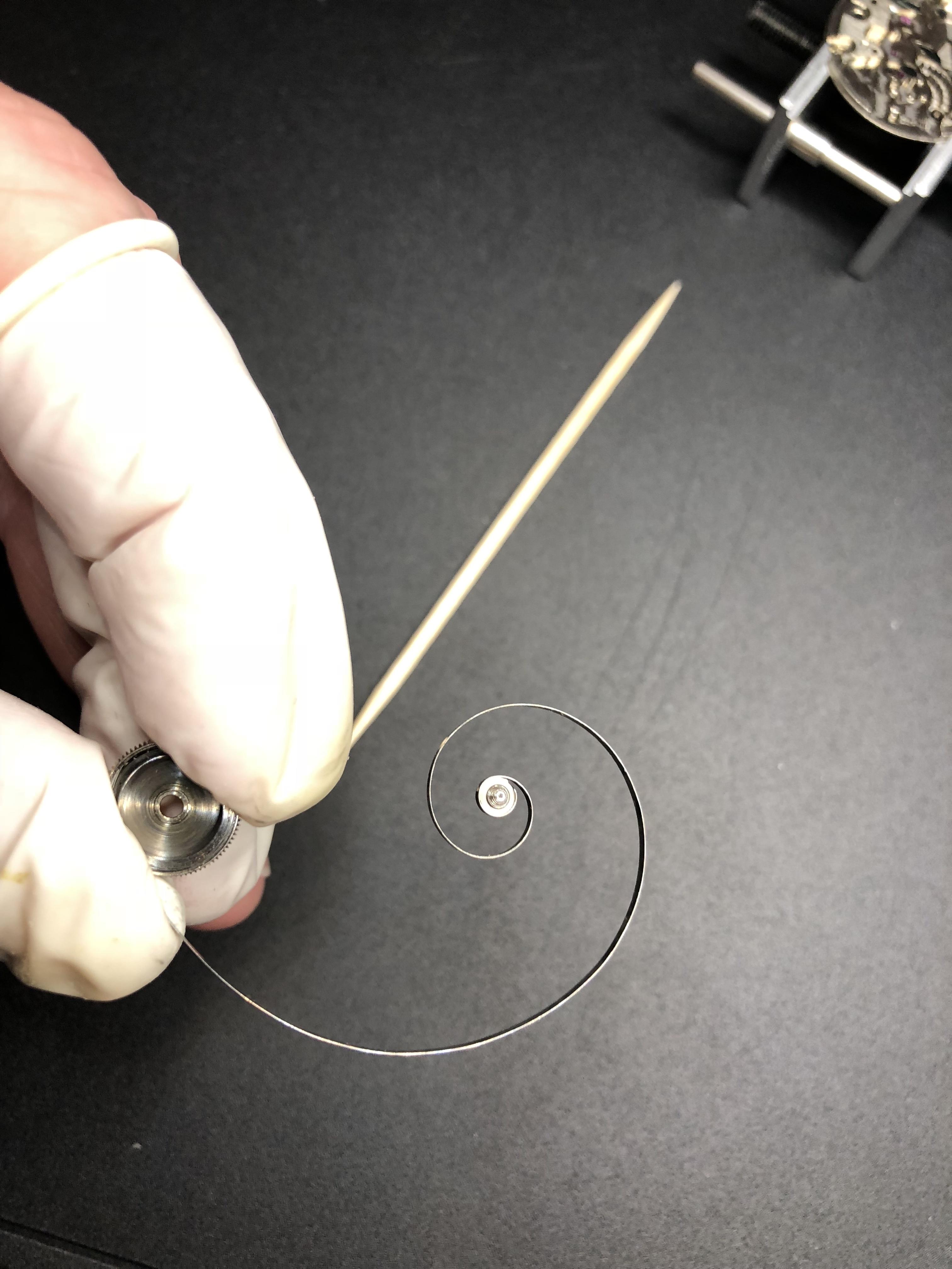

  • I wound the mainspring in by hand and honestly this wasn't something that went well. I've already tried numerous times to get hold of a mainspring winder, but they're quite sought-after on eBay and up their price in the last seconds of the auction by exponential means
    • The issue I had with the mainspring was, that I didn't do this before and I first tried to wind it by hand and hold it by hand and later on put it into the barrel fully wound. This wasn't only very exhausting, but the skin of my fingers (yes, I couldn't use finger cots at this attempt - as it drove me nuts) at thumb and index finger started to be injured (at least you see, there is a lot of passion :))
    • The attempt afterwards was more successful where I cleaned the mainspring again and wore finger cots and wound it into the barrel directly starting at the outside walls
    • Note that the mainspring didn't look very good, when it lay on my workbench (it looked "too set") which was likely caused by my first winding attempt

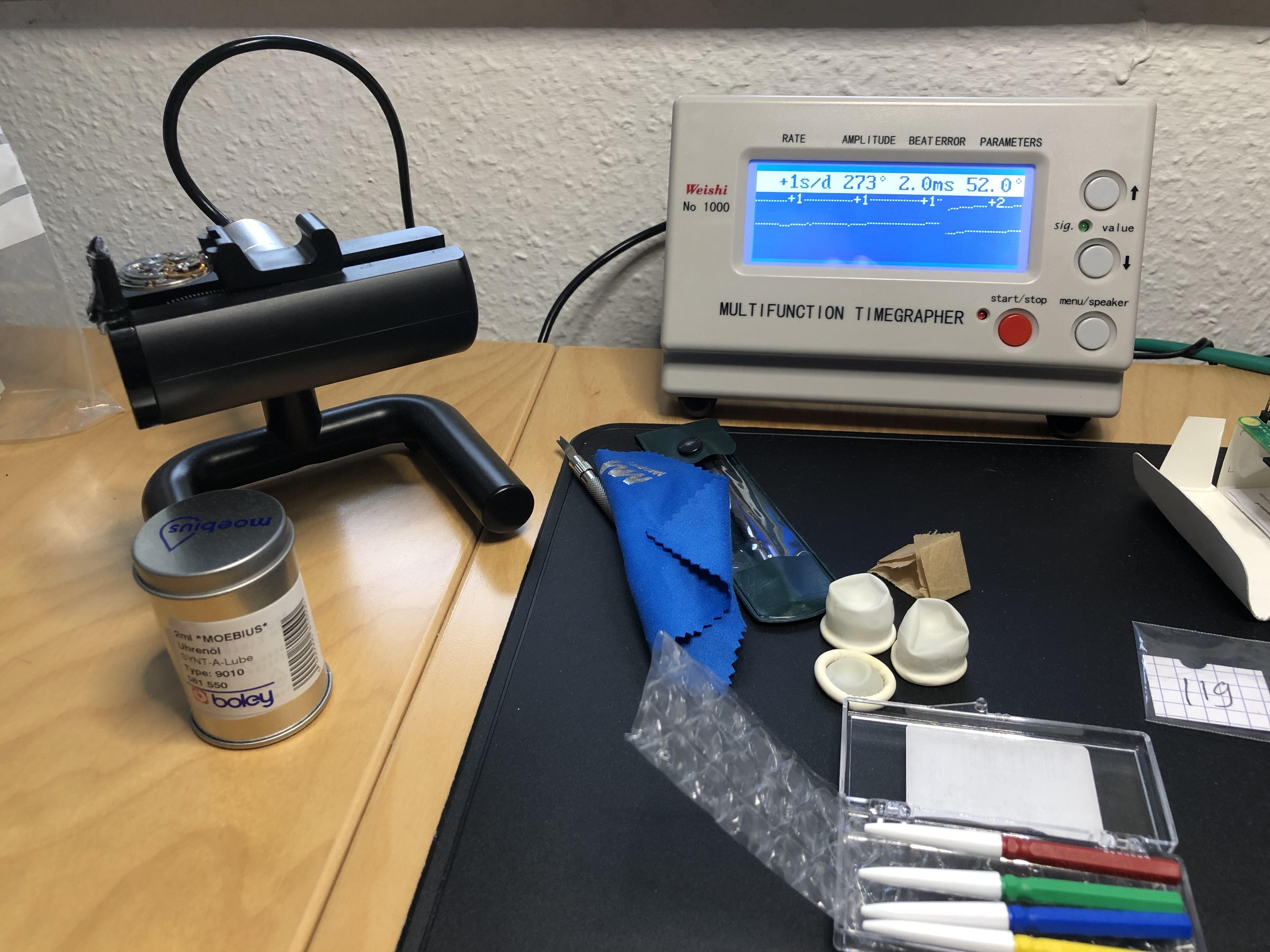

  • The balance pivots (incabloc endstones) are not lubricated yet
  • In general the lubrication looks much more simple job when I watch the videos by Mark (I take it as a positive, that the amplitude reading is better after my service)

Now that you know the issues that I'm aware of, the following is my list of things that could cause the issue I see on the time grapher. I'd like to hear your opinion/advice what you believe could cause this weird reading.
  1. Magnetism, I should demagnitise the watch movement (which I currently can't, as I don't have a demagnitiser yet - am about to acquire one via Amazon)
  2. I might have damaged a wheel during cleaning (all looked good to me) and it doesn't run evenly good, depending on the position in the train of wheels
  3. The mainspring is causing this issue, as it doesn't provide "steady power" and thus causing this issue (I'd more expect an issue with the power reserve though)
  4. The beat error is too high for my taste, but I have difficulties to adjust it (I'll look at this in detail again, it is not the source of the timegrapher waves in my opinion)

Thanks for your feedback. I just finished doing so (as I also wrote) and I'm really impressed by what magnitude of a difference it makes. I thought it would be better, but that a dry balance causes such a big difference was out of my imagination.

@Nucejoe the reading on the time grapher was throughout a few minutes, not hours or days. After oiling the balance, it looks much better
@jguitron Ok, so I'll not use lighter fluid any more. Is Würth Brake Cleaner a better alternative? I thought that it is good enough, if I clean everything with pegwood afterwards. I do have a small ultrasonic bath, but I don't have the good cleaning liquids apart from lighter fluid & brake cleaner. If I'm leftover with fluid that is harmful for water, I'll have trouble to get rid of it afterwards.
[mention=4872]Nucejoe[/mention] the reading on the time grapher was throughout a few minutes, not hours or days. After oiling the balance, it looks much better
[mention=2432]jguitron[/mention] Ok, so I'll not use lighter fluid any more. Is Würth Brake Cleaner a better alternative? I thought that it is good enough, if I clean everything with pegwood afterwards. I do have a small ultrasonic bath, but I don't have the good cleaning liquids apart from lighter fluid & brake cleaner. If I'm leftover with fluid that is harmful for water, I'll have trouble to get rid of it afterwards.

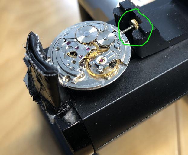

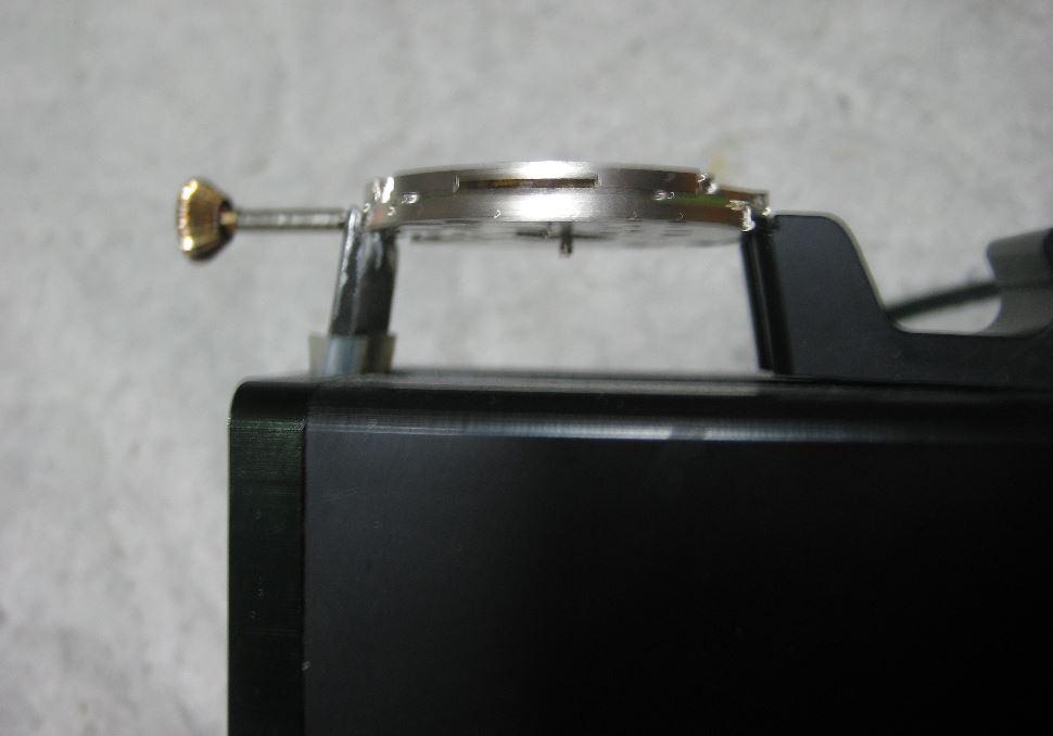

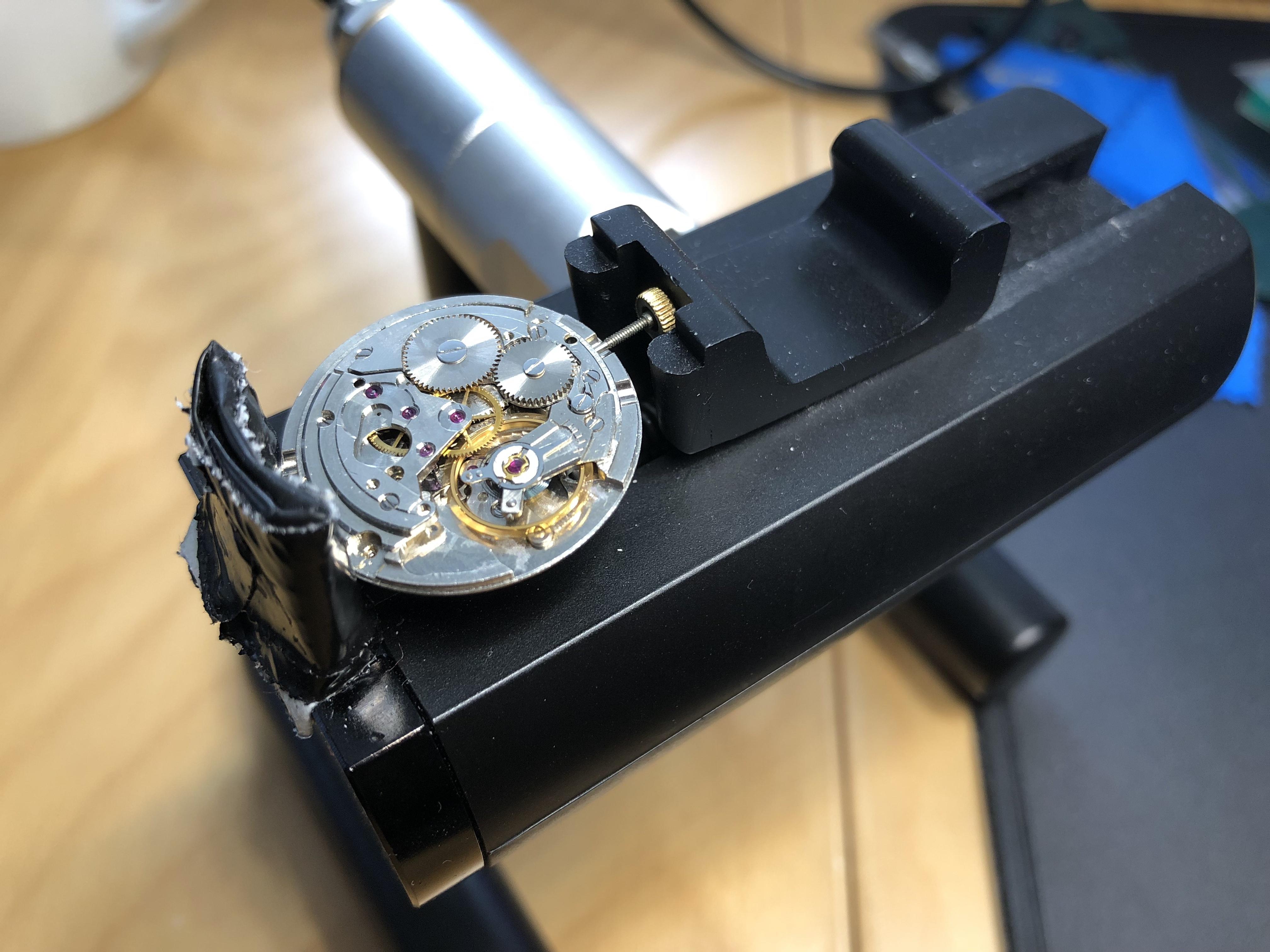

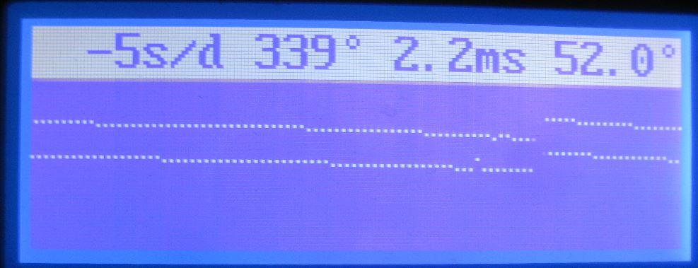

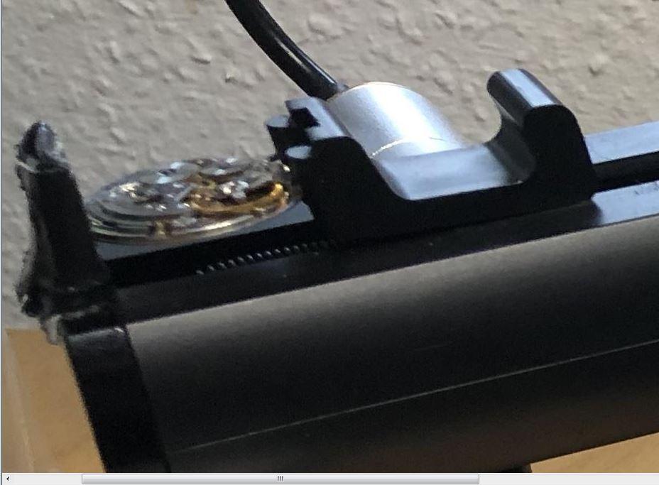

I'm curious about how you're holding the watch in the microphone? So I snipped out the way you're doing it and I have a sample of the way it's supposed to be done so is there some reason why you're doing it this way? Then I noticed the other way you're holding it where it appears to be your pushing on the crown? The jaws of the timing machine are quite strong pushing hard on your crown which is pushing on the stem isn't really a good thing to do.
So many questions and so many problems.
Then it's amazing how much power is lost through the gear train and escapement if it's not properly lubricated. Then totally wrong lubrication can be worse than no lubrication at all neither of which is desirable if you're trying to get your watch to run properly.
The beat error? I'm attaching an image same timing machine different watch so you can see what 2.2 ms looks like. Your lines look like they're too far apart for the error they're producing? Then from the link below is references that later versions of this watch have a floating stud? If that's the case putting this watch in beat should be really really easy.
Mainspring someday you'll have to put breaking grease on the barrel wall but that's not going to be an issue or problem right. Modern new mainspring are prelubricated it's an invisible lubrication unfortunately for the most part. But as you've cleaned the mainspring it now no longer is lubricated you probably should put some lubrication on it. From the list of lubricants you currently have you could use D5 on the mainspring. Then your description of it doesn't look too good? Everything you do to screw up the mainspring ripples down to the balance wheel. Besides the usual cone shape that you get from hand winding were there any kinks or bends in the mainspring?
Then when timing more than one position is desirable. Your currently resting on the end of the balance pivot the least amount of friction so at least one pendant/crown position is desirable. A wristwatch crown down works fine.
@JohnR725 Good observation there and I'm sure this is part of the issue I observed. I haven't had the time to get back to my watch yet - need to do some work. I didn't notice the notch yet, in which you installed the movement - will try that out. Thank you.
I usually installed the watch like that, when it was cased in, but then the case supported the overall structure of the watch and reduced the stress/tension on the stem. I agree that this wasn't my brightest moment, but fortunately I noticed it myself as highlighted above.
