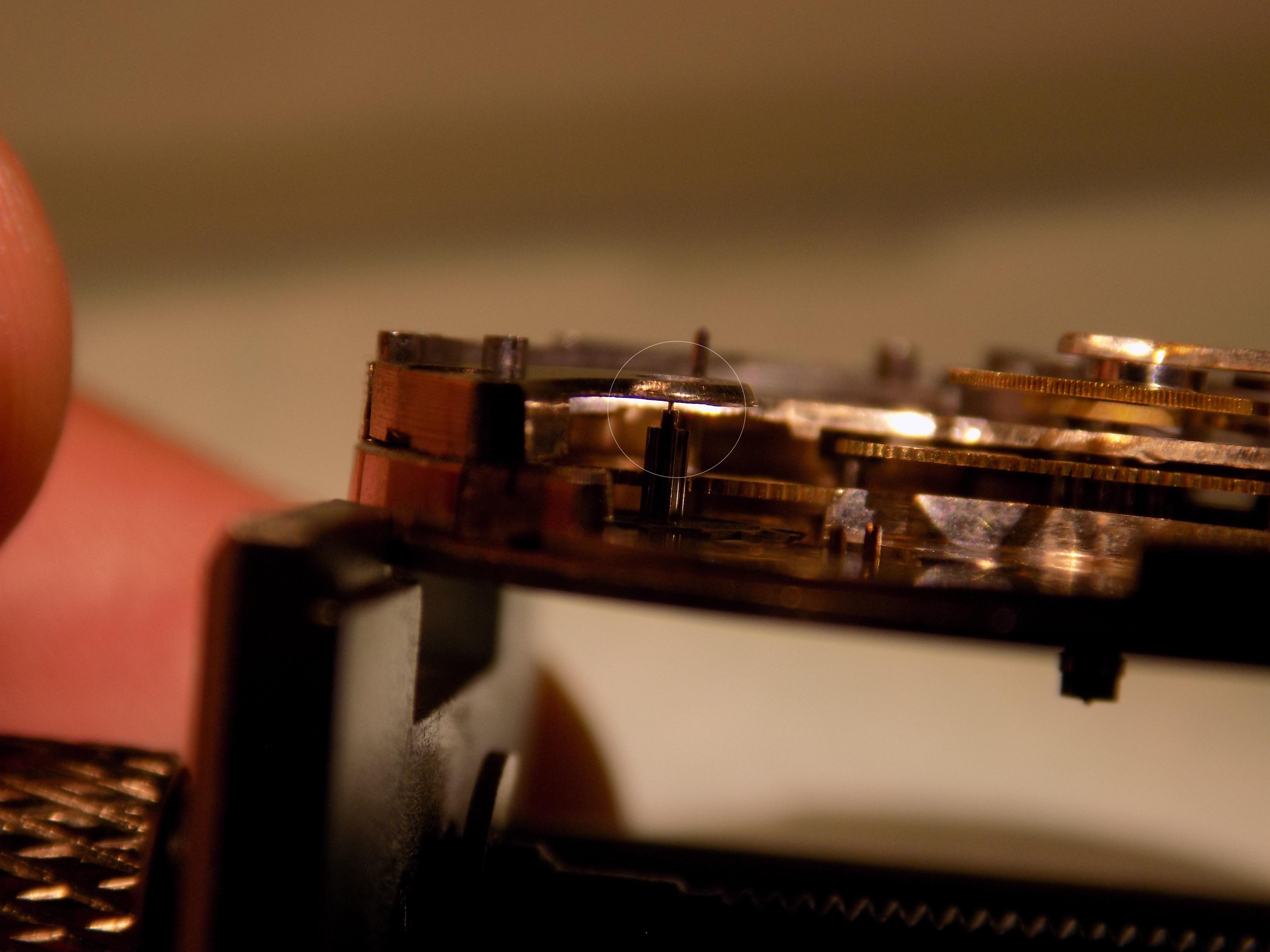

Hello,
Yes, I've cleaned, oiled and reassembled the entire movement. The plate pivot was the one that is broken 1523830931_ScreenShot2018-09-19at2_48_48PM.thumb.png.3839090d10705db228383efd5a912642.png,
so I will double check the jewel to make sure there isn't anything in there. I cleaned it thoroughly, but it's worth checking.
