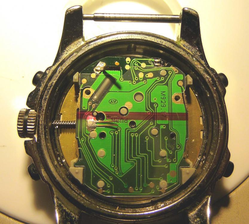

Under the battery perhaps??
Wait- take the battery retainer plate off, and I THINK the sheetmetal protruding over the stem side also retains the stem (but it's just a guess).
If I remember correctly Timex stems are removed by closing two retaining clips. If you remove the battery and take another pic someone will for sure know how.
How about the tan button above the "fork" and below the capacitor?
PS use a toothpick or something plastic, not metal.
PPS It says "PUSH" with an arrow... Push there...

Thanks Tudor.  Sorry, I missed the PUSH.
Greetings,  Bob
