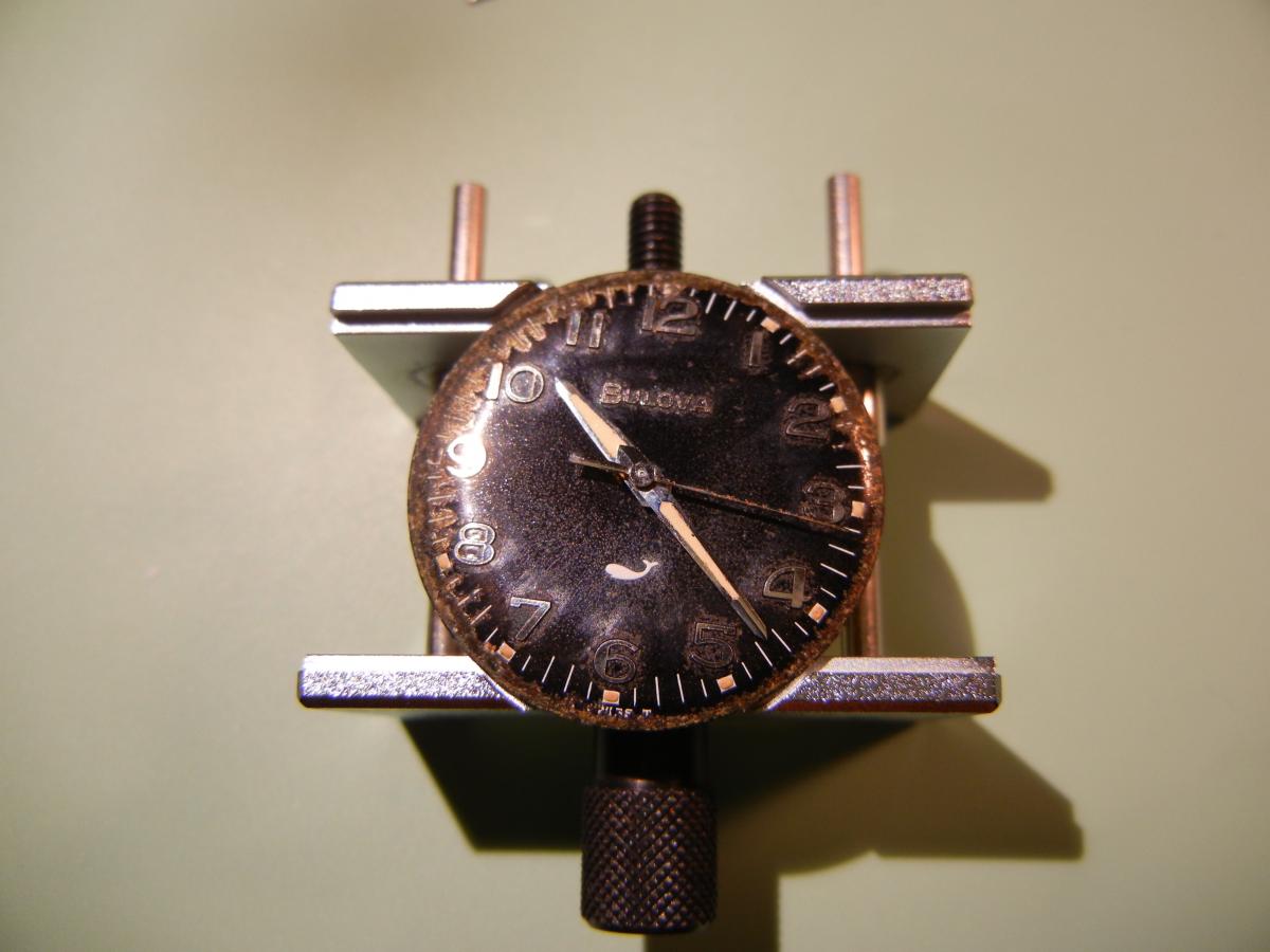

I've been busy taking stuff apart and running around like a maniac as usual and I wanted to post my two latest teardowns and rebuilds.  I have been doing about 3-4 watches a week, so I promise I will slow down the posts atfter these two. First is the Black dialed Bulova Sea King all original:
I did a complete tear down and noticed how nice and shiny the movement looked. I have step by step pictures but won't post them all:post-328-0-75994800-1413518078_thumb.jpg
I unwound, cleaned the the mainspring  by hand (again), and  cleaned everything in naptha except the balance and pallet--those I cleaned in One-Dip. The pallet is very hard replace after removal because the plate is huge and difficult to balance with tweezers--almost said forceps..oops.post-328-0-47951600-1413518356_thumb.jpg
Bulova has an unusual layout  for the train wheel...well, I find them unusual:post-328-0-72317800-1413518458_thumb.jpg

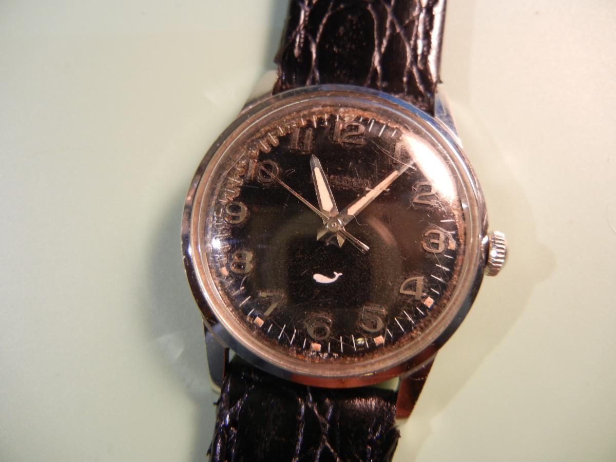

Dial and Hands back on:
And ready for close up:post-328-0-43245600-1413518692_thumb.jpg

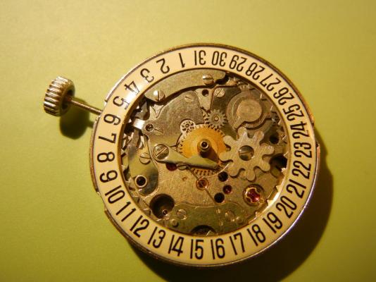

Next is a non-running  Waltham with a PUW 1463 automatic with day and date complication---and I mean it... This thing has parts!
after removing the dial I saw what I was up against:post-328-0-74566400-1413518985_thumb.jpgpost-328-0-89890500-1413519027_thumb.jpg
I continued taking stuff off...looks like it was over oiled!post-328-0-69583400-1413519103_thumb.jpg
When I get to the rotor I unscrew before letting the power down ( I couldn't figure out how!) and it flies off the movement:post-328-0-67132500-1413519234_thumb.jpg
Parts are no longer in order!post-328-0-83825200-1413519328_thumb.jpgpost-328-0-21660300-1413519347_thumb.jpg
I break the mainspring while winding and it flies off (no picture). I buy another and continue to rebuildpost-328-0-17987800-1413519565_thumb.jpgpost-328-0-60143200-1413519618_thumb.jpg
Now I slowly reference the parts carefully and everything falls in place:
I  put the rotor back on and it works!!!post-328-0-24890100-1413519740_thumb.jpg
Now for the dial side:post-328-0-18609200-1413519792_thumb.jpgpost-328-0-12538500-1413519806_thumb.jpg
Recase the movement, the strap goes on...some soft light for the right effect and....ready for action! post-328-0-11240600-1413520025_thumb.jpg
Hope you guys enjoy. The Waltham was a non-worker but its running strong and keeping good time. Got it on ebay for $20.00.
