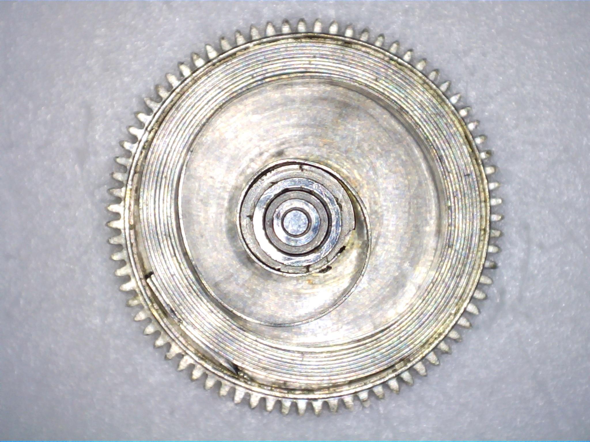

I'm working on one of these at the moment - just fitted a new balance staff today.
I always take a pic of the mainspring to see which way it winds- this is the correct way
I have other pictures I took during disassembly should you need any help.
It's a straightforward movement - there's nothing unusual about the keyless or motion works.
