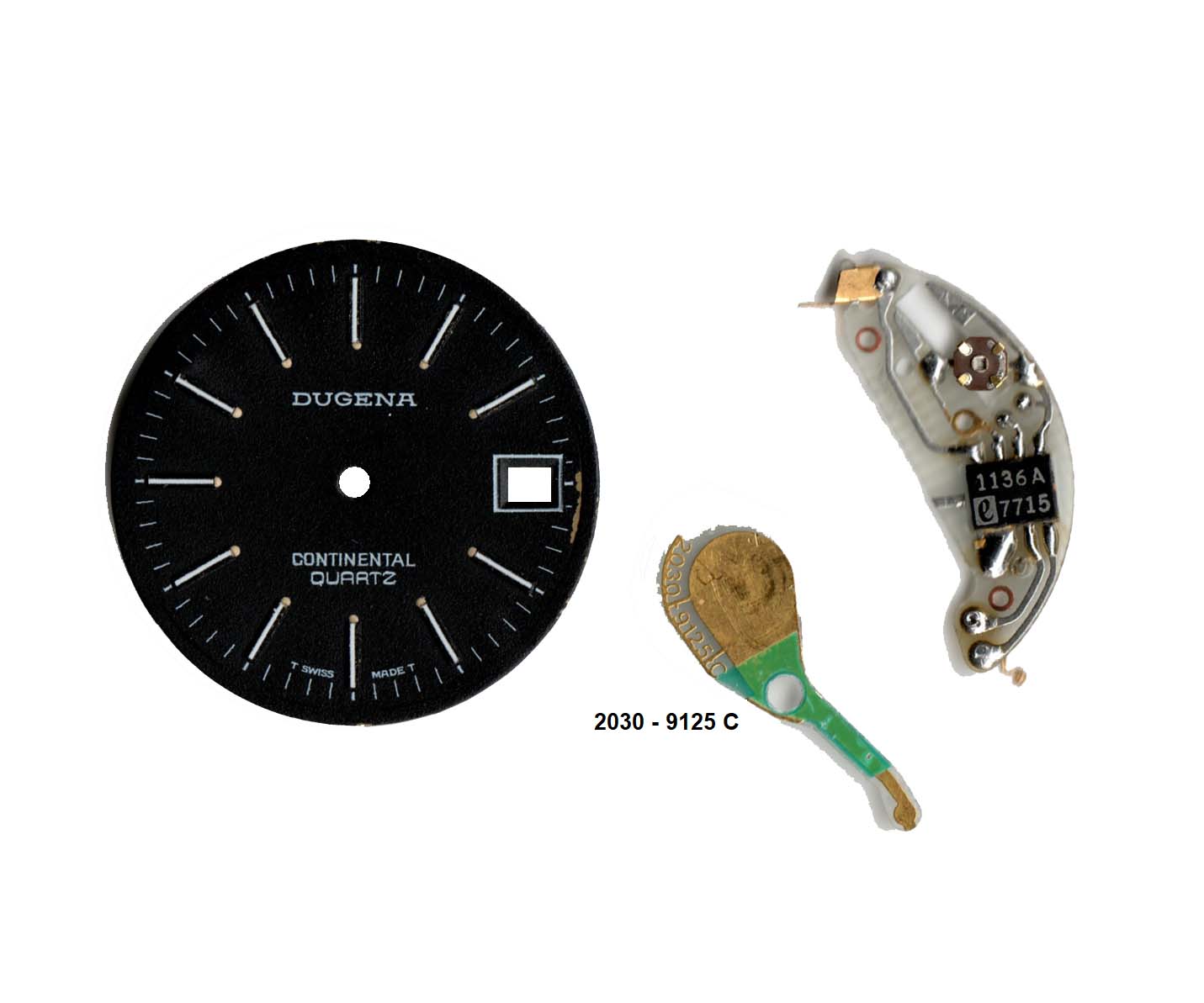

Replacing Quartz Movement in a DUGENA CONTINENTAL 80´s watch
I'm glad it worked out well for you. Must feel good to learn some new watchmaking black magic huh? 😂 Can you post a photo of the crown after all this, I'm a bit interested in how it looks compare to how yellow it was before, never thought alum could dissolve oxidation as well, maybe I can work out the chemistry behind it, something to do with the electrochemistry list, but I'm too lazy for it so 😂 you are lucky it was only yellow, the layer must be so thin it didn/t damage the finishing enough to be noticeable.
By ClaudioCavalli · Posted
Thank you Andy, I will keep that in mind. Fortunately this time, I tried to drill the stem out before finding out about the alum method, therefore most of the stem was hollowed out. When I took the crown out of the third bath, I was able to screw the whole replacement stem in. It us now in the ultrasonic cleaner to get any remaining gunk out. claudio -
