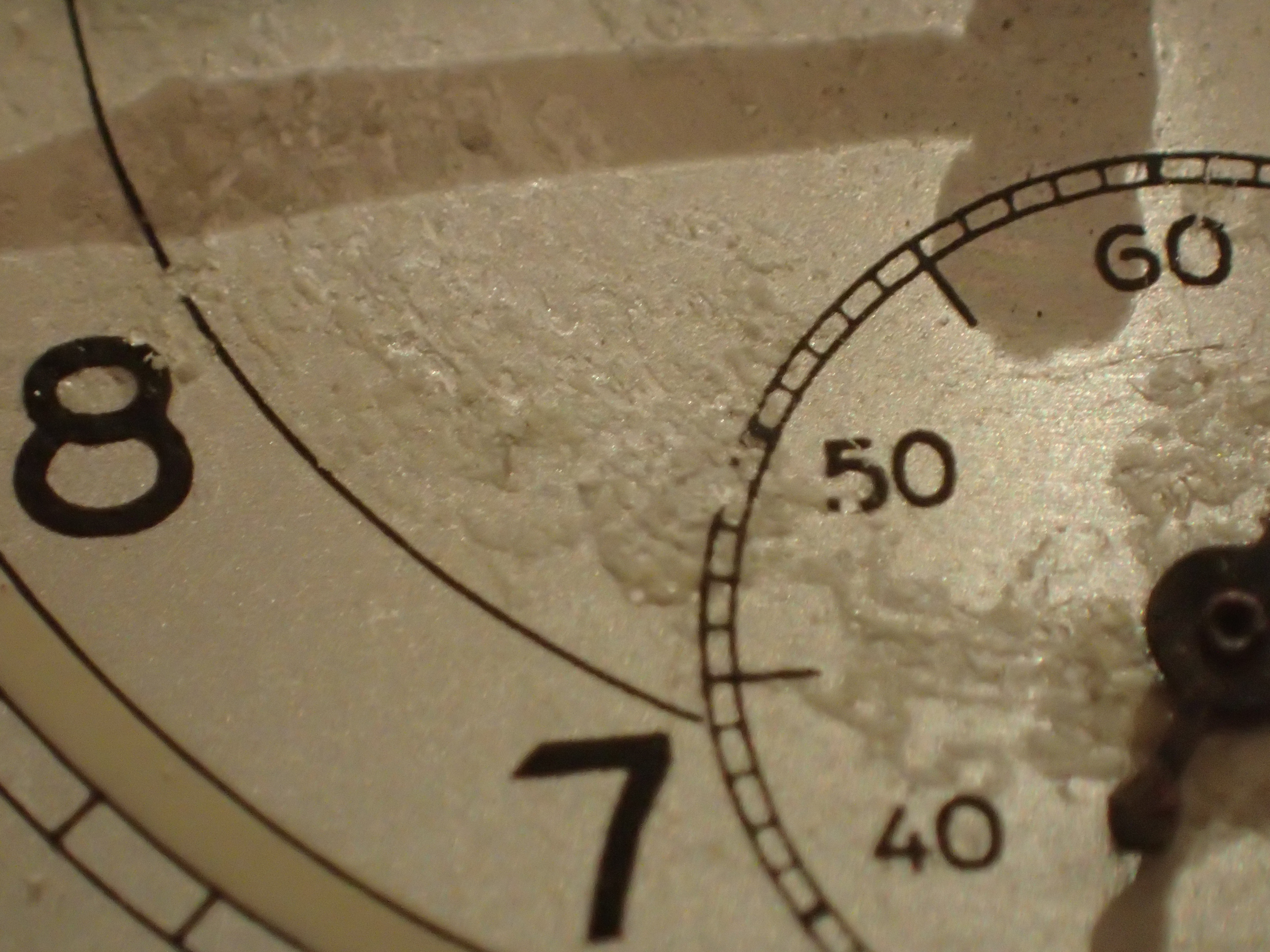

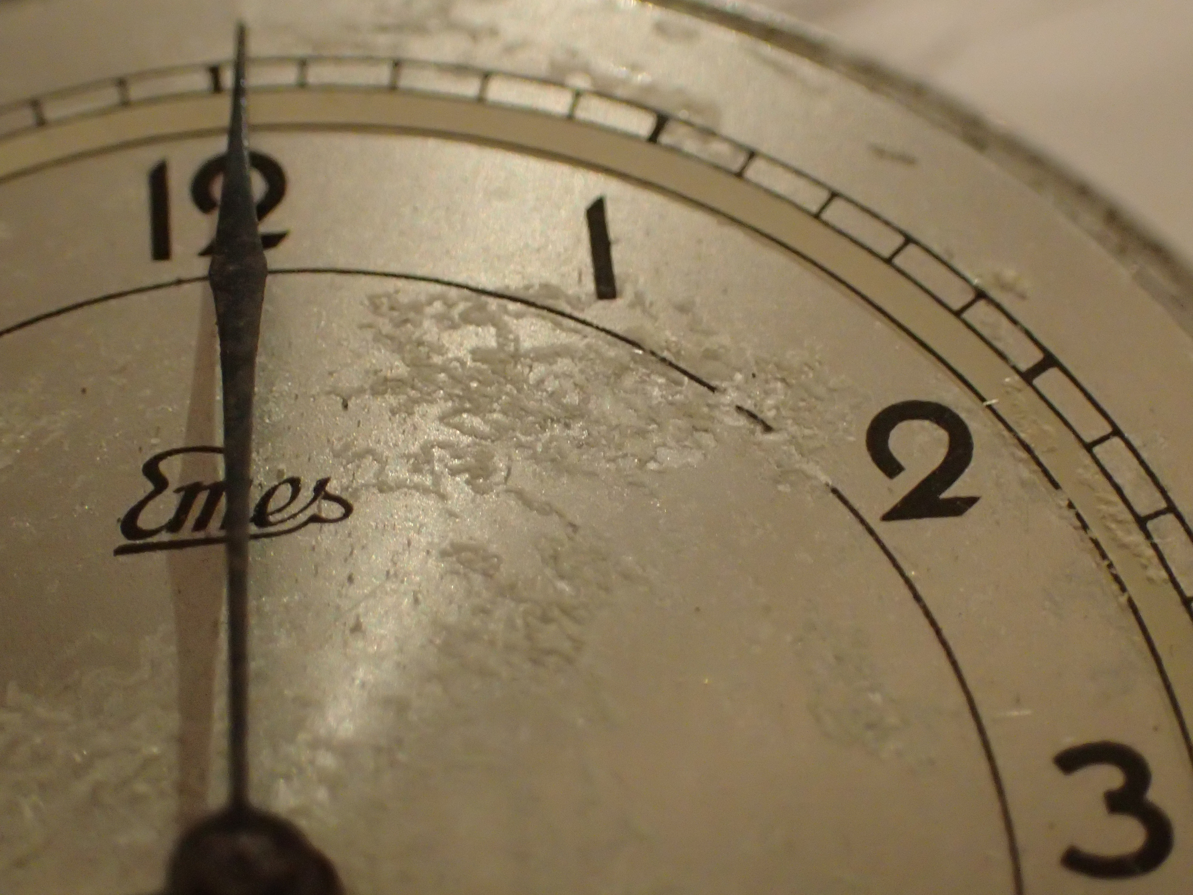

The second watch I bough (£4.50) was a 1930's Emus Muller. It didn't run when I got it and now it does - albeit rather slow (-2 hours/day), still that's better than -24 hours/day!
The dial is aluminium and has quite a bit of corrosion on. Is there a way to treat this?

It could be that there's another layer above the paint... Some had some sort of a transparent lacquer like paint above the paint and engravings/indexes/markers/etc.
But yeah, I'm not sure if there's anything you can do about it... If you were able to microscopically smooth the edges then it would be less visible but that's kind of hard to achieve.
Looks like something is corroding the paint... Short of repainting the dial, i don't see many good options :(
I would try washing it very gently with plain water to remove any possible contaminants, and if the dial survives that, spray a thin layer of lacquer on top to protect/stabilize the remaining paint. No matter what, it will not look new I'm afraid.
Shame.
I had a minute scrap on the edge to see if it was just a surface depsit, but it's seems to be where the aluminuim cas corroded through the paint layer.
I think you're suggestion of a gentle clean and lacquer are about the only options.
Galvanic corrosion from dissimilar metals, aluminum is bad about that. Not much can be done here short of a redial and in that case I'd look for another dial made of brass.
