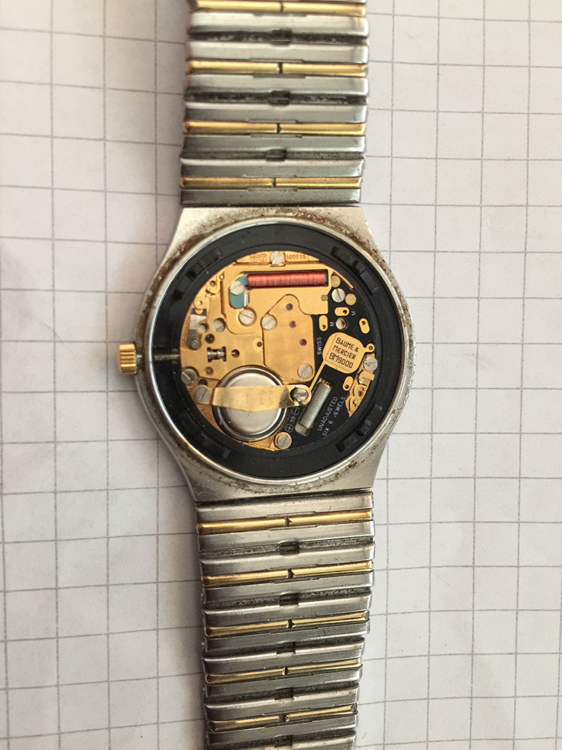

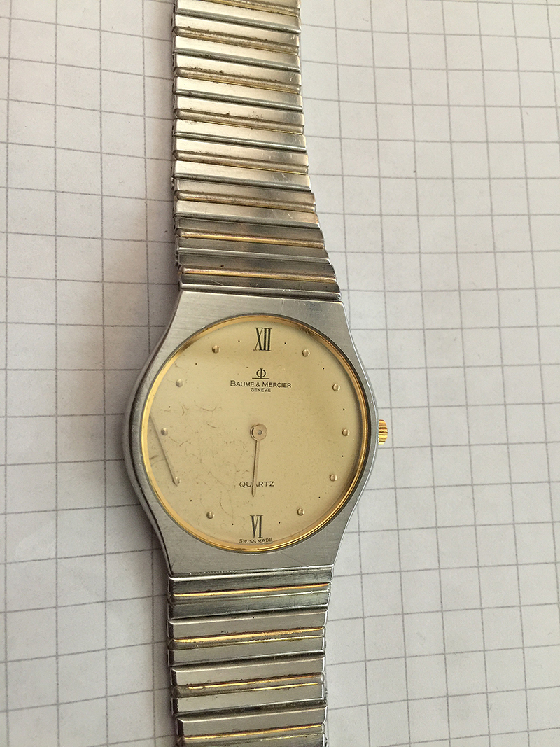

Thank you ColdWind, I did try the alum solution and albeit slow (I am on my third bath of 6 hours at 70° C with a solution of 10ml of water and 2.5g of alum) it seems to be working. I can now screw in the new stem, at least a few turns. I expect that at some point I will be able to screw the stem in all the way. Perhaps next I will try a bigger bath. I wonder if the limited amount of alum is slowing down the process? An happy side effect of the alum bath is that it removed the oxidation from the crown!! claudio -
