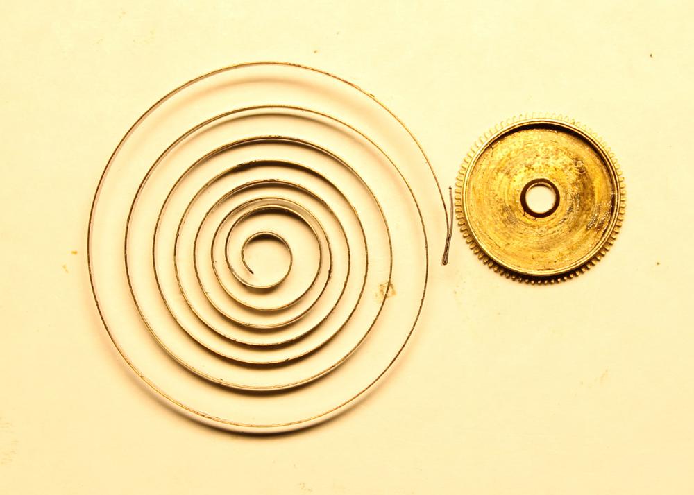

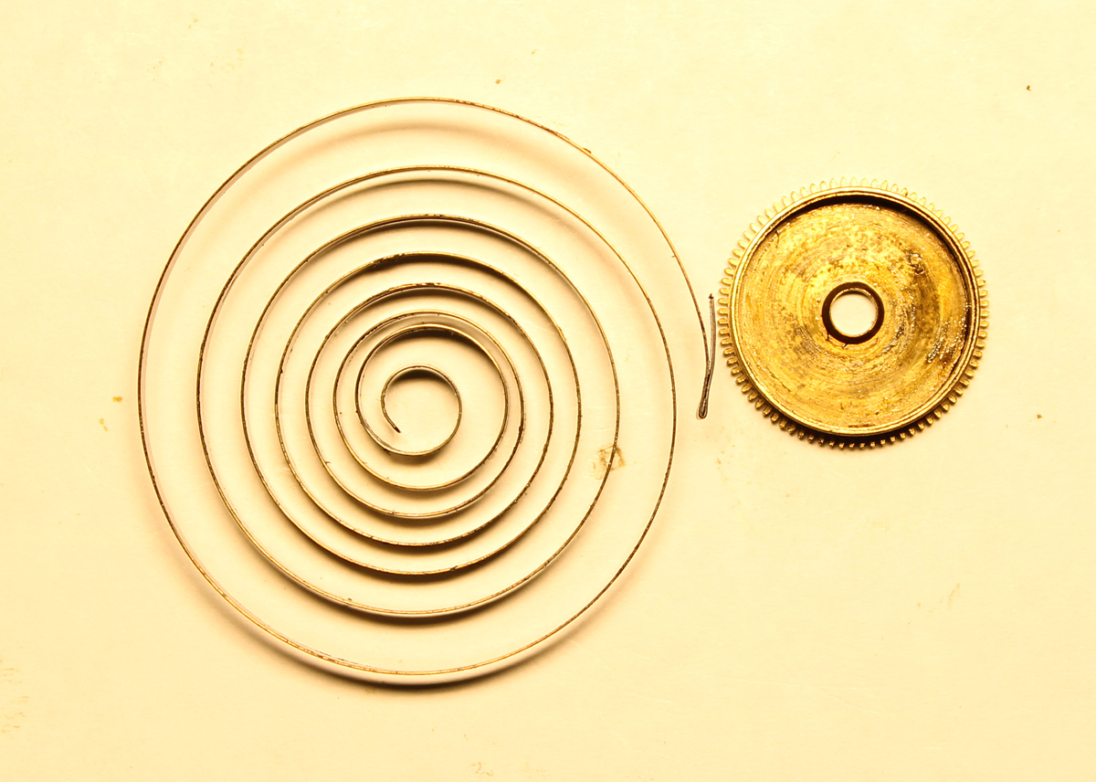

As for the main-spring: I guess the installed main-spring isn't the original and seems very tired, as you can see in the picture below. It wasn't eager to leave the barrel :)
The barrel has a little hook inside, suggesting perhaps a TR-end spring. I have to take some more precise measurements, but if the old spring could service as some kind of reference, the height is 2.5mm, thickness of about 0.2mm, perhaps 0.21mm, and a length of about 440mm'ish . The barrel ID is 15.5mm. If I were to use the David Boettcher "reverse engineering" calculator (http://www.vintagewatchstraps.com/mainsprings.php ) the estimate is: Spring thickness = 0.191, length = 480, turns = 6.3, area = 55%. Looking a CousinsUK springs, 2.5mm high; there aren't any TR-springs and perhaps the GR6702 with normal bridle (2.50 x .20 x 480 x 15.5 Non-Automatic) may be the happy medium between the old installed spring and the calculators estimate? Closer to the calculators estimate is, again with a normal bridle, the GR6685 with 2.50 x .19 x 480 x 15 Non-Automatic.
I’m sure you will be fine with a standard bridle here as per the spring you have removed.

The "reverse engineering calculator" estimated spring was: Spring thickness = 0.191, length = 480, turns = 6.3, area = 55%.
CousinsUK has in my opinion two candidates, both normal bridle; the GR6685; 2.50 x .19 x 480 x 15 Non-Automatic or the GR6702; 2.50 x .20 x 480 x 15.5 Non-Automatic. The non-original spring removed had a thickness of 0.2mm.
Which of the two candidates would in this case be the best choice?

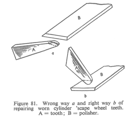

It is very easy to see if the teeth are worn on the escape wheel. Add a tiny amount of power, the balance wheel should start, if the movement of the balance is poor the chances are the teeth or cylinder will be worn. Stop the balance wheel and move it with your tweezers, if it escapes with hardly any movement its worn. Cylinders are so hard and brittle they hardly are scored with wear, if so you are in big trouble. The cylinder is made up of three parts the two end parts are called plugs, plus the main part, which I have always known to be the shaft. You need the proper punches in order to remove the plugs.
@oldhippy Thank you very much for your explanation ;)
As far as I can see, the cylinder looks okay. It's only the tips of two or three teeth whose ends seems to be folded, if ever so slightly. I read about the build up of the cylinder, but having no experience and neither any tools for those kinds of operations; if the cylinder is no good, or the escape wheel for that matter, it may the be end of this exercise / watch. Perhaps, if required, I could slightly touch up the tips from underneath or the "heel" of the teeth.
5a3d3b24eb526_ScreenShot2017-12-22at18_03_06.png.3cf5fb2a10f612363dbf76ea4b720393.png
Reading further in Gazeleys book, chapter "The cylinder escapement", one can go pretty fast down hill if you start fiddling with the teeth. So far, from what I understood, spare parts for this movement aren't easy to find, particularly if one has no clear movement identification.
I’d go with the slightly thinner spring in this case
The GR6685; 2.50 x .19 x 480 x 15 Non-Automatic it shall be ;) I'll order it after X-mas.
