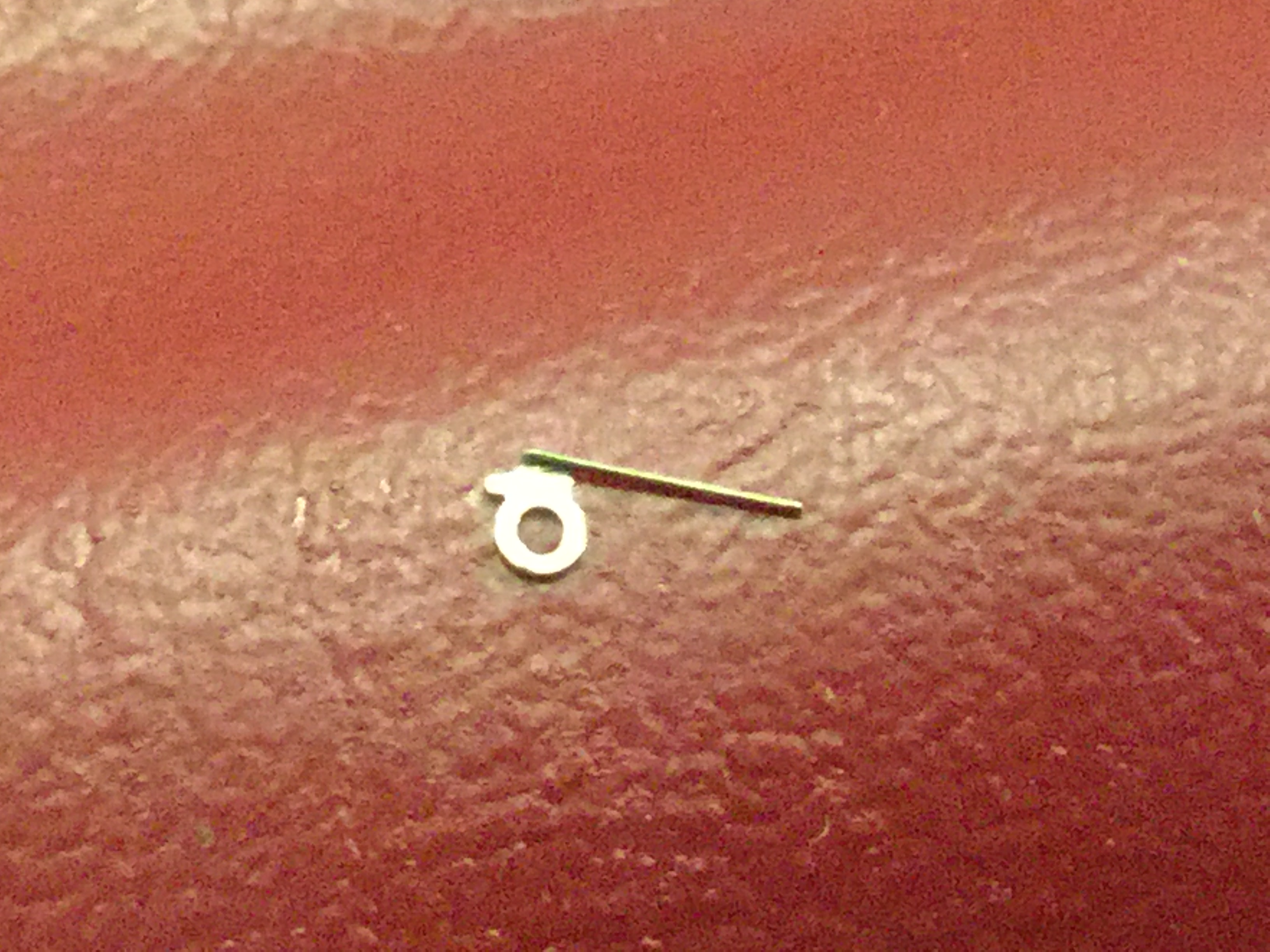

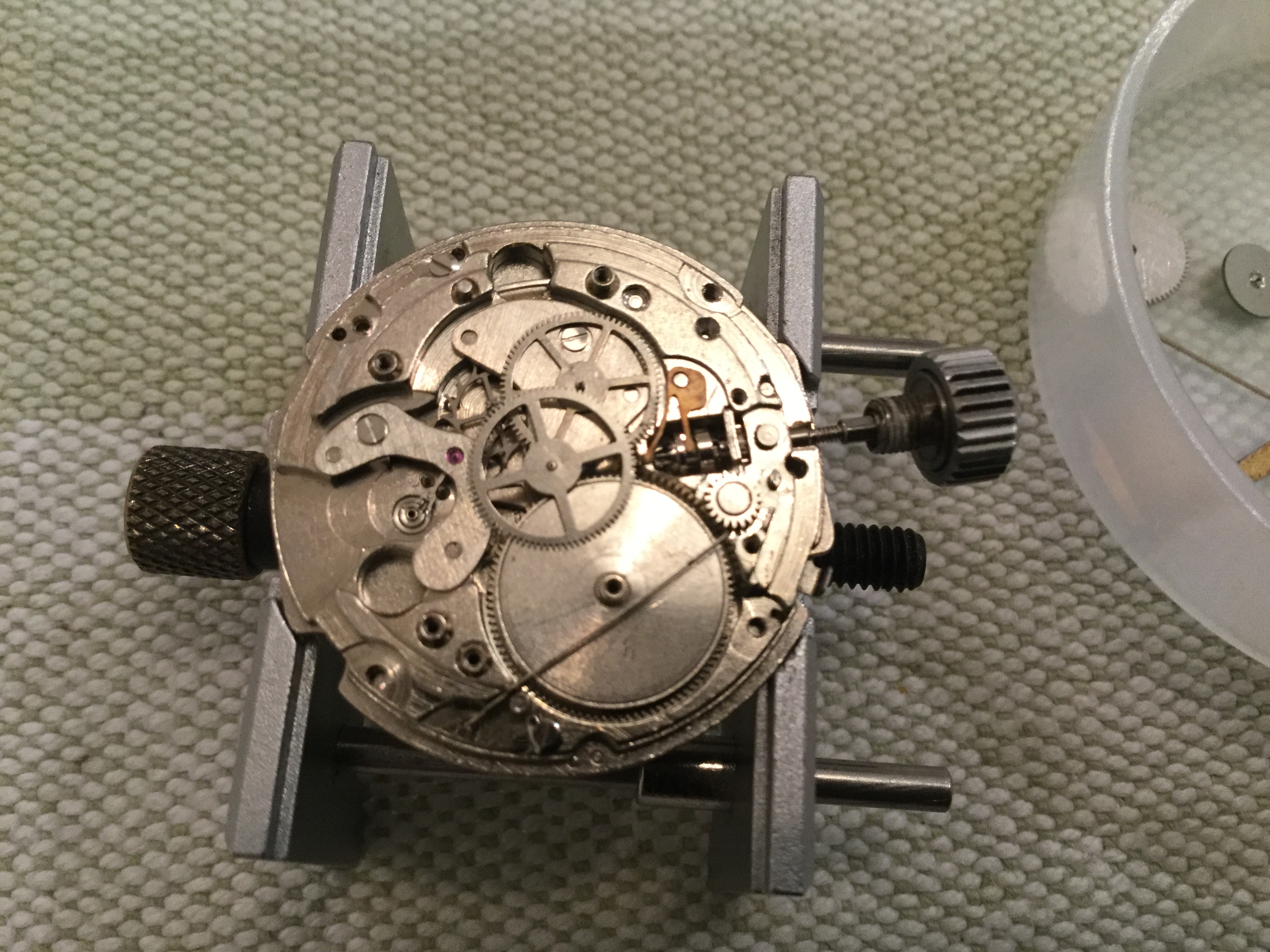

I am practicing on an old Chinese movement and doing fairly well but now have problem - where does this piece go?  So far the project has been successful but I am stumped with this part   I do hope someone can give me guidance on this   Pictures attached .

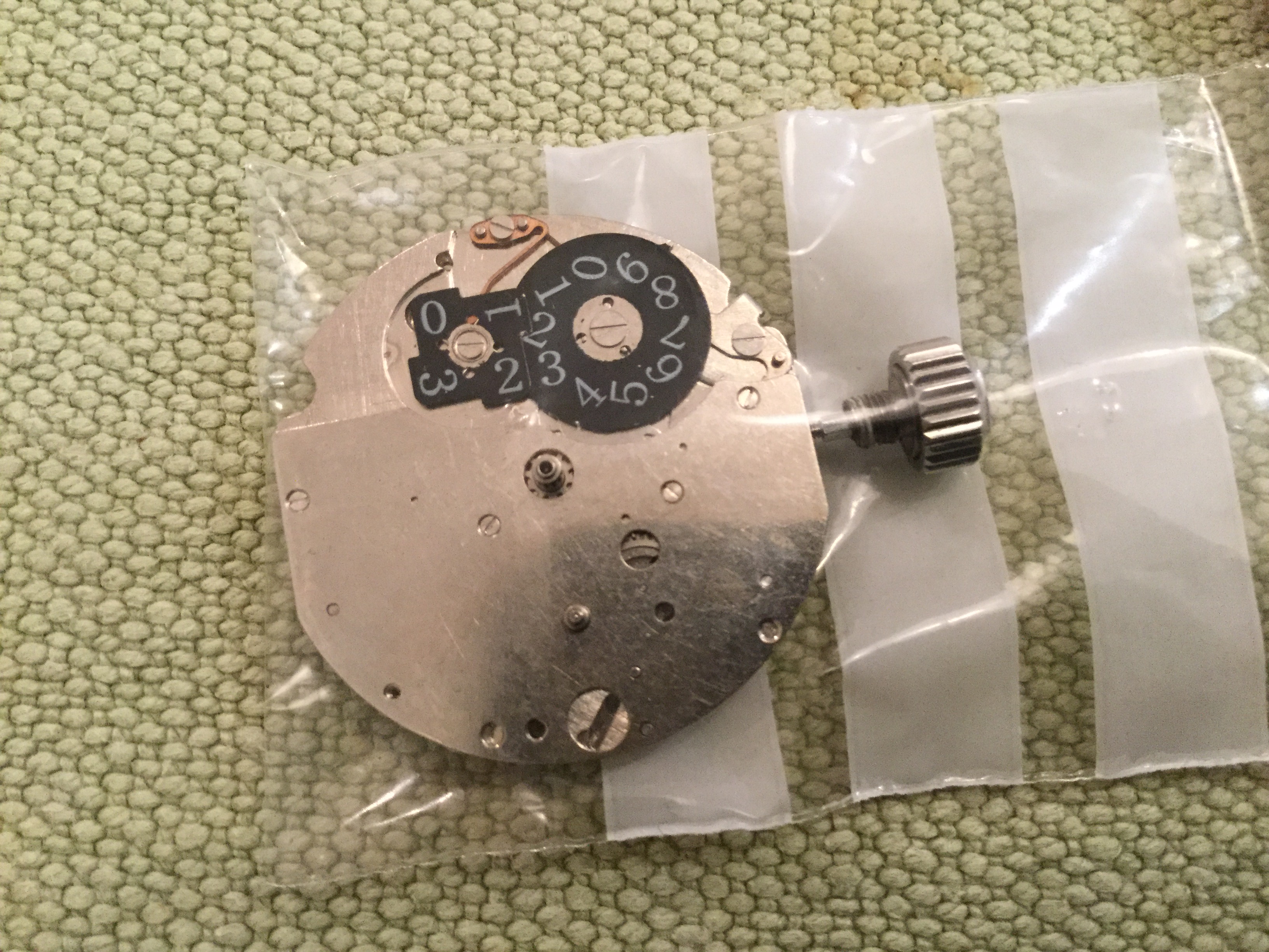

Could it possibly be a click for the 0-9 date wheel ??
Thanks Ricardo, unfortunately no.  Part is from the back of the movement. Both parts of the date mechanism work well and look good.    I guess the click is secured by a screw and there isn't many screw holes on the main plate I've tried them all but still don't have a clue where it goes.
I'm not familiar with Chinese movements but a quick google image search indicates this is an 'SPS24' (or near clone). Unfortunately unless you have better luck than me I couldn't find any decent information or breakdowns for this movement!

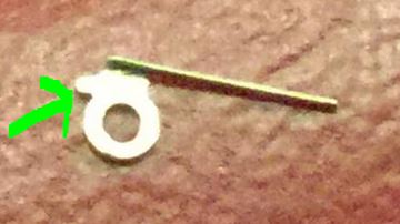

I can't give an answer but the nub (green arrow below) would usually mate with a recess. This prevents the part from moving and allows it to function as a spring better. If this is sandwiched between plates it may not even require a screw. Look under the bridge if there's any hint of where it should go.

I think the movement is by TAO possibly a 200WD. With a GMT at 6.   As for the click/spring looks like the best way forward is to assemble it and check the functions to see what does not work.   If I do get a fix I'll post results.

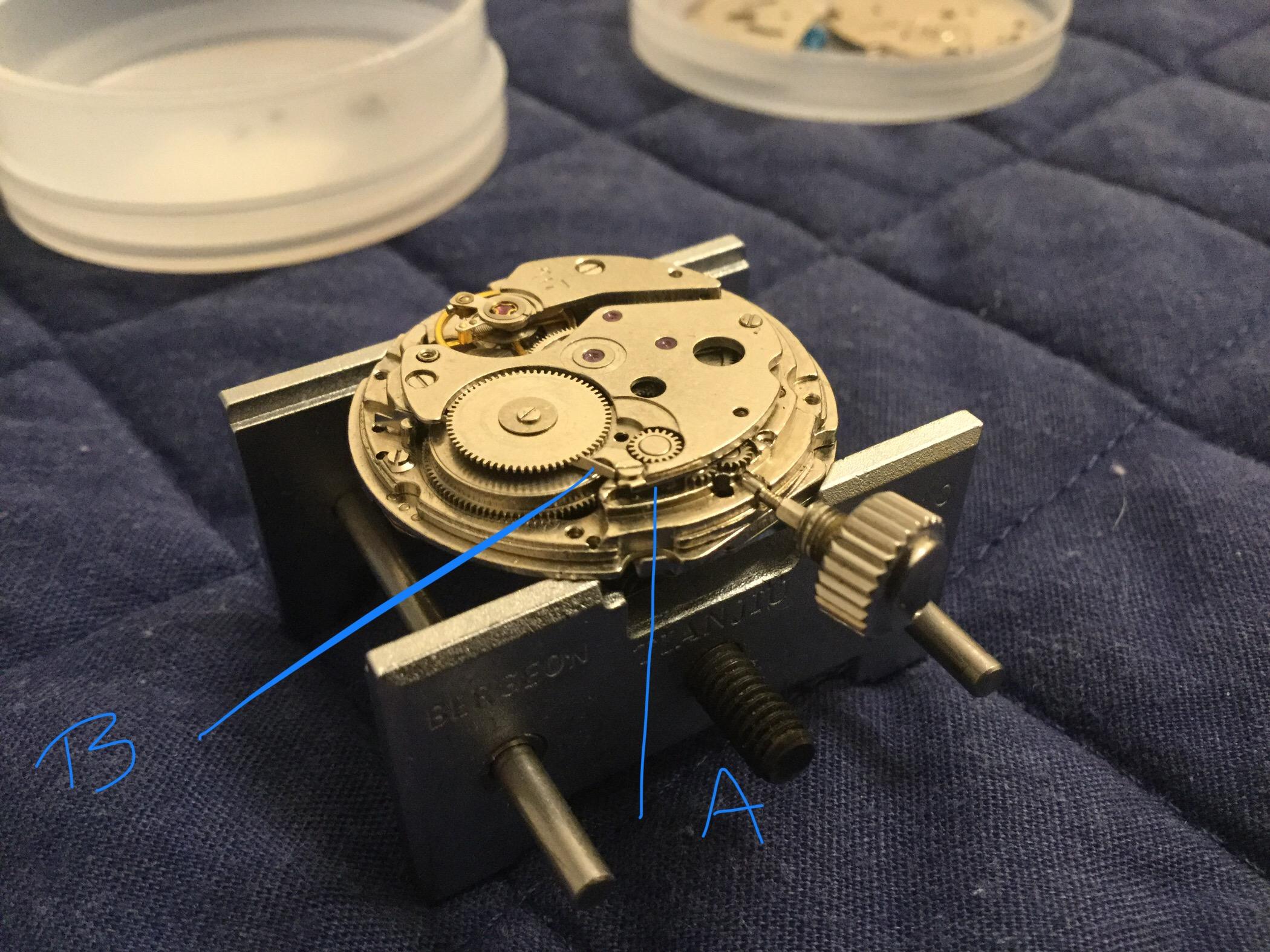

It been about a year since I asked about the location of a “click”   Now sorted.
It the spring to hold the hand wind train wheels in place.  It’s mounted between the main plate and the train wheel bridge.  I’ve attached a picture ... indicated at A.
Movement is as mentioned by wrt addict a Chinese ...it’s aSP16.  Thanks to all for your encouraging comments.

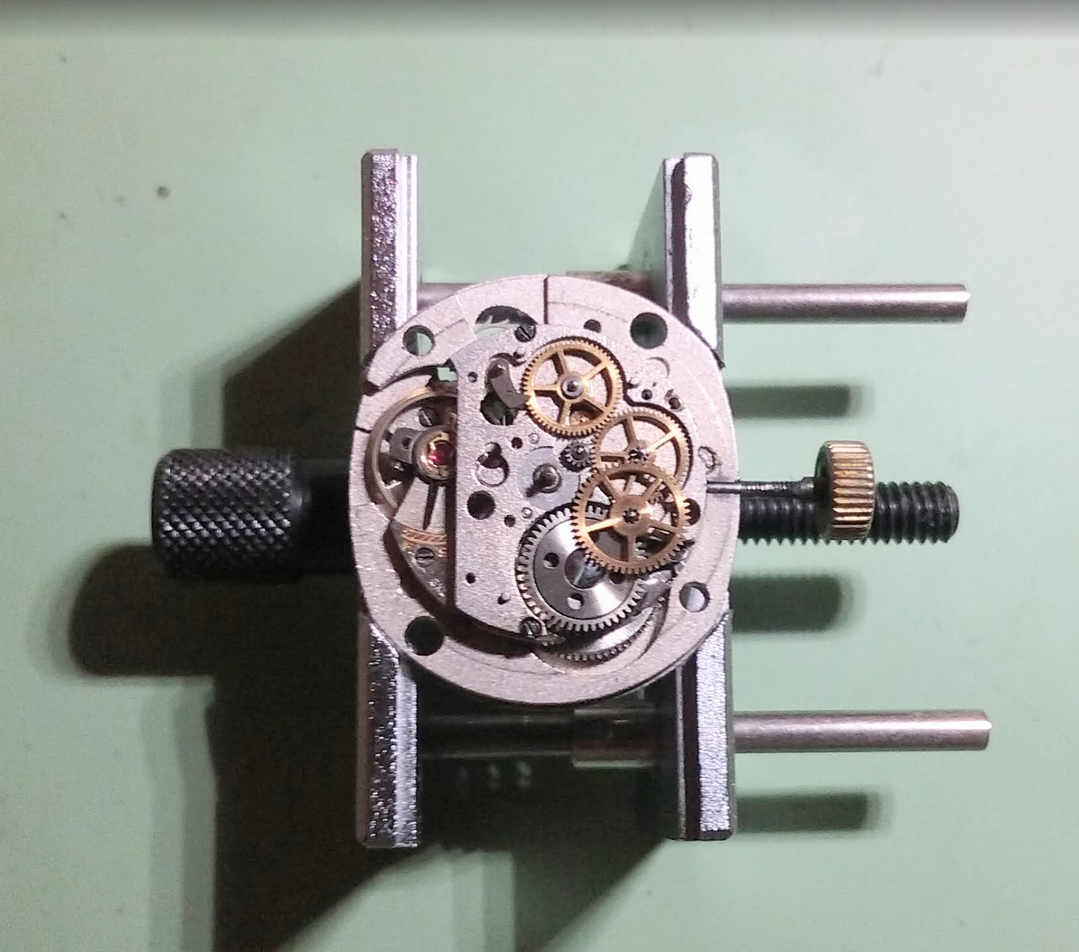

All kidding aside , I am working on a vintage Gruen Precision that is Click City . There is a click for what would normally be the ratchet wheel , but in this case there are 2 geared barrels resembling the mainspring barrels  stacked on top of each other where the ratchet wheel would go on the barrel bridge . Besides the click in the normal position for the ratchet wheel , each barrel has an internal gear with it's own click and spring , and as the pic shows , there is also a click and spring for the gear on the train wheel .
One of the stacked barrels is for hand wind and the other is for the auto-wing with the arbor for the mainspring barrel being common to both winding barrels .
Also , you cannot readily remove the balance cock without removing the bridge on top .
The movement is a caliber 480 SS .
