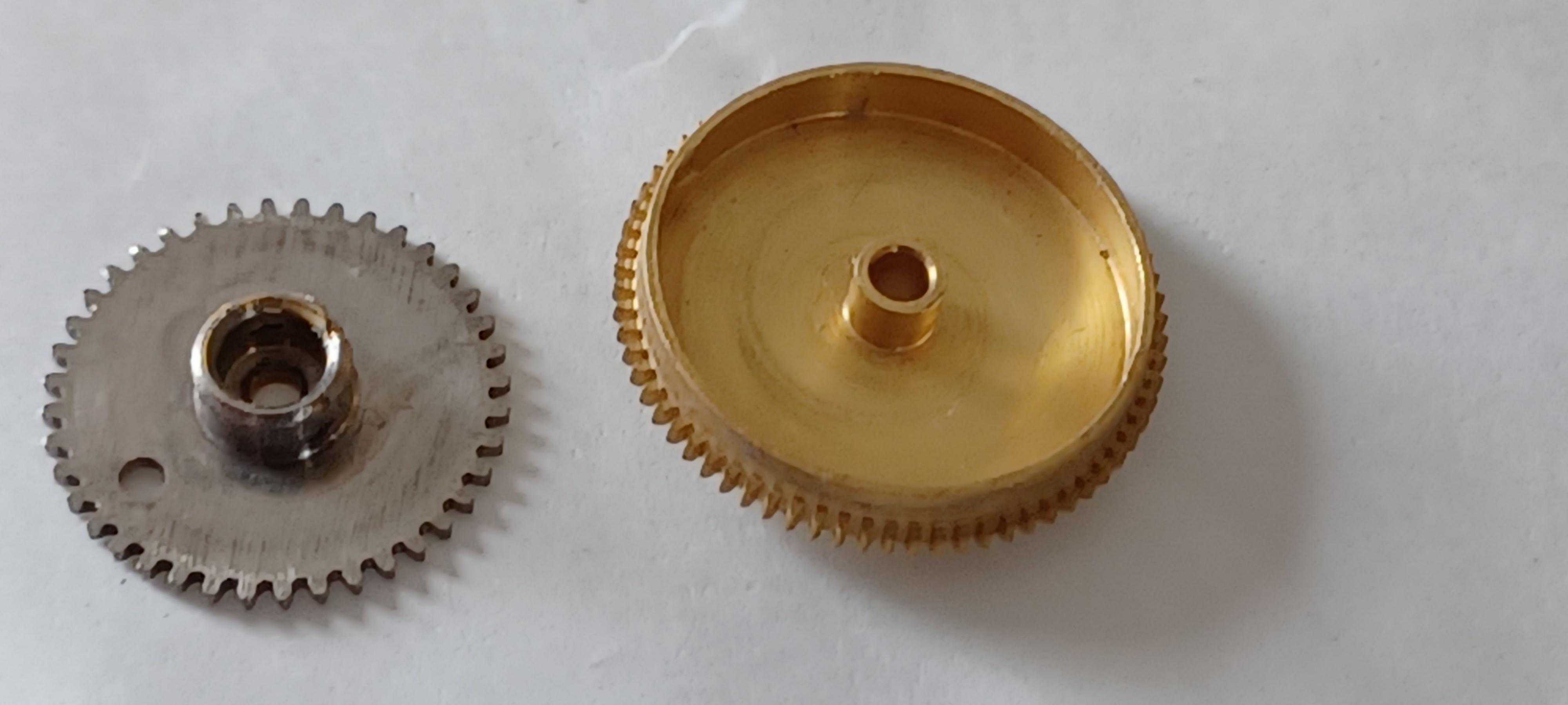

Hello, I realize this is an old post and I considered starting a new one however the situation you described almost matches mine to a tee, and I wanted to know with regards to the mainspring and Arbour situation how you reassembled the barrel with the Arbour essentially attached to the racket wheel because the assembly is basically a blind connection... meaning that you can't see if the mainspring is hooked properly.
I have included a couple of pictures of the situation both with the old broken mainspring installed and then a post cleaning picture.
Any experience on this weird module that you can share would be appreciated. Thanks
