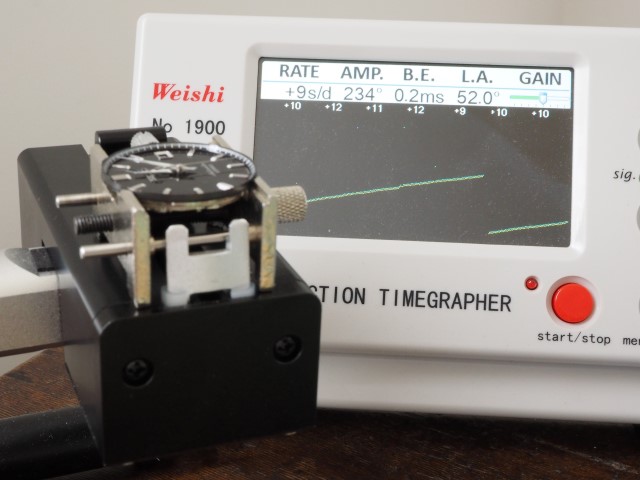

I'm seeing more and more of these, 6R15s almost new which exhibit a poor pattern or performance. This one, manuf. Apr. '14 was spinning 210 deg. face up, dropping to about 170 in other positions. What I do in these cases is let them wind down (to avoid removing the auto bridge), remove balance jewels, balance and pallet fork. Leave these parts 5 minutes in rectified gasoline (got in 1L bottle from an otherwise useless local supplier), applied 9010 to the stones, and put it back together. Takes less than 30 minutes. Picture taken before regulation.

So, after cleaning and oiling the amps remained reasonable?
Expand
Yes, as in picture.

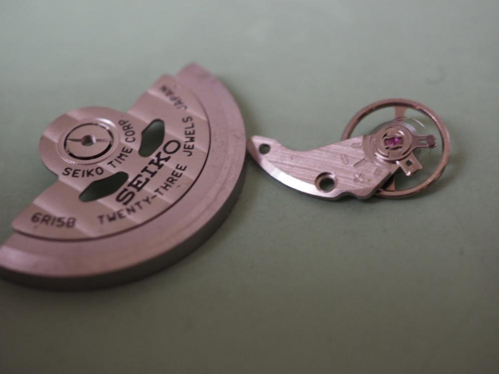

Finishing is simple but very nice. Cotes de Tokio on the rotor,  beveled balance cock, and few more details.

WRT to the finishing, well the pic you posted of the balance wheel cock says it all. Is it acceptable?..yes in the sense that it doesn't affect the efficiency of the watch which works extremely well. But I prefer the finishing of the older movements. Additionally the pressed in posts which Seiko started using in the 7s26 really bugs me.

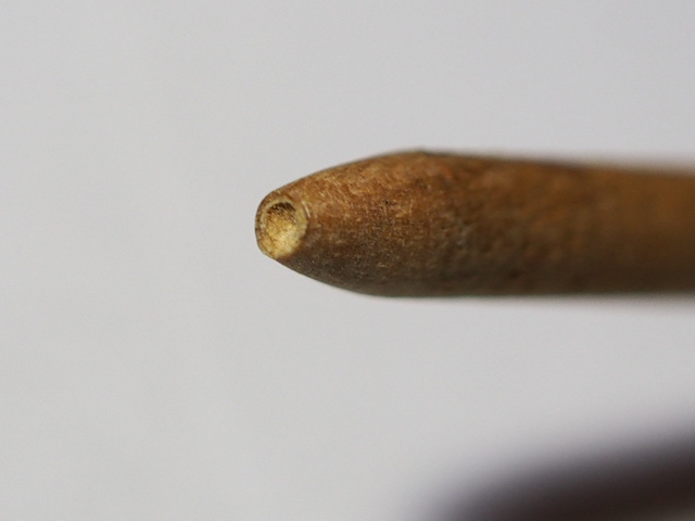

For the balance ones there is two methods, first the "tweezers only" one where you keep a thin finger of rodico over it and use the tweezers to put it in place. This methods require moderate manual skills, so I decided to document the other, which is even easier.
File a pegwood to the shape below. If you don't have pegwood, use a toothpick, brochette stick, or anything like that. The outer diameter must just go inside the jewel setting, then carve the inside with a 1mm drill bit.
The rest is intuitive. Note how the spring is very off-center before applying the stick, but the soft wood easily takes care of that.
And for the small ones in the train t's even simpler, don't bother removing them, wash the plate, oil the related pivots, and enjoy the good results.

I don't really think you can find a better finished mov.t at this price point, except possibly on some Seagull. I don't see anything wrong or ugly in the pressed posts.
