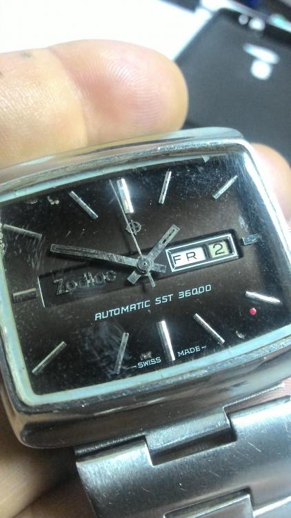

This Zodiac came my way and while its been over-polished, the price was right.
Inside we find a Zodiac cal.86.
Looking at the pictures, we have a puzzle. The dial is way larger than the movement so how does it come apart? Looking at the watch edge on, there's no visible seam so there appears to be no bezel to come off which will allow the dial/movement combo to come out thru the front.
Hmmmm..... let's take a closer look at the dial.
See it now?
The dial is actually a composite dial, the large square dial is fitted under the crystal, this has a large aperture thru which the 'Zodiac' brand and 'day/date window can be seen. This Zodiac brand and the day/date window is fitted to another dial which is fitted to the movement in the normal manner. To remove the movement you have to align the hands so that they will fit thru the large aperture in the square dial. The fact that this movement 'hacks' make it easier. You then remove the case screws and the movement drops out in the usual manner.
The date quick-set is not working. You can also see from the picture below the minute hand is slightly bent and the hands are generally not in good condition. The watch also looks a bit dirty as there seems to be some marks on the inside of the crystal at around the 7 o'clock area. I am loathe to remove the crystal as it seems to be an original one and I don't think it'll be easy to source a replacement.

I decided to give this watch a clean, the hi-beat movements work hard and the crystal was also bugging me as it did not seem to be 'flat' on both sides.
Well the crystal was sanded and polished, watch was dismantled and all was going fine until I tried to dismantle the 'do not dismantle'barrel. The lid came off easily enough but the arbor came away with the lid.. yep the mainspring broke.
So now I'm looking for a replacement mainspring but may need to buy a complete barrel.  Ricardo, thanks for the heads up on Sudarson. I dropped him an email !
Pretty bummed and I just left it all on my desk. Shit happens I guess.
Anilv
update... contacted ''oldswisswatches''/ Mr Sudarson, and he has the mainspring. Probably a generic as I believe these sealed barrels would be sold complete with m/spring and arbor. Fair enough at USD12. He also had a balance bridge for an FL1188 which was a bit steep at USD35 but I've been keeping my eye out for one (see below) and they seem to be a bit uncommon so I bit the bullet and bought it. Shipping was USD2 , given the abysmal postal service between India and Malaysia I expect it sometime in February!
