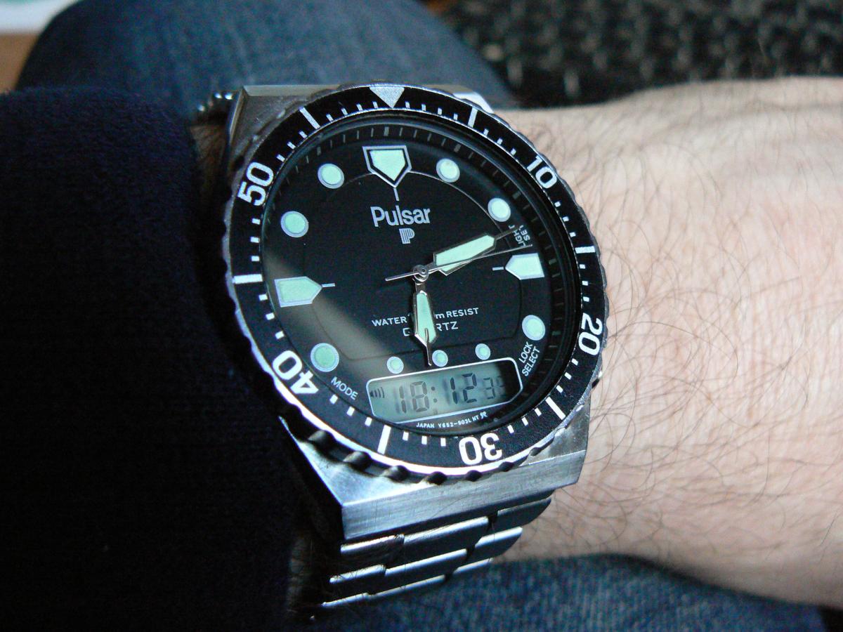

So I found myself wanting a Diver style watch that was nicer than the Pulsar, but not another auto. I found my next one on ebay. Pulsar Y652-9020. I fell in love with this and bid up higher than I initially intended, but still got it for a very reasonable price. It has a diver style dial, analogue and digital using the same movement as some Breitling Pluton and Chronosport. But being branded as Pulsar meant I could afford it. The only watch I have on a metal bracelet and I think it will stay on it. Again I don't wear this very often, for fear of damaging it at work.

The Analogue / digital display of the Y652 has really got me interested in others, the Arnie obviously, but perhaps the earlier Seiko H556.

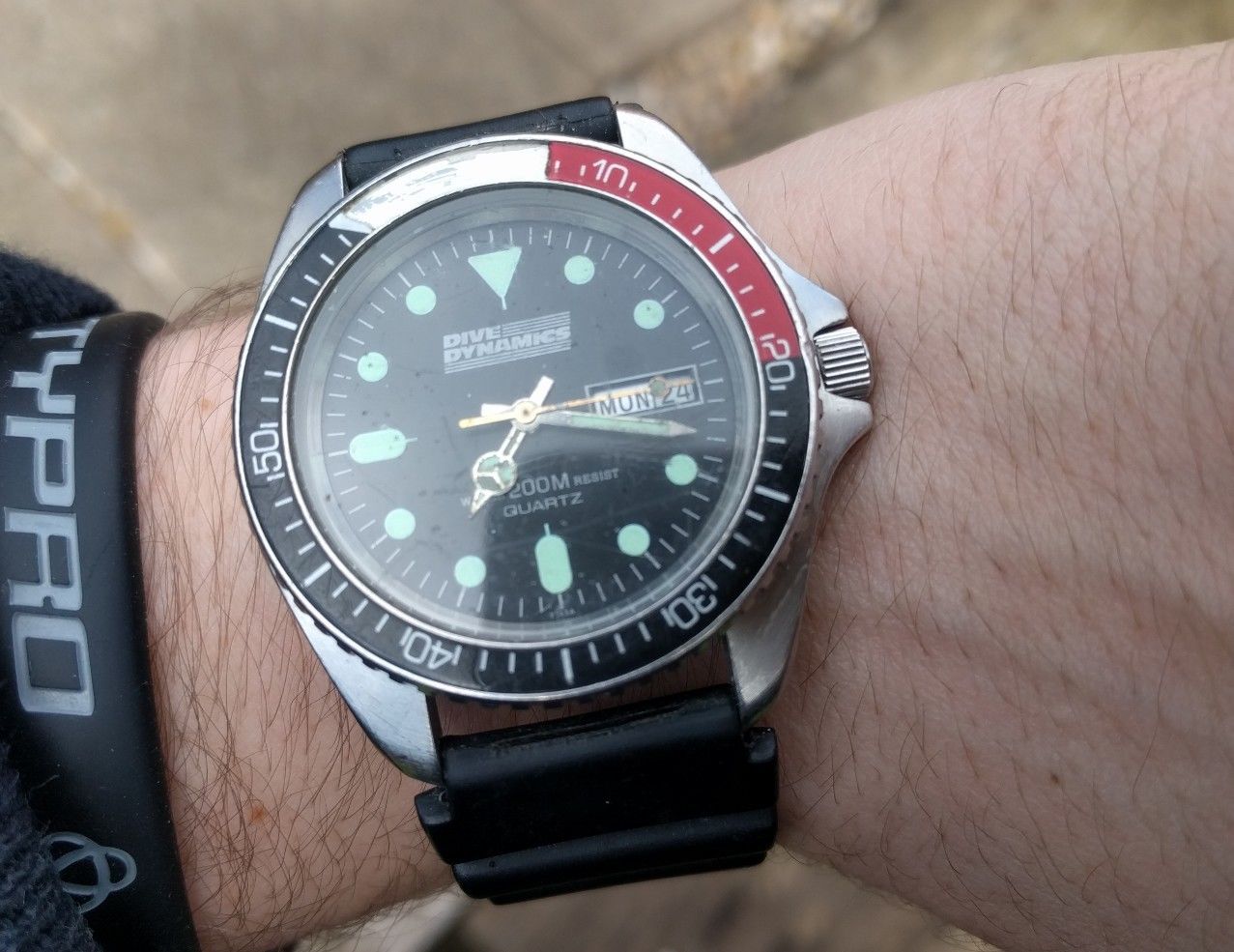

Just bought another 'generic' diver. Very similar to the Veteka branded one I posted above.
This is the slightly more common Dive Dynamics branded dial. But there are some similarities and differences. Firstly, this has the black PVD body, although a lot has worn off this one. The dial, hands, bezel and insert all look the same between the two watches. The Veteka has an ETA 955 movement. This Dive Dynamics has a Seiko (?) VX43. The dial also has this marked at the bottom. Yet when I did a bit of googling on these budget dive watches, most of what I read suggested that the Dive Dynamics ones also have the ETA movement. I would have assumed this had a replacement / downgrade to the VX43, but the fact the dial states it suggests there were several levels of watch sold. Also most Dive Dynamics pictures online show a polished body. And it looks like there were some others branded as Barracuda. Perhaps some more?
So quite an interesting little collection of watches out there. I love the look of them and am interested in seeing or getting more, so if anyone happens across one, please let me know. The fact they are so affordable and have been used as working dive watches appeals to me.
But on to this new one. It is in a right state. Apart from the worn off coating, the bezel insert has some wear. The glass is terrible, totally covered in little craters and pock marks. I doubt it'll polish out, so new glass to go in at some point. Bezel just about turns, but will need a clean at the very least. Inside is grubby. No battery tried yet. The crown does tighten, but doesn't move to it's setting positions very well. I think some of the visible gunk inside has made its way into the movement. I will try and give it a blow out. But the cost of the VX43 movements suggests I will just put in a new one. Or perhaps get another ETA 955 and put that in. Dial and hands look OK as far as I can tell through the glass. The (smelly) strap went in the bin!
So for the price of a cheap night out, I have acquired a little project do-err upper.
Took the back off the Dive Dynamics watch last night. Loads of gunk and miscellaneous 'stuff' all around the case, the stem and bezel. Took quite some scrubbing with a cotton bud and nail varnish remover, which I have found to be just the right amount of solvent on the outside of watches.
The movement didn't respond to a new battery. The stiff crown was mostly from the gunk around the body. So I think the movement is dead, but replacement is only about £6. Still not sure whether to spend another £20 and put in an ETA 955.
Then I took off the bezel. That was disgusting. It took lots of pressure to turn and you can see why. Brown and black sludge. Lots of cleaning and scraping and it has made the world of difference. It was really just an exploratory clean. The watch needs stripping and cleaning properly, but I just wanted to get to the movement and glass. The craters in the glass are very deep and no way it is salvageable, so will get one of those on order when I know what movement I am going for.
So in a way it was a bit disgusting to see the crap that was in and around this watch, but it is also reassuring that tool watches can and do get used and abused and all it takes is a few minutes with a cotton bud, cocktail stick and a few basic watch tools to get it (nearly) looking presentable again. Just a shame it's currently still a non-runner.

Just bought another Dive Dynamics diver from ebay. Under £20. Non runner. Needs a tidy up and new bezel insert. Probably needs a new movement, so this is another with the Hattori VX43. I was planning on putting another ETA 955 in these, but the hands have very slightly different hole sizes. Whether they do or not on these cheap watches is a different matter. They may just go on as they are. I'm going to get a couple of 955 movements to play with. I may even drop a Ronda 517 in, as I have seen one person has done just that already due to the price of the 955.
Now back to this one, it has a plain stainless body. My other Dive Dynamics and my Veteka (with the ETA movement) both have black PVD bodies and crown. So if nothing else, I can justify this to my wife as it is NOT the same as my others. And even though this one has the original strap, I am not a fan of that type, so it'll also end up on a Zulu strap. Not sure on colour.
It appears that there were other branded dials of the same watch. One was called Deep See (not a typo), Barracuda (which appear to pop up on American ebay from time to time) and Cardinal, which look like the Australian watch manufacturer of the same name may have done them. Some with PVD body, some plain. All seem to have the same red and black bezel insert and the same Monnin style case. A mixture of ETA 955.124 and VX43 movements both with day and date.
Hi,
this is former watch of french pilot,  very nice watch. Bravo
