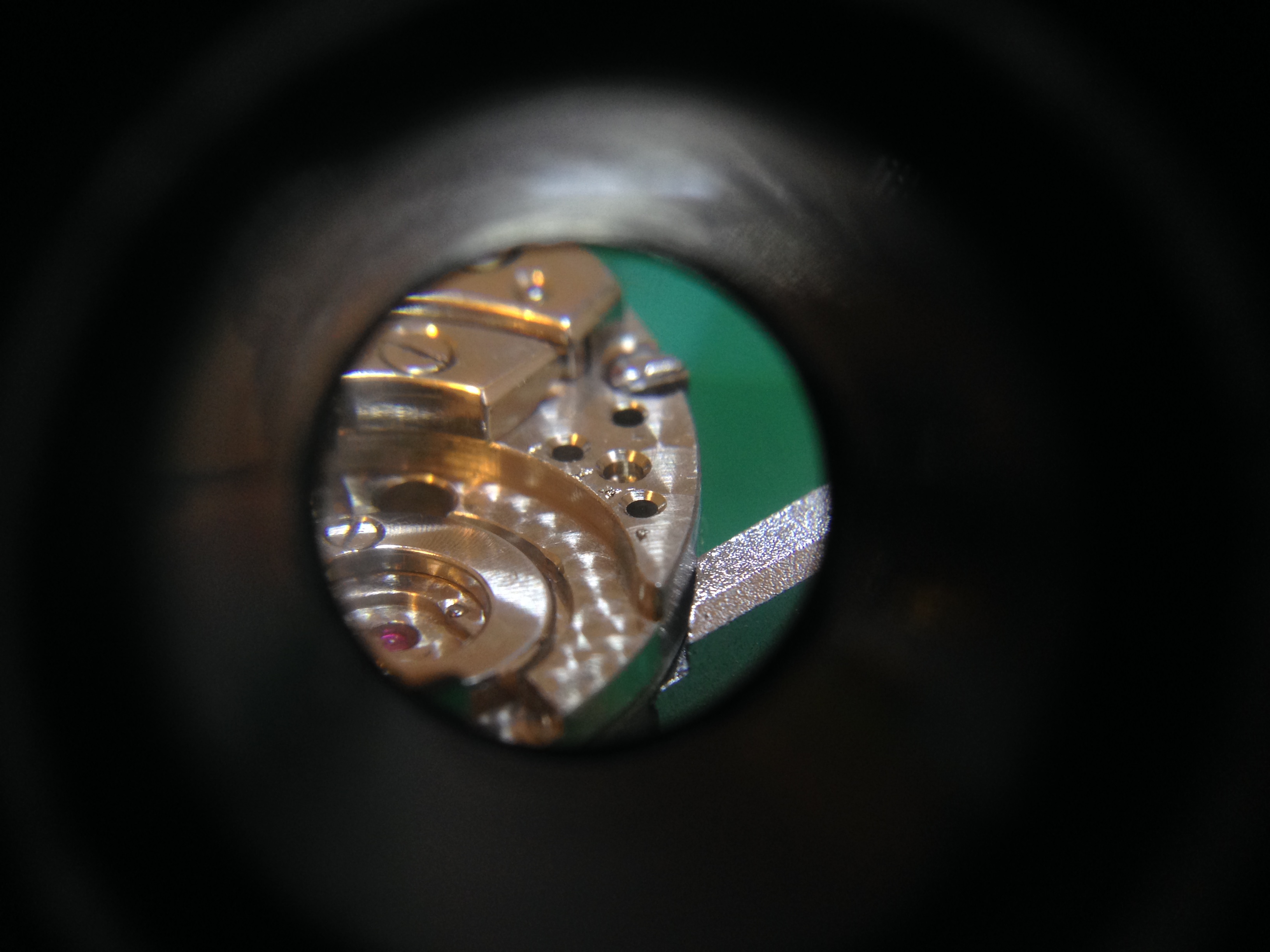

I'm working on a Jaeger LeCoultre Cal 450 just now that looks like this under the balance cock:
https://s32.postimg.org/ax5vxlv51/image.jpg
https://s32.postimg.org/ief3ctko5/image.jpg
https://s32.postimg.org/e6owht8md/image.jpg
https://s32.postimg.org/k8wj8ax2d/image.jpg
The staff is broken, so I've borrowed a Cal 449 (sub seconds version of 450) from a good movement.
With the good balance in the 450, there is serious end-shake. Should I attempt to flatten the punch marks (pigs ears)? I'm not sure by looking at them how much extra end-shake they would cause.
And how do I remove them? With an Arkansas stone maybe?
Thanks.
Edited by rodabod
Luckily mine were on the balance cock and not the main plate. I used a fine flat file and had no issues at all. My mating surfaces were not finished so a light touch up with some sandpaper to remove the file marks was all that was needed.
