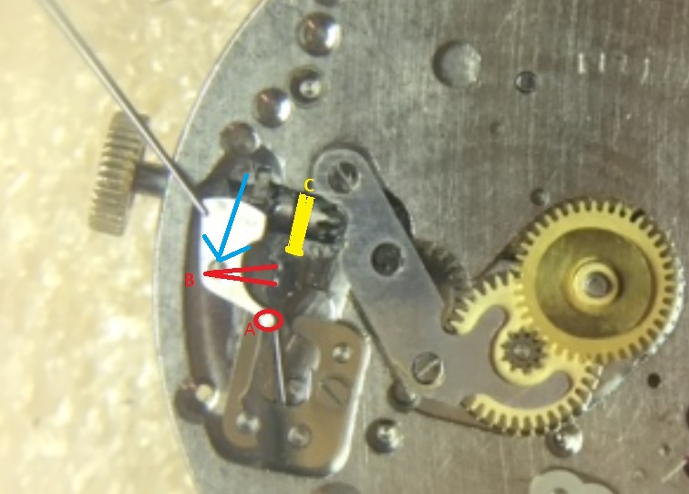

I have a problem with a Bulova pocket watch.  The watch was running, but losing a few minutes every day.  I opened the case to see if it was dirty or if there was an obvious reason for running slow.  I did not see any problems, but I took the stem out.  When I started to replace the stem a piece of the winding mechanism seemed to leap out of the movement and sail away.  I think it was propelled by a spring.  It took several hours, but I found the piece on the floor.
Now for the problem.  I cannot get the piece back in.  I have rotated it into several orientations and tried to find a peg to fit into the hole in the runaway piece, but after several days, I cannot get it to fit back into the watch.  In the pictures below you can see the piece oriented in a way that I think it should go.  An oiler is positioned to point at the troublesome piece.  In the other picture the piece is removed and you can see the springs that are supposed to hold the stem in place.  That piece no longer fits into the groove on the stem and so I cannot secure the stem.  The third picture is a picture of the dial of the watch.

Hi Bill,
The way I see it, the little post (A in red below, called the set-lever) needs to be under the 'set-lever spring' so that it rides in the two troughs (B in red). There seems to be a part missing, you would usually find the yoke fitted in the slot marked in yellow below,
The Blue arrow is the end of the screw from the other side.
I'm not too familiar with this movement but I think the part indicated by the yellow arrow below could be the yoke. Can it be moved so that it sits in the slot I mentioned earlier (red arrow below). The yoke spring (indicated by the green arrown below) will need to apply pressure on the yoke so that the winding pinion (red arrow thing) is pushed in the direction of the blue arrow. This will allow it to engage the clutch wheel (sorry no more arrows).Bulova 2.jpg
The set-lever piece (which your oiler is indicating) is usually installed first, followed by the yoke-lever and yoke spring. Then the set-lever spring/bridge (part indicated with the red B in the first pic above).

Also the set-lever may be flipped over. The post 'A' could be the stem retaining post. You may find another post on the reverse of the set-lever.

Refer my earlier post..second pic, yellow arrow. The yoke (outlined in red below) may have been flipped (ie the upper surface should be facing down). Once you've flipped it over, position it in the groove and then get the spring in. Caution, the spring will cause bits to fly so be prepared. If you're not confident then do the work inside a clear ziploc bag or similar. Your tweezers m screwdrivers will pierce the bag no problem and if anything flies it will fly inside the bag.
The reason the stem pulls out is the set-lever is not fully seated in the groove in the stem. You may want to get this right first before you proceed with the yoke as it keeps the stem, winding pinion and clutch wheel in place.
