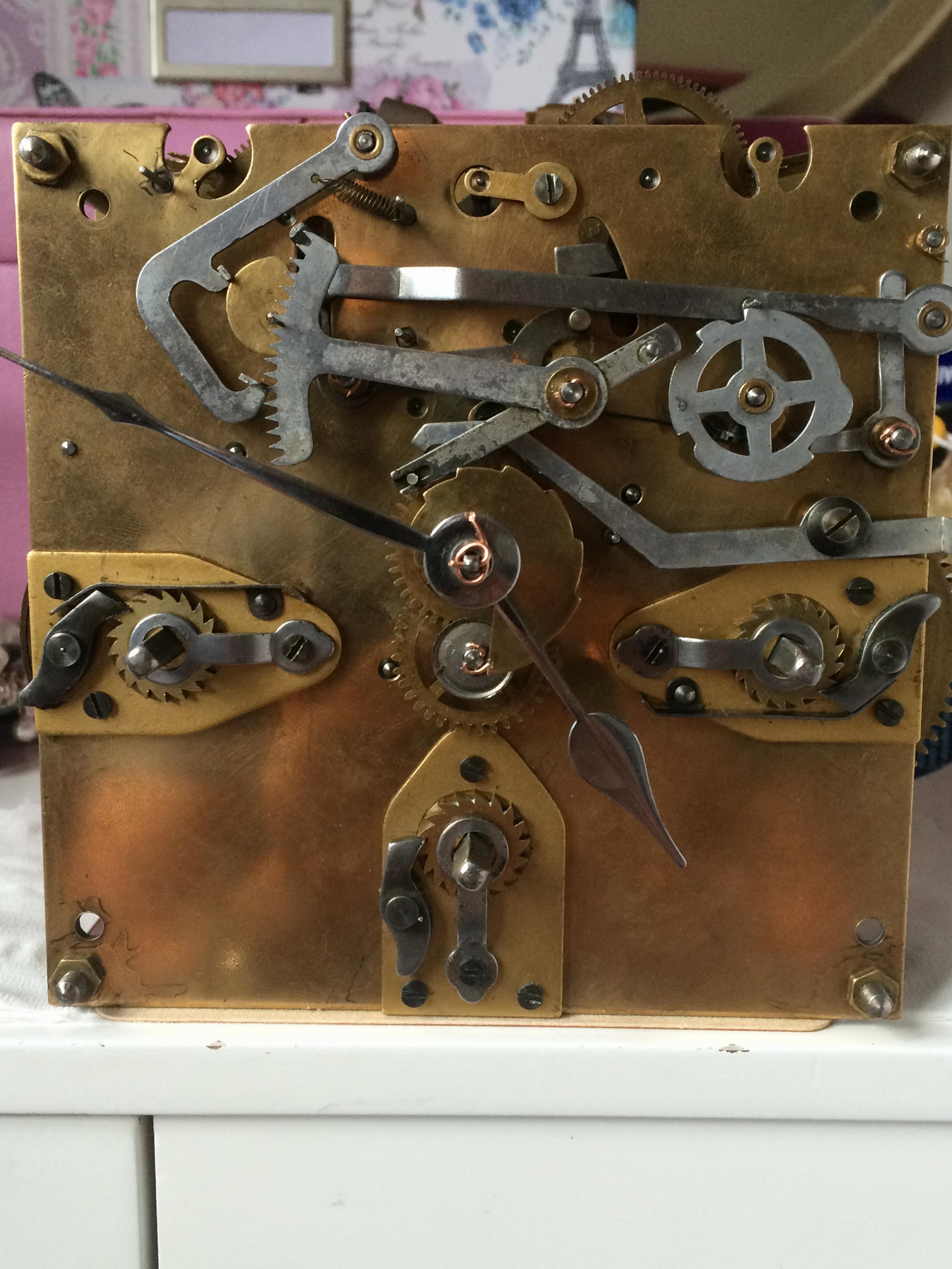

As for setting it up out the case that's easy as the case is 240 miles away from me! I have resembled the movement and yep you've guessed it I have absolutely no movement on either chime or strike trains, I need some help in what I need to do setting up wise if that's possible please. I reassembled it as per the photos that I took during disassembly but nothing is happening apart from the going train, thats running fine.
It certainly was a very dirty clock. I have not worked on a westminster smiths but I dare say the principles are the same. The snail wheel & cam set up in the centre is to regulate the chimes to the correct hours. The shortest step on the snail wheel is for 1 o,clock longest for 12 o,clock. I presume the wheel to the right is to regulate the quarters/half & hours. On many of the clocks I have worked on some of the wheels have pips/marks for alignment. These two parts need to be in the correct sequence with each other. If you have not any marks to guide you you will have to tinker to get it in sink. Old Hippy will be the guy to help for sure.

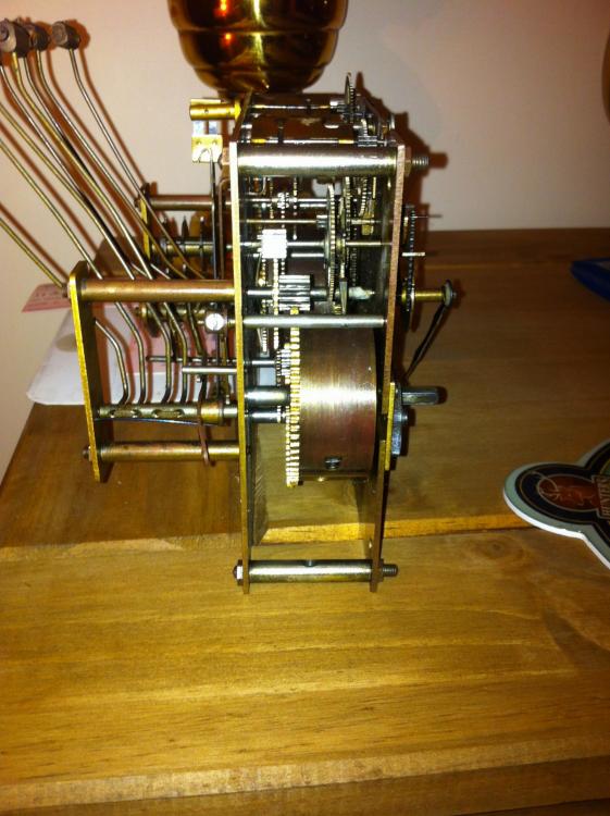

Here's a few of how it is now, it's running fine on the going train, keeping good time after a week of running. If you need anything else information/picture wise let me know ok cheers
What photo 2 is showing me is the chime and strike are both working at the same time which should not happen. If the chime is working the strike side should be locked and vice versa. On the chime train is a wheel with a slot on it and a lever drops down to stop the train from going, the locking plate should be in place and also locked, when it is locked the wheel with a pin next to the fly should be about a  quarter from the fly pinion away no more, this is called the warning this happens each time before the clock chimes and the hammers should never lift.  You will get tripping if these parts are not in the correct position. Make sure you have this right first.

Old hippy many thanks for the reply, I will see if any of what you have just typed makes any sense to me when I go and have a look at the movement, I do get the warning at 5 minutes to the hour but  nothing else on any other times it should chime.
How would I go about doing what what you have just said in practice please, this being my first clock experience (watches more my ground) cheers

The warning should happen just before every time the clock chimes. Move the minute hand slowly fore each quarter and tell me what happens, remember move the hand from its center not the tip as this could bend the hand or even snap it off. Behind  the locking plate and this is all one piece is a little grove that grove where it is the deepest should be in line with the chime train wheel with the slot in it.

The only thing you need to do is make sure the two wheels next to the fly wheels have there pins in the correct place and on the strike side the hammer lift is clear from the star wheel, meaning the star wheel makes one complete turn in that turn it lifts the hammer once and falls without lifting again.

One thing I will ask is a photo of the chime side of the movement as I can't remember what its like.
Cheers guys, although I'm taking in what you are both saying, I'm struggling a little to put names to parts and how to set them up correctly, old hippy, you said that both the chime and strike are working at the same time, at the moment all I get is a warning click and nothing else, neither of the chiming trains move at all.
I read on that PDF of click it's abit where the minute hand needs to be in line with the long cam of the centre cam, is the correct?
ill post a couple of pictures so hopefully you can both tell me what position wheels need to be in and their respective names etc etc, I won't have much time today on it as I spent all day yesterday tinkering on watches so wifey gets me today, but will be looking at it next week.
all these pictures are from before the strip, will put after strip ones up next
