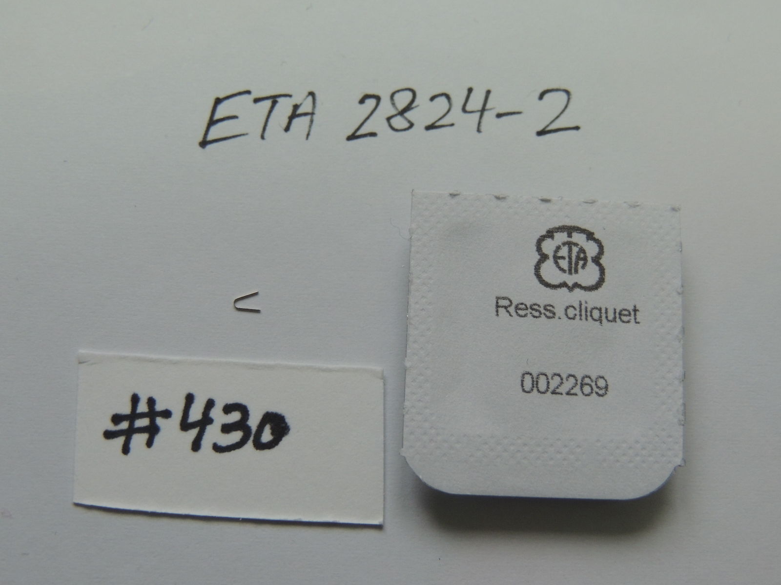

I examined the spring with more magnification and it appears it has gotten twisted on one side which makes it impossible for it to work. I need to order some other things so I'll just buy a couple of them - an heir and a spare.

This is a 2824-2 i just started with . Took a picture of the clickspring. Looks like both are the same length? Zoom in by clicking on the picture. DSC06066.JPG
