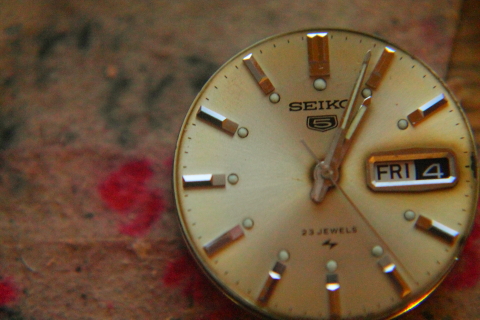

i got this on fleabay a couple of weeks ago. the seller took a horrible picture of the watch, but i thought that the dial might be nice. and the movement number was barely legible - 5126 with 23 jewels. i think they were only made for three years - from 1968 to 1970. this one does not run at all. but the dial is in great shape overall, slightly discolored around the date window and the center hole. it won't clean off - the paint is discolored. i'm not worried about it because it just adds to the patina. the date on this one is june 1968.
